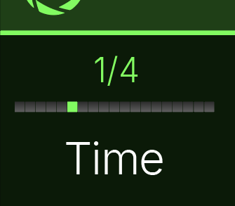

  2. Press a Time, Speed, or Rate parameter knob to toggle between ms or Hz (below left) and note values (below right).
Time set to ms
Time set to note value

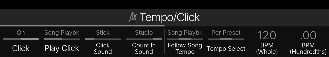

Tempo Panel
Touch (but don’t press) FS12 (TAP/Tuner). The Tempo/Click panel briefly appears:
Tempo/Click panel
Click here to show Global Settings > Tempo/Click settings...
Click
Turns the click (metronome) on and off.
Play Click*
Determines when the click (metronome) is heard.
  • Song Playbk: The click (when on) is only heard during song playback.
  • Always: The click (when on) is always heard.
Click Sound
Selects the type of Click sound.
Count In Sound*
Selects the type of sound used for the Count In, which is heard before the start of a song and/or marker.
Follow Song Tempo*
Determines if and when time-based blocks (like Delays and Mods) follow the current song’s tempo.
  • Never: Time-based blocks completely ignore song tempo.
  • Song Playbk: Time-based blocks only follow the current song tempo while the song is playing.
  • Always: Time-based blocks always follow the current song tempo, even when the song is not playing.
Tempo Select
Determines whether the system tempo is stored and recalled with each snapshot, recalled with each preset, or applied globally across all presets and snapshots.
BPM [Whole]
Sets the system tempo. Turning Knob 7 (BPM [Whole]) resets Knob 8 (BPM [Hundredths]) to .00.
BPM [Hundredths]
Receive MIDI Clock
Determines whether Stadium responds to the incoming MIDI Clock received at its MIDI IN port, via USB, or whichever it senses first (“Auto”). If you want Stadium to completely ignore MIDI clock, set this to “Off.”
The TAP switch LED flashes blue when synced to incoming MIDI Clock.
Send MIDI Clock
Determines from which outputs (if any) Helix Stadium transmits MIDI Clock.

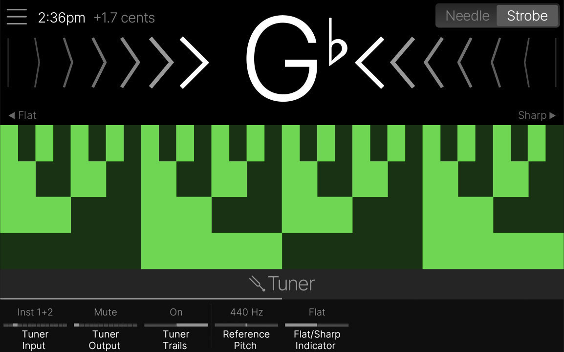

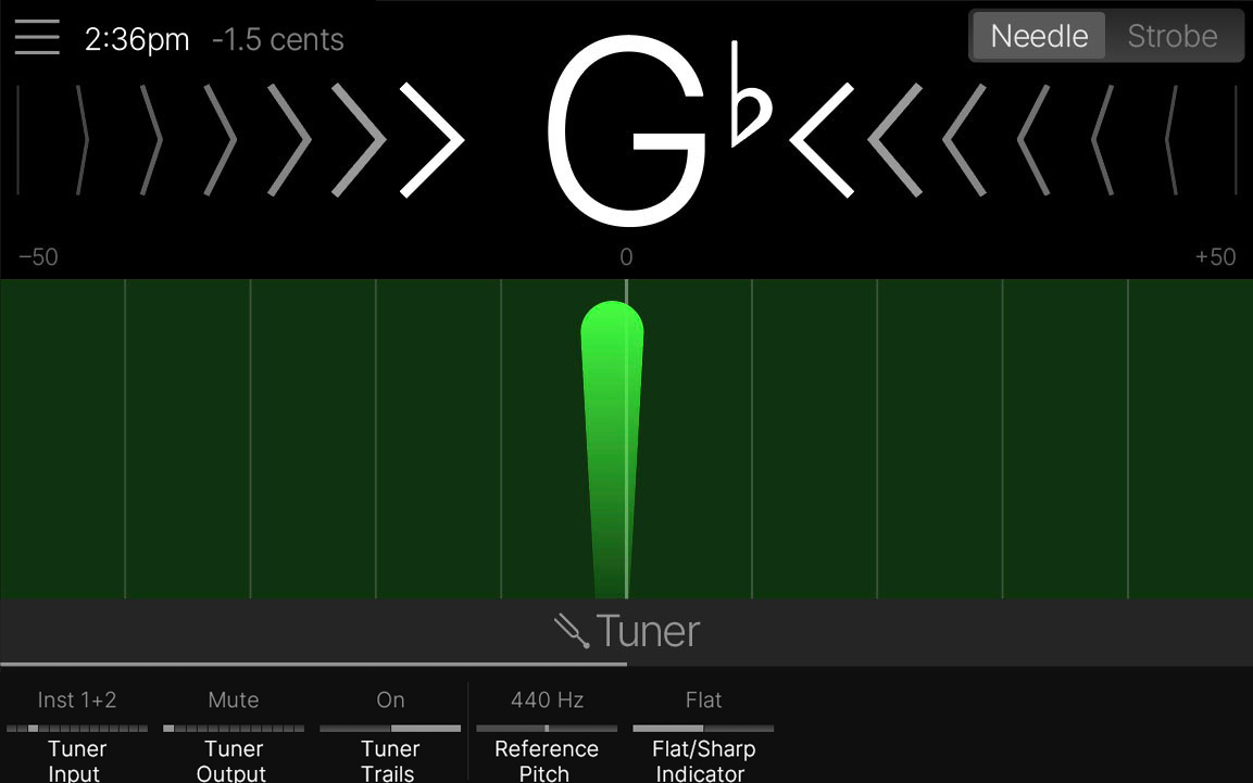

  1. Press and hold FS12 (TAP/Tuner) until the tuner screen appears.
  2. Tap the desired tuner mode:
    • The Tuner Needle Button Needle: A vertical needle moves left (flat) or right (sharp) to indicate the pitch of your instrument. The needle, flat/sharp arrow indicators, and background change colors to show how far the string is from the target pitch. The display offers a range of ±50 cents. When the needle centers and the background lights green, your string is in tune.
    • The Tuner Strobe Button Strobe: A checkered background moves left (flat) or right (sharp) to indicate the pitch of your source instrument. The strobe background changes colors to indicate how far the string is from the target pitch. When the strobe background stops moving, your string is in tune.
    • The Cents indicator at the top left of the screen provides a real-time, numerical measurement of your string's pitch relative to the target pitch.
Tuner > Needle mode
Tuner > Strobe mode

Click to show Tuner settings...
