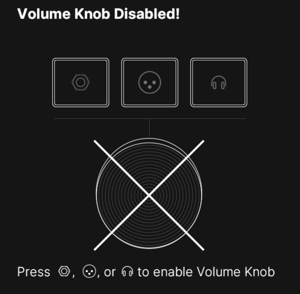

Worried that someone (or your guitar cable) might bump the Volume knob mid-show? Stop taping it down! Volume knob control can be quickly disabled.
  1. Press and hold the currently lit output button(s) to completely disable Volume knob control. Turning the Volume knob while it's disabled displays an alert (see below).
  2. Press any output button to re-enable the Volume knob.
Volume Knob Disabled dialog

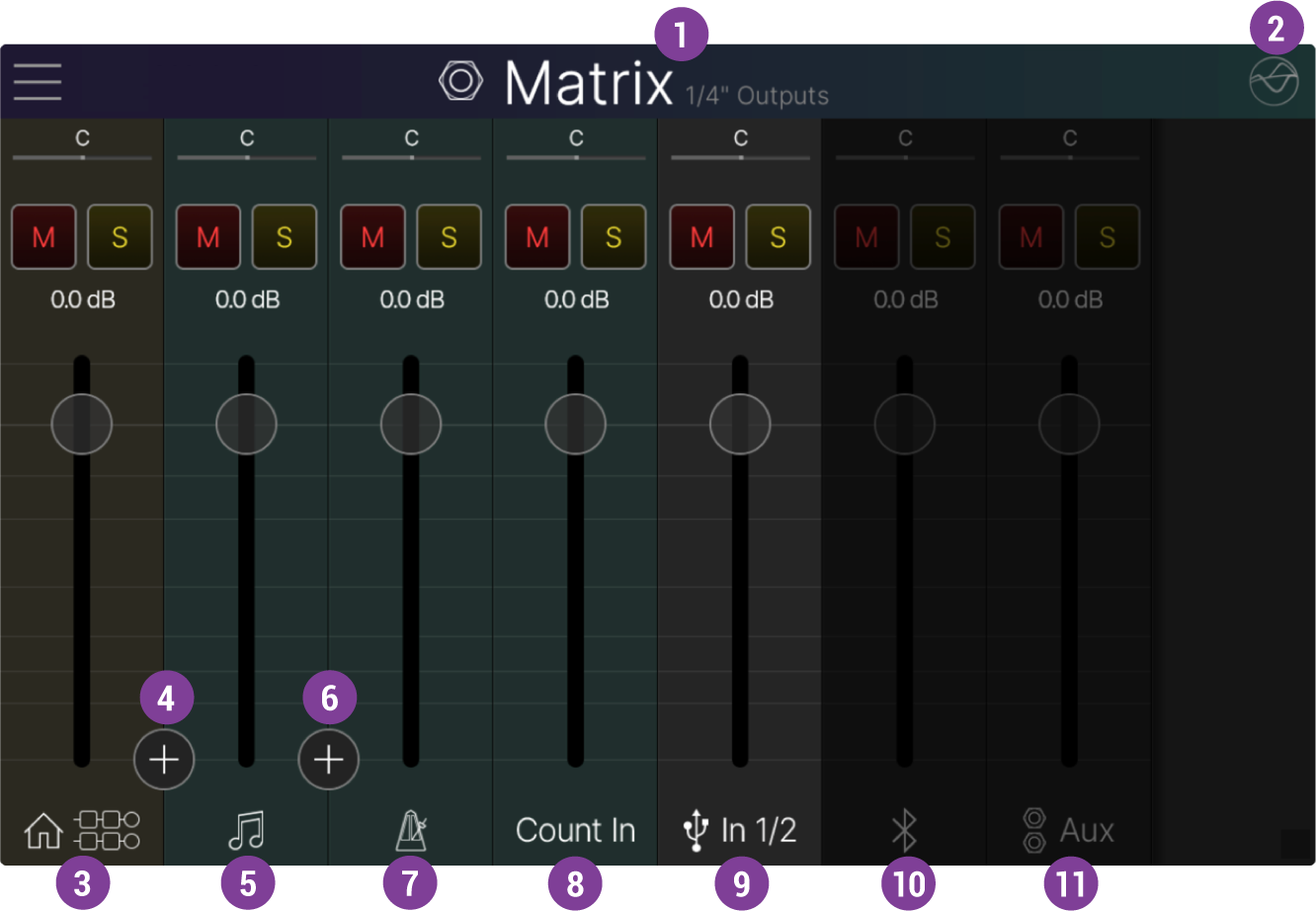

The Matrix Mixer lets you quickly mix the numerous signals going through Helix Stadium. What’s more, the 1/4”, XLR, and Phones outputs get their own Matrix layer so you can send a completely different monitor mix to, say, the 1/4” outputs feeding your on-stage playback system, the XLR outputs feeding the Front of House console, and the Phones output feeding your In Ear Monitors or drummer. Each Matrix layer provides level, pan, mute and solo control over the 4 stereo paths on the Home > Edit screen, 8 stereo tracks on the Song screen, Click, Count In, USB In 1/2 (for monitoring your DAW), Bluetooth audio (for jamming along with Apple Music, Spotify, or YouTube), and Aux In. (Aux In is unavailable unless Global Settings > Ins/Outs > Return 1/2 Type is set to Aux In.) Each Matrix output gets its own Global EQ as well.
Further, you can “link” the Stadium outputs so that any two—or all three—outputs are controlled from the same Matrix Mixer layer and main Volume knob. See Linking Outputs below for details.
  1. Press the lit 1/4” Quarter Inch Out button , XLR XLR Out button , or Phones Headphones Out button output button to open that output’s Matrix Mixer.
  2. To view the Matrix Mixer for a different output, press that output button.
The Matrix Mixer (1/4” outputs selected)
Item 01 Matrix Mixer Layer: The current Matrix layer is indicated at the top of the screen (1/4” Outputs, XLR Outputs, Phones Output, or multiple outputs when two or more are linked).
Item 2 Global EQ Shortcut: Tap to open the Global EQ for the selected Matrix layer. Each Matrix output (1/4”, XLR, and Phones) gets its own Global EQ, regardless of whether any of them are linked. See Global EQ for details.
For All Matrix Mixer Channel Strips:
Adjusting the Matrix Mixer’s controls determines the mix heard from the selected output (1/4”, XLR, Phones, or linked outputs).
  • Tap and drag a channel strip’s vertical Fader Channel strip fader handle , or turn Knob 1~8 beneath the respective fader to adjust its level. Press the Knob 1~8 to reset the fader to 0.0 dB.
  • Tap a channel’s Pan slider Channel strip Pan slider to open the Pan panel and drag to adjust its Left/Right stereo balance.
  • Tap the Mute button Mute button to mute the channel. Tap again to un-mute the channel.
  • Tap the Solo button Solo button to mute all other non-solo-enabled channels. Tap again to un-solo the channel. (Note that the currently lit Output button flashes when any channels are solo-enabled, serving as an indicator when you’re in other screens.)
    • Tap the Solo buttons of multiple channels to add them to the solo bus.
    • Tap-hold any enabled Solo button to clear all solos.

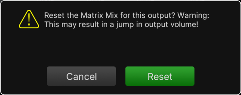

  • Tap-hold on the “Matrix” title at the top of the screen to reset all the current Matrix Mixer’s controls to their initial defaults (Level to 0.0 dB, Pan to Center, and Mute and Solo to off). The following dialog appears, warning you that things could get loud (since some of your channel levels might currently be set significantly lower than the default 0.0 dB). Tap Reset.
Matrix Reset warning

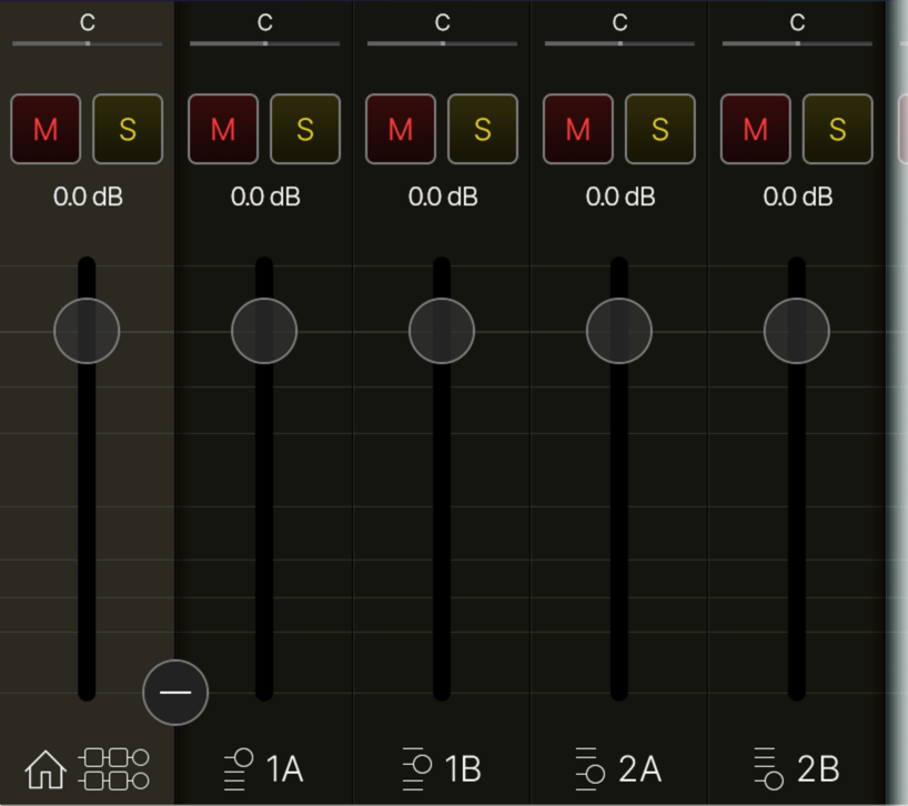

Item 3 Home Channel: Use this channel’s controls to adjust the combined signal of all four Home > Edit paths.
Item 4 Home Paths Show/Hide: Tap the The expand button button to expand the Home channel to show its four individual path channels (1A, 1B, 2A, and 2B). Use these channels to adjust each path independently. Tap the The hide button button to hide the individual path channels.
Matrix Mixer with the Home channel expanded
The Matrix Mixer with the Home channel expanded
Item 5 Song Channel: Reserved for future functionality.*
Item 6 Song Tracks Show/Hide: Reserved for future functionality.*
*Note: Song features are still in development and will be available in a future firmware update for Helix Stadium devices. For the latest details, please visit the Line 6 website’s Helix Stadium product page.
Item 7 Click Channel: Use to adjust the Metronome’s Click.
Item 8 Count In Channel: Reserved for future functionality.*
Item 9 USB In 1/2 Channel: Use to adjust the audio USB 1/2 monitor signal (for monitoring your DAW when Helix Stadium is operating as your computer’s audio interface).
Item 10 Bluetooth Audio Channel: Use to adjust the playback signal from a paired Bluetooth® audio device, for jamming along with Apple Music, Spotify, YouTube, etc. The Bluetooth Audio channel is grayed out unless a Bluetooth audio device is currently paired. See Bluetooth Connectivity for details.
Item 11 Aux Channel: Use to adjust the signal from the rear panel Aux L/R input (Helix Stadium’s Return 1/2 or Helix Stadium XL devices only Helix Stadium XL’s Return 3/4) for receiving a monitor feed from the Front of House console or connecting a drum machine, mixer, etc. The Aux channel is grayed unless the Global Settings > Ins/Outs > Return Type is set to Return 3/4; to enable it, set Return Type to Aux.

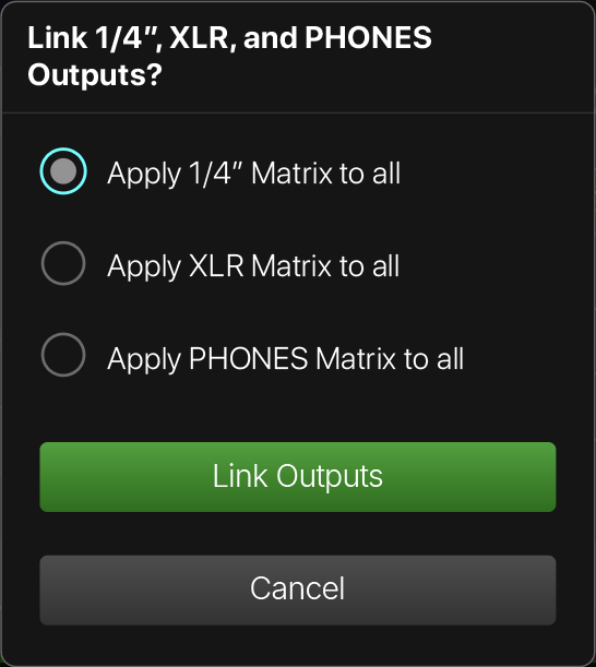

  1. Press and hold two (or all three) output buttons for 2 seconds. A dialog appears, asking which output’s Matrix layer you want as the reference (see below).
  2. Choose the desired output reference and then tap Link Outputs. To unlink outputs, press and hold the linked output buttons again.
Link Outputs dialog
