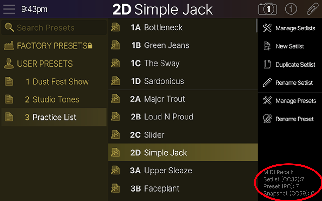

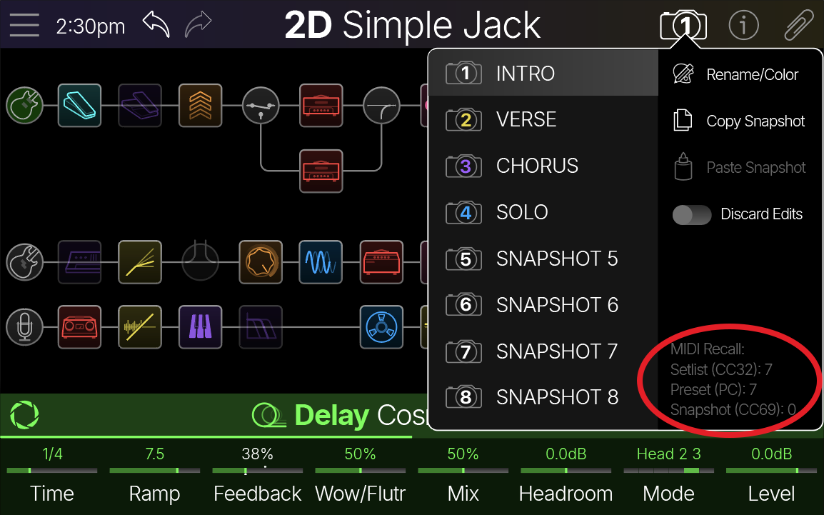

  1. From the Home > Edit screen, tap the Preset name in the header to open the Preset List (below left). Alternatively, tap the Snapshot icon to open the snapshot panel (below right). The small text in the sidebar displays the required MIDI messages for recalling the current preset and snapshot from external MIDI devices or software. In the illustrations below:
    • The 3 Practice List setlist is recalled with a CC32 (bank select) message of 7
    • The 2D Simple Jack preset is recalled with a PC (program change) message of 7
    • The 1—INTRO snapshot is recalled with a CC69 message of 0
MIDI Recall CC/PC values in the Preset List
MIDI Recall CC/PC values in the Snapshot panel
In most cases, you do NOT need to send a CC32 message every time you recall a preset—just send the PC message. The exceptions are if you want to select a preset in a different folder or setlist—or, in the case of the USER PRESETS folder (as it contains 512 preset locations), if you want to select a preset in a different group of 128 presets. In this case, send the folder/group/setlist’s CC32 message first, followed by the preset’s PC message.
Snapshots work in a similar way. To change snapshots in the same preset, just send the corresponding CC69 value (0 for Snapshot 1, 1 for Snapshot 2, 2 for Snapshot 3, etc.)—no need to send CC32 or PC messages.
