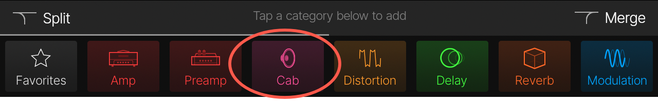

You can also add a Cab block manually:
  1. From the Home screen, tap an empty location on a path. Block categories appear in the inspector.

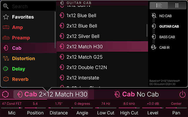

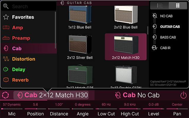

  1. Tap the Cab button to open the Model List. Tap the list view button List-Gallery Selector to choose to view more items in a condensed list (below left) or fewer items as large images in a grid (below right).
The Model browser,Cab category selected, List View
Model List > List view
The Model browser,Cab category selected, Gallery View
Model List > Grid view
  1. Swipe the list up or down (or turn the Lower Knob) to find the desired item.
    • Tap NO CAB, GUITAR CAB, BASS CAB, or CAB IR in the sidebar to quickly scroll the list up or down to that subcategory.
  2. Tap to select the item and press Home Home button (or tap the Inspector header) to close the Model List. Alternatively, double-tap to select the item and close the Model List.

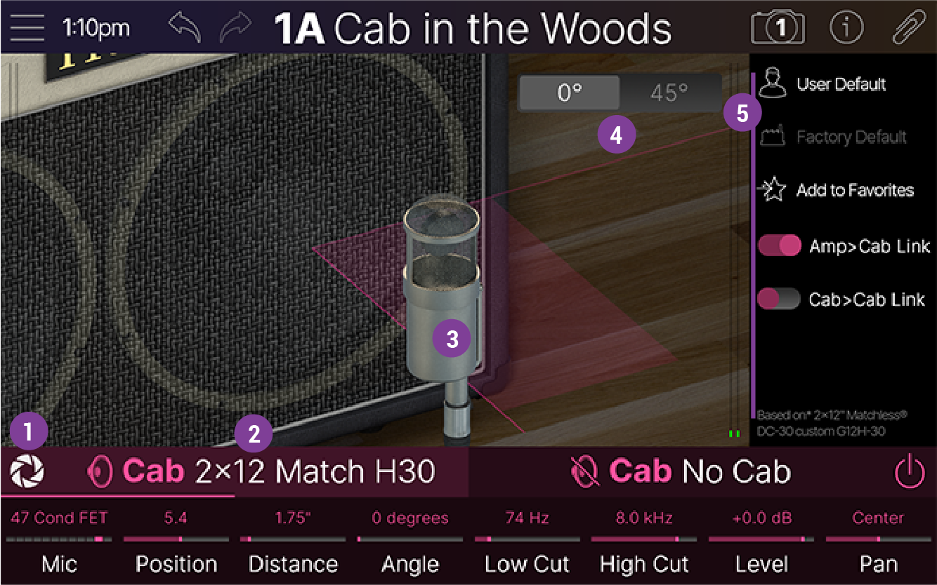

Cab > Focus View
When a Cab block is selected on the Home > Edit screen, tap the Focus icon The Cab Focus button in the Inspector to open Focus view. Tap and drag the Mic to set its Position and Distance relative to the Cab speaker, just as you would in the studio. Tap the 0°/45° toggle to set the Angle. These parameters, along with all other Cab parameters, can also be adjusted within the Inspector at the bottom of the screen.

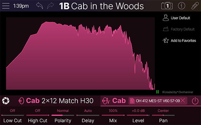

When a Cab IR is selected, Focus view shows a static frequency plot if the IR file for reference, along with User Default, Factory Default, and Add to Favorites sidebar options, as described below. Please see the Cab IRs section below for more about using IRs.
The Cab block Focus View, Cab Model selected
The Cab model’s Focus view
The Focus View showing a Cab IR
The Cab IR’s Focus View
Item 01 Focus: While Focus view is shown, the icon appears white FocusButtonWhite.png . Tap to exit Focus view.
Item 2 Cab or Cab IR: Since a Cab block offers two tabbed slots, tap the desired slot to view its parameters. Loading a Cab IR is slightly different than loading a Cab—please see the following section on Cab IRs.
Item 3 Mic: Tap and drag the mic to adjust the Position and Distance parameters.
Item 4 Angle: Tap to set the preferred mic angle—0° or 45°
Item 5 Sidebar: Several additional options are available here for the selected Cab model/Cab IR.

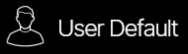

  • User Default: If you find yourself constantly re-tweaking your commonly-used Cabs the same way, Tap User Default User Default command to save the Cab’s settings as its new defaults, so it always shows up the way you want. See Creating User Defaults.
  • Factory Default: If you’ve stored User Default settings for the selected Cab model or Cab IR, tap Factory Default Factory Default command to return it to its original default settings for all future uses.
  • Add to Favorites: Once a Cab block is configured to your liking, add it as a Favorite to easily recall it for future presets. See Adding a Favorite.
  • Amp>Cab Link: Amp-CabLinkSwitch.png By default, changing an Amp model will automatically recall a “matched” cab for the left tab of its linked Cab block. When an Amp and Cab block are linked, selecting one of them will display a gold link icon (see below). When off, changing Amp models does not affect the Cab block.
“Linked” Amp and Cab blocks
  • Amp>Cab Link is only active when you add the Amp & Cab with the Amp Model List’s Add Cab Block toggle.
    • The Cab block’s right tab Cab model remains unchanged when Amp>Cab Link is enabled unless you also have Cab>Cab Link enabled (see the next item).
  • Cab>Cab Link: Tap Cab-CabLinkSwitch.png on to link both sides of a Cab block. When on, changing the left cab automatically loads the same cab on the right. This can be helpful when you want the same cab but different mics, or the same cab and mic but different mic positions or distances.*
    • Changing the right Cab does not affect the left Cab.

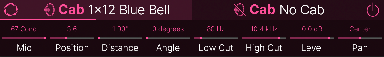

Cab Parameters
Cab parameters in the inspector (left cab selected)
Tip: Cab blocks offer a lot of choices and possible speaker and mic combinations. Once you’ve edited and configured a Cab block exactly how you like, it is a good idea to add it as a Favorite so you can easily use it for future presets. See Adding a Favorite.
Tip: Tap any Cab parameter in the Inspector to open its Parameter Panel, where you’ll find a handy description.
Note: The following is the list of parameters offered when a Cab Model is selected. Cab IRs offer their own set of parameters—see the Cab IR Parameters section.
Cab Parameter
Bypass
Tap CabBypassButton.png in the inspector to turn the block on and off, independent of any footswitch assignment.
Note: A Cab block’s Bypass is not automatically assigned to a Stomp mode footswitch. But you can manually assign any Cab block by selecting the block within the signal flow, touching a Stomp mode footswitch, and tapping Assign Block when prompted.
Mic
Selects the mic pointed at the cabinet. (Guitar and Bass cabs have different sets of mics available; see Cab Mics.) Mic selection can have as big an impact on your tone as tweaking the Amp’s tonestack or even applying an EQ block, so experimentation is key here.
Position
Sets the lateral location of the mic in relation to the speaker cone, from the center of the speaker to the edge. The “Cab Edge” value may appear in a different location depending on the selected cab.
Distance
Sets the distance of the mic from the speaker. Choose from 1.00” to 12.00” in 1/4” increments.
Angle
Sets the angle of the mic relative to the front of the speaker cabinet. 0 degrees is pointing directly at the speaker; 45 degrees is pointing off-axis.
Low Cut
Applies a low cut (high pass) filter, letting you remove all audio below a certain frequency. May be useful in removing undesirable low end rumble.
High Cut
Applies a high cut (low pass) filter, letting you remove all audio above a certain frequency. May be useful in removing high end harshness.
Sets the overall level of the Cab. Use to adjust level against the other side of the Cab block.
Pan
Controls the panning of the Cab between the left and right channels. For stereo setups, the Cab block can sound much wider if the two sides are panned opposite of one another (“Left 100” and “Right 100”).
Note: It is best to keep this set to Center when using a single Cab or when mono output is desired.
Delay
Delays the signal slightly to purposely impart a bit of phase incoherence or at higher values, increase the Cab block’s apparent stereo width (or at extreme values, a bit of doubling effect). A little goes a long way here. When set to “Auto” (all the way left, before 0.0 ms), it approximates the delay through the air when changing the mic Distance parameter. For most use cases, however, we recommend leaving Delay set to “0.0 ms.”

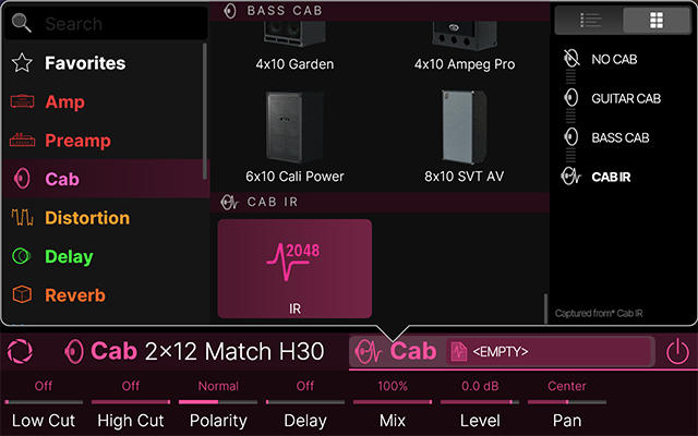

Loading an IR within a Cab Block
Once you’ve imported IRs into Helix Stadium, you can select, audition, and load an IR within the Model List.
  1. With a Cab block selected, tap the left or right side of the Inspector header to open the Model List (also see the next section).
  2. Tap Cab IR Cab IR Sidebar in the sidebar to scroll to the bottom of the list, then tap on 2048 IR IRSelect.png (below left).
  3. Tap on the pink <EMPTY> box to open the USER CAB IRs file browser. Navigate the browser to find the IR you want and tap to audition it (below right). Double-tap an IR in the list to load it and close the Model List.

The Model Browser showing the Cab IR category
Model List > Cab > IR

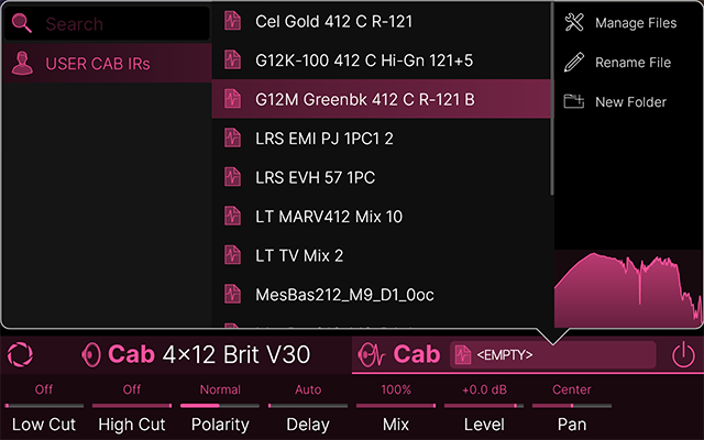

The User Cab IR list
Selecting an IR file from the User Cab IR list

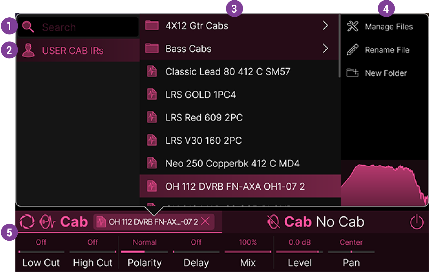

The USER CAB IR Browser
The Cab IR File List offers the following options
Item 01 Search Field: Tap to type a search term in this field to filter the list of IRs.
Item 2 User Cab IRs Folder: Tap on this folder in the left column to display the list of all your imported User Cab IR files within the middle column.
Item 3 Cab IR list: Once IR files have been imported into Helix Stadium, the middle column shows your library of User Cab IRs.
Item 4 Sidebar: Allows you to manage your IR files.
Manage Files: Tap ManageFildesCommand.png to show a list of options within the sidebar to manage the IR files. Check the box to select one or more IRs to apply the sidebar Copy or Move to Folder commands.
The Manage IRs option is selected, allowing IRs or subfolders to be checked
  • Select All: “Checks” all IRs in the list.
  • Deselect All: “Unchecks” all checked IRs in the list.
  • Copy Files: Copies all checked IR files to the clipboard, letting you copy one or more User IRs and then paste them into a different folder or subfolder.
  • Paste Files: Pastes the clipboard contents into the currently selected folder or subfolder.
  • Move to Folder: Allows you to select one or more IRs and move them from their current list location into a selected subfolder.
  • Delete Files: Permanently clears the selected User IR(s) from Helix Stadium.*
*Important! Deleting an IR file from the IR Library that is used within any saved preset will result in the preset’s Cab block changing to “UNRESOLVED,” with no IR loaded in the respective tab. Tap the UNRESOLVED tab and choose a new IR or Cab model, then save the preset to retain your change.
Make sure to keep backup copies of all your purchased IR files before deleting them from Helix Stadium!
Rename File/Rename Folder: Tap RenameFileCommand.png to rename the current IR file or subfolder with your own custom name.
New Folder: Tap NewFolderCommand.png to create and name a new empty subfolder. Use the Manage Files functions to copy or move IRs into the subfolders you create.
Item 5 Inspector: Displays two Cab tabs and parameters for the selected tab.
  • Cab/IR Tabs: A Cab block always lets you load two Cabs or two Cab IRs (or one of each). In the image above, the left tab has the Cab IR “LRS GOLD 1PC4” loaded, and the right tab is empty (No Cab).
  • Focus Icon: Tap to open Focus view. Tap and drag the Mic to set its Position and Distance relative to the Cab speaker, just as you would in the studio. Tap the 0°/45° toggle to set the Angle. See Focus View.
