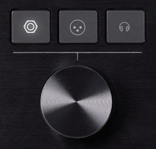

The Stadium device output selectors and volume knob
Output buttons and Volume knob
Caution - It might get loud! Always turn the Volume for the respective output(s) counterclockwise to minimum before making connections to external gear and headphones to avoid encountering loud bursts of audio 🤯 . Exposure to high volume levels can potentially cause hearing damage or harm to your equipment.
Press the 1/4” Quarter Inch Out button , XLR XLR Out button , or Phones Headphones Out button output button to select which output you want to control, and then turn the large Volume knob Volume knob fully counterclockwise to set that output’s volume to minimum. If you’re connecting to more than one of the Stadium 1/4”, XLR, or Phones outputs, repeat the process to turn the volume down for each. Press the lit output button(s) to display the Matrix Mixer and access individual channel volume faders via the touchscreen.
Tip: Wish you could control multiple Matrix outputs at once without having to switch back and forth? Press and hold two—or all three—output buttons together for 2 seconds to open a “Link outputs” dialog. Tap Link Outputs in the dialog, then turn the large Volume knob fully counterclockwise to simultaneously minimize the volume level for the linked outputs. Press and hold the linked output buttons to unlink them again.
To lock the Volume knob’s level Volume knob so no one can mess with it (say, your guitar cable keeps rubbing against it during a gig), press and hold the lit output button for 2 seconds. To enable the Volume knob again, press any output button.

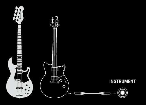

02.png Connect Your Instrument
Use an instrument cable to connect to Helix Stadium XL’s rear panel 1/4” Instrument 1 jack, or Helix Stadium’s 1/4” Instrument jack.*
*Note: The Helix Stadium XL icon. Helix Stadium XL devices offer two 1/4” instrument jacks (Instrument 1 and Instrument 2)—for this setup, connect to Instrument 1, since it is the default input for all Stadium XL presets. Helix Stadium offers a single 1/4” Instrument jack, which is the default input for all Stadium presets.
Instrument Input

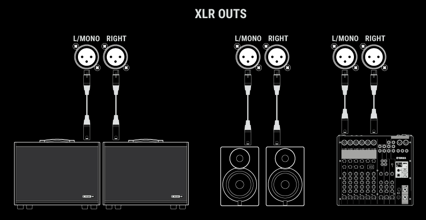

  • XLR Outputs: Use XLR audio cables to connect directly to the XLR inputs of powered modeling amplifiers (such as Line 6® Powercab® Family amplifiers), powered PA/FRFR monitors, a mixing console, or studio monitors. When running into a single amplifier or speaker, connect only the L/MONO XLR output jack; Helix Stadium automatically mixes the left and right outputs for mono operation.
Connecting Stadium’s XLR Outs to external monitoring gear

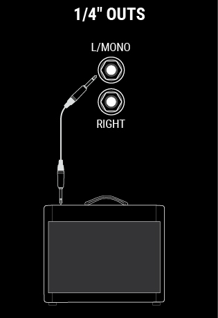

  • 1/4” Outputs: Use shielded, unbalanced (tip-sleeve) 1/4” cables to connect to one or two instrument amplifiers—or—shielded, balanced (tip-ring-sleeve) 1/4” cables to connect to studio monitors or powered PA/FRFR speakers; you may also use 1/4” TRS to XLR M cables. When running into a single amplifier or speaker, connect only the L/MONO 1/4” output jack; Helix Stadium automatically mixes the left and right outputs for mono operation.

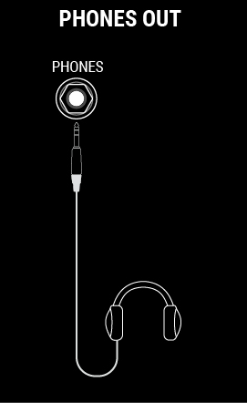

  • Phones: Connect stereo headphones to the Stadium 1/4” Phones jack. (If you’re connecting only headphones, skip to Item 5 Turn up the Volume.)
Connecting an amplifier to Stadium’s 1/4” Outs
Connecting headphones

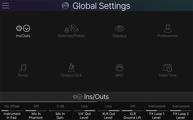

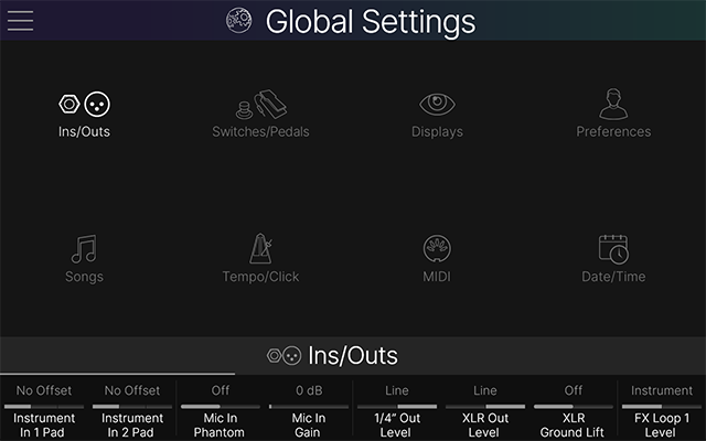

04.png Configure Stadium’s Global > Ins/Outs Settings
  • Tap the Main Menu The Main Menu button button, tap Global Settings GLobal Settings menu button , and tap Ins/Outs Global Settings - InsOuts selector .
  • Press the Page Page right arrow button button to access page 2 of the Global > Ins/Outs settings so that you can see the 1/4” Out Level and XLR Out Level parameters Global Level Settings . (Note that The Helix Stadium XL icon. Helix Stadium XL and Helix Stadium devices offer different Ins/Outs settings.)
The Global Settings - Ins/Outs settings are selected
Helix Stadium XL

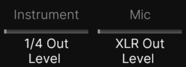

Note: The following are general guidelines. These Stadium Output settings are available in Global Settings > Ins/Outs. It is best to refer to the documentation from the manufacturer of your specific amplifier or other playback device and follow their recommendations for input level settings and options.
Stadium Output
Are you connecting to...?
Then do this:
1/4"
Guitar pedal or the front of a guitar amp
Set 1/4" Out Level to Instrument
Powered speakers, mixer, or a digital recorder
Set 1/4" Out Level to Line (the default)
XLR
Mic inputs on a mixing console or a standalone mic preamp
Set XLR Outputs to Mic
Powered guitar speaker system, PA/FRFR speakers, or studio monitors
Set XLR Outputs to Line (the default)
Tip: The Line 6 Powercab® family of active guitar speaker systems is specifically designed for guitar amp modelers and is a great choice for Helix Stadium devices!
