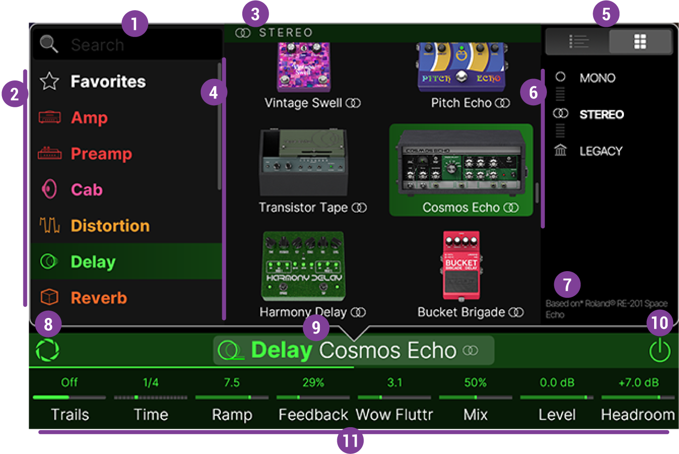

The Model List - A Stereo Delay Model is Selected (Gallery View)

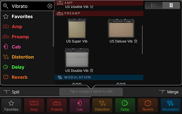

Item 01 Model Search: Tap in the Search field and type the name or type of Amp, Cab, or Effect you want. If the particular model you want is based on actual hardware, you can also typically enter the original brand name for your search. All filtered results appear in the center model column, separated by model type, as shown in the examples below.
Model Search - results when searching “Vibrato” offer Amp, Preamp, and Modulation Models
Item 2 Model Categories: Swipe up and down to scroll through the list of categories in the left column. Tap the desired category to select it and view its subcategories and models. Optionally, press while turning the Lower Knob to the right of the Main Display to quickly jump through the Model Subcategories.

Item 3 Subcategory Heading: This heading indicates the sidebar’s currently selected subcategory. As you scroll vertically through models, the heading will remain visible at the top.
Item 4 Models: The list of models for the selected category is displayed in the middle column, divided into subcategories. Swipe up and down to scroll through the list of models and select the desired model by tapping on it once or turning the Lower Knob to the right of the Main Display. The selected model can be auditioned while the list is visible. Double-tap on a model to load it and exit to the Home - Edit screen. Or press the Lower Knob or the Home button Home button to return to the Home - Edit screen with the currently selected model loaded.

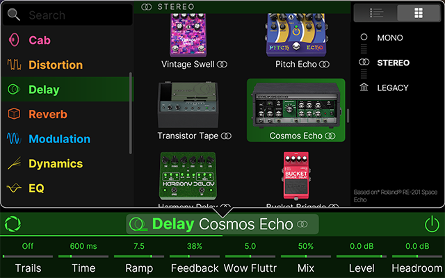

Item 5 Gallery/List View: List-Gallery View Button Tap the right button to display the Model List within the center column in Gallery View with detailed images of the modeled devices (the default) or tap the right button to change to the List View.
Gallery View
List View
Item 6 Sidebar Subcategories: Tap the desired subcategory to display its list.
Item 7 Model Details: “Based on” information displayed here provides additional details for the currently selected item.
Item 8 Focus Button: The Focus button The Focus button appears in the Inspector, offering specific views and options depending on the current model. Refer to the Focus View page for details.
Item 9 Current Category, Model Name, and Subcategory: Inspector Model Name The information about the currently selected model is displayed at the top of the Inspector. The model category symbol, model name, and model subcategory symbol are shown from left to right.

Item 10 Model Bypass: Tap BypassButton.png to toggle the selected model as bypassed (button is dimmed) or enabled (button is lit).
Item 11 Model Parameters: The selected model’s parameters are displayed within the Inspector, as shown below. Just as in the Home - Edit screen, you can adjust any parameter by either turning the respective Knob 1~8 below the parameter or tapping on the screen’s parameter to use the pop-up Parameter Panel.
