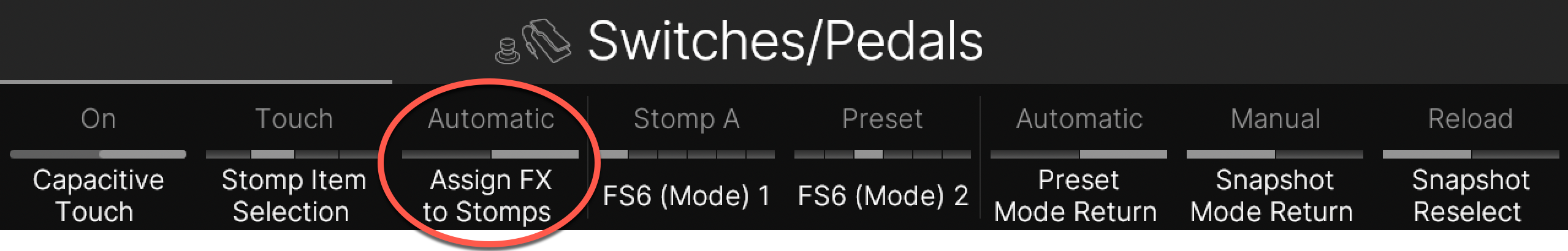

By default, adding an effect, Looper, or FX Loop block automatically assigns it to the first available Stomp A switch (or if Stomp A is full, the first available Stomp B switch). If you’d prefer to assign Stomps manually, set Global Settings > Switches/Pedals > Assign FX to Stomps to Manual (see below).

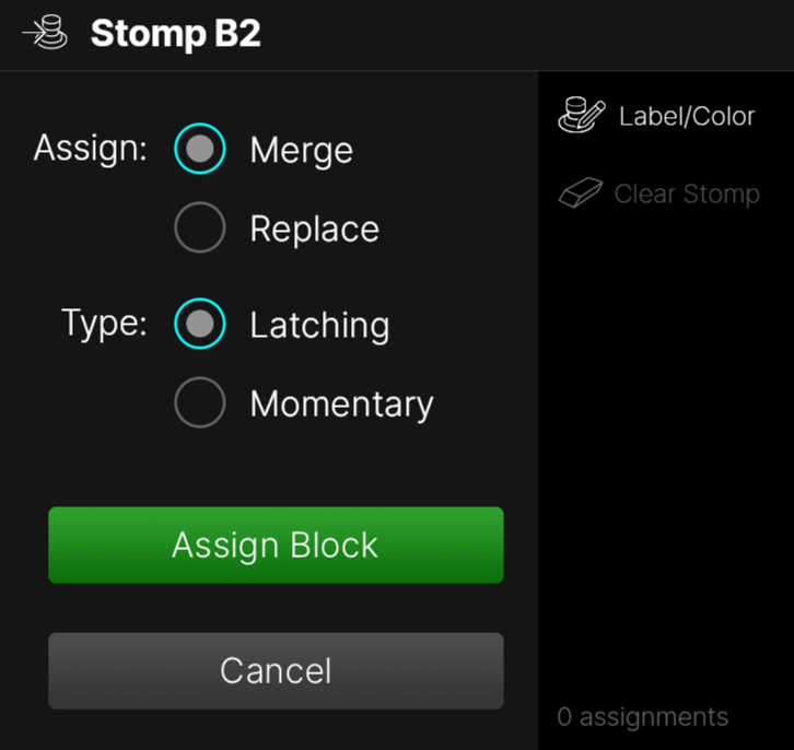

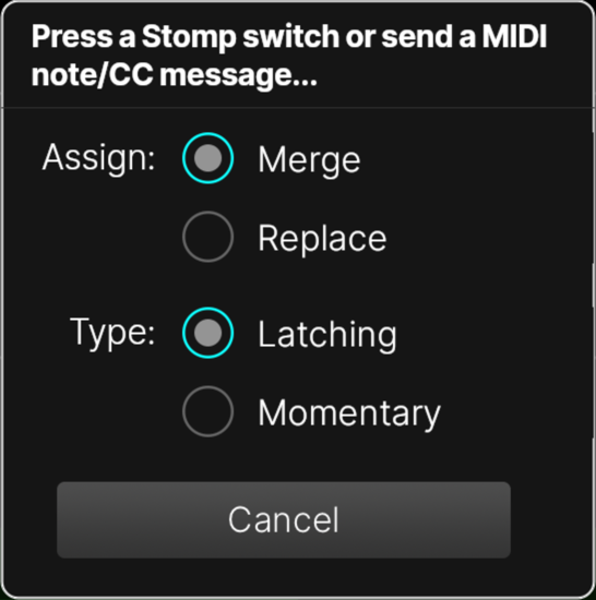

  3. Touch and hold (but don’t press) the desired footswitch. The Stomp Assign dialog appears (see below).
    • If you want to replace any other assignments that may already be on the switch, tap Replace. Otherwise, leave it set to Merge, which allows for multiple items to be assigned to the same switch.
    • If you want to make the switch momentary —that is, it changes state only while being held —tap Momentary. Otherwise, leave it set to Latching, which toggles the switch’s state every time it’s pressed. Note that footswitch type (Momentary or Latching) is determined per footswitch, not per assignment.
    • If you’d like to relabel or color the stomp switch, tap Label/Color. The keyboard appears. Enter the name and tap Done Done .
Quick Stomp Assign
  1. Tap Assign Block.

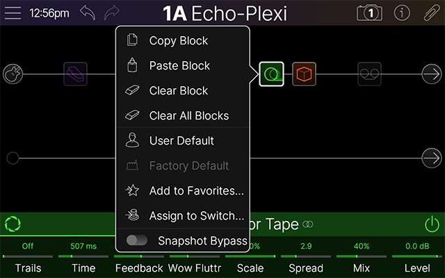

  2. Tap the selected block again. The Action Panel appears (below left.)
  3. Tap Assign to Switch… The Assign to Switch dialog appears (below right).
    • If you want to make the switch momentary—that is, it changes state only while being held—tap Momentary. Otherwise, leave it set to Latching, which toggles the switch’s state every time it’s pressed. Note that footswitch type (Momentary or Latching) is determined per footswitch, not per assignment.
Action Panel
Assign switch dialog
  1. Press the desired Stomp A or Stomp B switch, move an expression pedal, or send a CC or note from your MIDI controller. Alternatively, the block is assigned.

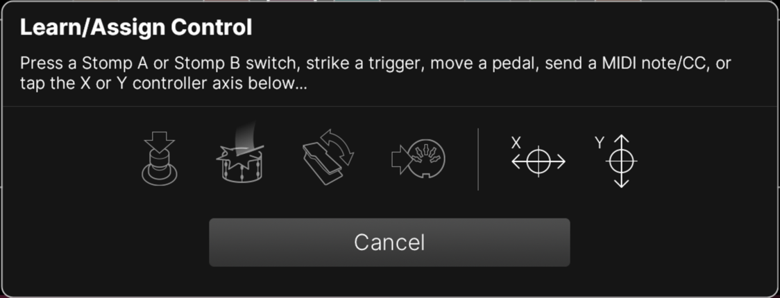

Use the following steps to quickly “Learn” a Controller assignment to a specific parameter using an expression pedal, switch, trigger, or MIDI type controller.
  1. From the Home > Edit screen, press and hold the knob for an unassigned parameter you wish to control. Alternatively, tap the parameter to open the Parameter Panel and tap Learn Controller in the sidebar. The Learn/Assign Control dialog appears (see below).
    • Note: If the parameter has already been assigned, pressing and holding the knob jumps to the Bypass/Control screen with that parameter in focus.
  1. Engage the controller from which you wish to control the parameter:
    • Press a Stomp A or Stomp B switch (or a momentary footswitch connected to CONTROL A/B or Helix Stadium XL only C/D).
    • Strike a drum trigger or contact microphone connected to CONTROL A/B or Helix Stadium XL only C/D.
    • Move the built-in expression pedal ( Helix Stadium XL only only) or an expression pedal connected to CONTROL A/B or Helix Stadium XL only C/D.
    • Send a MIDI CC or note from your MIDI controller.
    • Tap the X or Y controller axis icon in the dialog box.
Once a controller is learned, the parameter’s value appears white and small white nodes appear above and below the parameter slider, indicating the min/max range of control (see below):

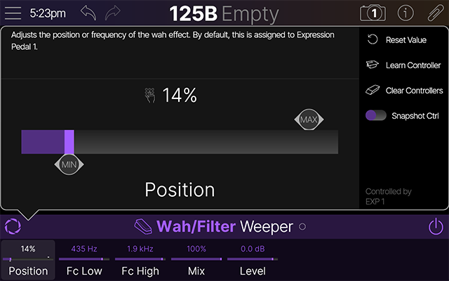

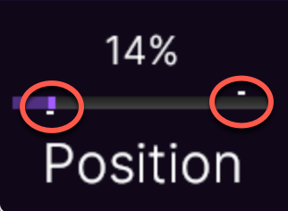

  1. To change the control range, tap the parameter. The Parameter Panel appears (see below). Tap and move the Min and Max nodes left or right to set the control range. To reverse controller behavior, move the Min note to the right of the Max node.
    • To quickly clear any assigned controllers from the parameter, tap Clear Controllers in the Parameter Panel’s sidebar.
The Parameter Panel showing a Wah Posiiton parameter's Minimum and Maximum flags
Parameter Panel

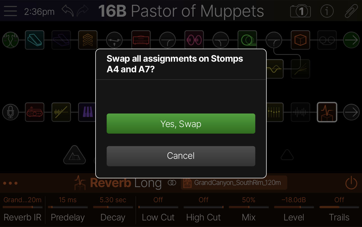

Quick-Swapping Stomp Switches
If you want to change the location of Stomp mode switches (especially those with multiple items assigned or custom labels and LED ring colors), instead of manually reassigning everything, you can quickly swap their locations.
  1. Touch (but don’t press) any two Stomp mode footswitches. The following dialog appears:
Swap Stomp Switches dialog
  1. Tap Yes, Swap.

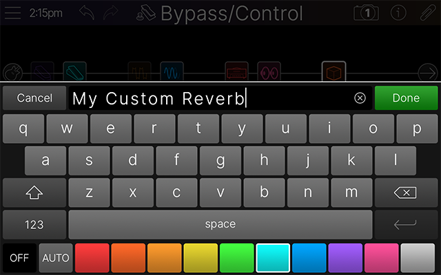

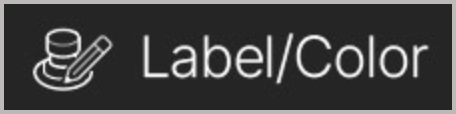

Customizing a Stomp’s Label and Color
  1. Tap-hold an assigned Stomp A or Stomp B switch. The Quick Stomp Assign dialog appears:
Quick Stomp Assign
  1. Tap Label/Color The Stomp switch Label-Color icon in the sidebar. A keyboard appears (see below). Enter the new label.
Customizing stomp label and color
  1. Tap the desired color swatch. Auto matches the default color for the footswitch LED (Delays are green, Mods are blue, EQs are yellow, etc.) and Off disables the LED, regardless of the switch’s bypass state.
  2. When finished, tap Done .

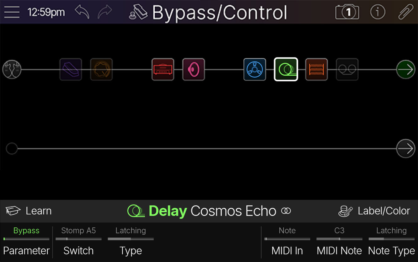

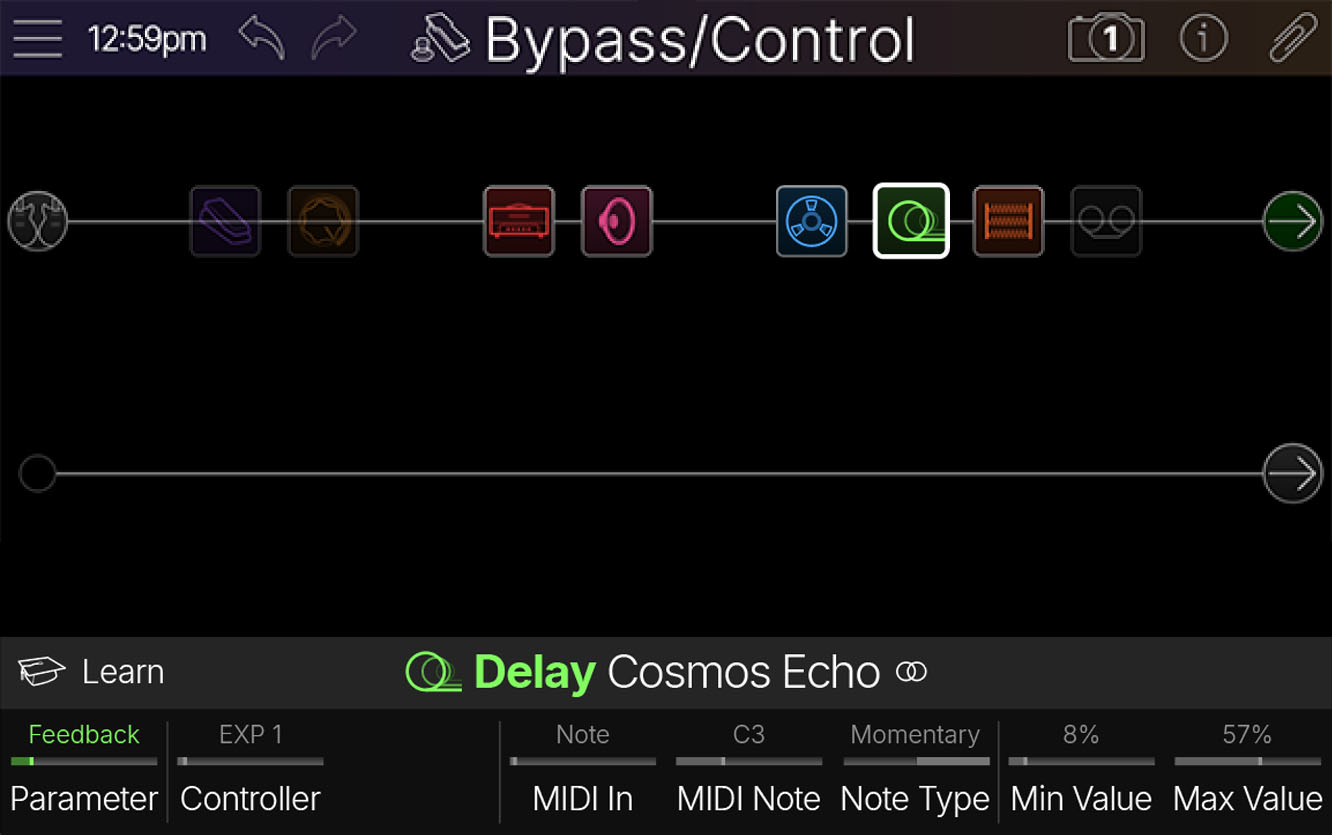

The Bypass/Control Screen
Most bypass and controller assignments can (and should!) be accomplished by Quick Bypass Assign, Learn Bypass, and Learn Controller (as illustrated above). But you can also manually assign bypass to blocks—and controllers to parameters—from the Bypass/Control screen.
  1. Tap the Menu icon Header_MenuButton.png and then Bypass/Control Button_MenuBypassControl.png . Alternatively, tap-hold any Home > Edit parameter in the inspector. The Bypass/Control screen appears.
  2. Turn Knob 1 (Parameter) to choose what you want to control. Different parameters appear on Knobs 2-8 depending on whether Knob 1 is set to Bypass (below left) or anything other than Bypass (below right).
Bypass/Control > Bypass selected
Bypass/Control > Parameter selected
  1. Tap Learn in the inspector header. If Knob 1 (Parameter) is set to Bypass, the Assign Switch dialog appears (below left). If Knob 1 (Parameter) is set to anything else, the Learn/Assign Control dialog appears (below right).

When Knob 1 (Parameter) is set to Bypass:
Switch
Selects the controller type for the Bypass assignment.
Type
Appears when Knob 2 (Switch) is set to any Stomp switch or external momentary footswitch.
Determines the behavior for the switch:
  • Latching: The block is bypassed (or enabled, if already bypassed) whenever you press the switch.
  • Momentary: The block is bypassed (or enabled, if already bypassed) for as long as you hold the switch.
Note: Footswitch type (latching or momentary) is determined per footswitch, not per assignment.
Position
Appears when Knob 2 (Switch) is set to an expression pedal.
Determines the point within the expression pedal’s travel where the block is enabled or bypassed. 0% is heel down; 99% is toe down.
Wait
Determines how long Helix waits before bypassing the block; for example, you wouldn’t want the wah to turn off every time you touched the heel down position in your big funk wah solo.
Behavior
Determines how bypassing is handled. When set to Toggle, bringing the pedal past the Position value toggles the block's bypass state (i.e., enabling it if currently bypassed and vice versa). Toe Down and Heel Down always bypass the block at the designated pedal position, regardless of the block's starting state. With Heel Down selected, the block always turns on when you cross the Position value and bypasses when you return below it.
MIDI In
Determines the type of MIDI command assigned to bypass:
  • None: The block’s bypass ignores incoming MIDI messages.
  • Note: The block can be bypassed by pressing MIDI notes (or drum pads) on a keyboard or other MIDI controller.
  • CC0~CC127: The block can be bypassed by an incoming MIDI CC message. CC values 0-63 turn the block off; values 64-127 turn the block on.
MIDI Note
Appears when Knob 6 (MIDI In) is set to Note.
Selects which MIDI note bypasses the block. Middle C is C3 on Yamaha® keyboards, but other companies may consider it C4.
Note Type
Determines the behavior of the MIDI note:
  • Latching: The block is bypassed (or enabled, if already bypassed) every time you press the key.
  • Momentary: The block is bypassed (or enabled, if already bypassed) for as long as you hold the key.
When Knob 1 (Parameter) is set to anything other than Bypass:
Controller
Selects the controller type for the assignment.
Note: On Helix Stadium XL devices, EXP 1, EXP 2, and EXP Toe are accommodated via the onboard pedal's toe switch. Please refer to the External Pedal and Switch Controller Configuration page for details.
Type
Appears when Knob 2 (Controller) is set to any Stomp switch or external momentary footswitch.
  • Latching: Toggles between Min and Max values every time you press the switch.
  • Momentary: The value changes for as long as you hold the switch and returns to its original value when you release it.
MIDI In
Determines the type of MIDI command assigned for control:
  • None: The parameter ignores incoming MIDI messages.
  • Note: The parameter’s min and max values can be toggled by pressing MIDI notes (or drum pads) on a keyboard or other MIDI controller.
  • CC0~CC127: The parameter can be controlled from an incoming MIDI CC message.
MIDI Note
Selects which MIDI note toggles between min and max values. Middle C is C3 on Yamaha® keyboards, but other companies may consider it C4.
Note Type
  • Latching: The parameter toggles between min and max every time you press the key.
  • Momentary: The parameter changes for as long as you hold the key and returns to its original value when you release it.
Min Value
Sets the value range to be controlled. For example, if your controller is an expression pedal, Min Value sets the value sent from the pedal when it is moved to its heel position, and Max Value sets the value when it is moved to its toe position.
Max Value

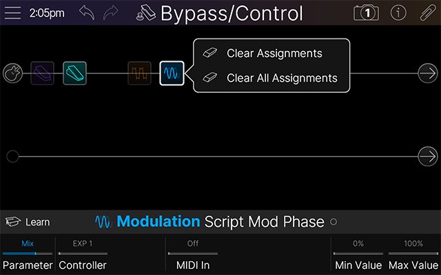

Bypass/Control Action Panel
  1. While on the Bypass/Control screen, tap the selected block. The Bypass/Control Action Panel appears:
Clearing all a block's, or all blocks' assignments
Bypass/Control > Action Panel
  • Tap Clear Assignments to clear all bypass and controller assignments from the selected block.
  • Tap Clear All Assignments to clear all assignments from all blocks within the current preset. A dialog appears: "Clear Bypass and Controller Assignments from all blocks?" Tap OK.
Note: To quickly clear an individual parameter’s controller assignments, from the Home > Edit screen, tap the parameter to open the Parameter Panel and tap Clear Controllers in the sidebar.

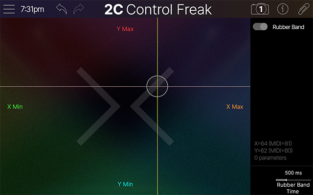

XY Controller
Helix Stadium’s screen can be used as a large performance-based touch controller where one or more parameters are assigned to the X or Y axis. Each axis on the XY Controller can also be used to transmit MIDI CCs via the Command Center.
Even though they look similar, Focus view and the XY Controller screen are very different. While Focus view (at least for most amps and effects) is used for quickly dialing in five distinct sounds of that particular block (with Focus zones in the four corners and center), the XY Controller is different in that any parameter from any block(s) can be assigned to an XY axis (with axis extremes along each edge). Just remember: Focus view is meant for editing a single block, XY Controller if meant for real time control of multiple blocks during a performance.
Assigning Parameters to the XY Controller
  1. Press-hold the knob for an unassigned parameter. The Learn/Assign Control dialog appears:
  1. Tap the X or Y axis icon. Repeat steps 1 and 2 for any other parameters you want to assign. See Learn Controller.
  2. Press the XY Controller button The top panel XY Controller button (to the right of the Save button). The XY Controller screen appears:
Adjusting the XY Controller screen
  1. Tap the circular XY node and move it around the screen to adjust all assigned parameters.
    • By default, lifting your finger causes the XY node to snap back to its original position. If you prefer the XY node stays where you left, tap the Rubber Band toggle Off.
    • The time it takes the Rubber Band to return is determined by Knob 8 (Rubber Band Time).
    • Read-only text appears in the sidebar, showing the current X and Y positions (0-100) as well as transmitted MIDI CC values (0-127) in case you’ve assigned the X and/or Y axis to MIDI CC from the Command Center.
