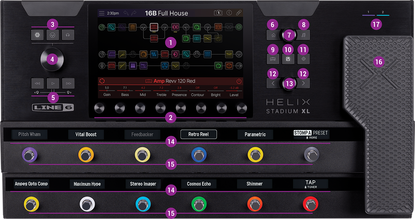

Please check out the video below for an overview of the Helix Stadium top panel controls and footswitch modes. Then, consult the sections on this page for additional details.
Top Panel Features
The Top Panel of your Helix Stadium XL or Helix Stadium includes most of the device’s controls, including the touchscreen and multi-function footswitches. These items are described below.
Helix Stadium XL top panel

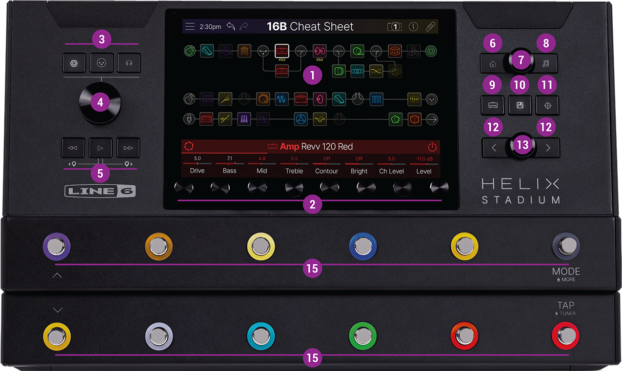

Item 01 Main Display: This large, vibrant color touchscreen is your primary access portal to the power of Helix Stadium. Please see the Display page for details.
Item 2 Knobs 1-8: Turn one of the eight knobs below the main display to adjust the parameter’s value above.
  • If a rectangular button or selector appears above a knob, press the knob to engage its function.
  • Press the knob to reset the parameter to its default value. Alternatively, tap the parameter and then tap Reset Value.
  • For a Delay or Modulation block’s Time, Rate, or Speed parameter, press the knob to toggle between ms/Hz and note division values.
  • Press and hold the knob to open the Quick Controller Assign dialog, which lets you assign the parameter to a controller (stomp switch, trigger, expression pedal, incoming MIDI Note/CC, or X/Y Controller axis) in 2 seconds. Alternatively, tap the parameter and then tap Learn Controller. Please see the Bypass and Controller Assignment page for details.
  • Press and turn the knob to quickly assign the parameter to snapshot control. Alternatively, tap the parameter, then tap the Snapshot Ctrl toggle switch on. Please see the Snapshots page for details.
Item 3 Output Buttons: Press the Quarter Inch Out button Main 1/4”, XLR Out button XLR, or Headphones Out button Phones output button to select it and turn the Volume knob Volume knob (4) to adjust its individual volume level. Please see the Main Volume and Matrix Mixer page for details.
  • Press the currently lit button to view its Matrix Mixer screen—The 1/4”, XLR, and Phones outputs each have their own dedicated Matrix cue mix layer and Global EQ.
    • Press and hold two (or all three) Output buttons to “link” their Volume knob control and Matrix cue mix. Press and hold all linked Output buttons to unlink them again.
    • Press and hold the currently lit Output button to completely disable Volume knob control. (Say, you don’t want anyone messing with it.) Press the button again to re-enable Volume knob control.
Item 4 Volume: Turn the Volume knob Volume knob to control the selected output’s volume with a handy real-time meter displayed—as assigned via the Output Buttons ( Item 3 ).
Caution - It might get loud! Always turn the Volume for the respective output(s) counterclockwise to minimum before making connections to external gear and headphones to avoid encountering loud bursts of audio 🤯 . Exposure to high volume levels can cause hearing damage or harm to your equipment.
Item 5 Transport: Press Play button Play to start playback of the selected song, press again to pause, or press and hold to return to the beginning of the song. (Note that these buttons control Song View transport functions only.)
  • Press Rewind-Previous button Rewind or Fast Forward-Next button Fast Forward to cue the previous or next song—the cued song flashes, indicating it’s ready for playback.
  • Press and hold Rewind-Previous button Rewind or Fast Forward-Next button Fast Forward to rewind or fast forward the current song.
  • While holding Play button Play, press Rewind-Previous button Rewind or Fast Forward-Next button Fast Forward to cue the previous or next Marker in the current song (if any). The cued marker flashes, indicating it’s ready for playback. Also see the Song View section.
Item 6 Home: Press the Home button Home button to display the Home > Edit View for building and editing your presets. If you ever get lost, press this button to exit your current screen and return to the Home > Edit screen instantly.
  • For Helix Stadium Devices: Press the Home button Home button to select between the Home > Edit and Home > Play views. Play view displays footswitch labels for the current Footswitch Mode. Please refer to The Home > Play View section for details.
Item 7 Upper Knob: Turn the Upper knob Upper Knob to perform the following Preset or Song actions, depending on the current View:
  • When in the Home View: Turn to cue a preset, then press to load it. Or press to open the Preset List.
  • When in the Preset List: Turn to select a preset, then press to load it.
  • When in the Song View: Turn to cue a song, then press to load and play it. Or press to open the Song List.
Item 8 Song View: Press the Song View button Song button to display the main Song window. Also see Song View.
Item 9 Amp: Press the Amp Select button Amp button to quickly jump to the Amp or Preamp block's tonestack parameters. Press the button repeatedly to cycle through multiple Amp and Preamp blocks within your preset. Note that while in Focus view, pressing the Amp Select button Amp button stays in Focus view—it doesn’t exit out to the Home > Edit screen.
  • Press and hold to quickly jump to the Cab block or cycle through multiple Cab blocks within the current preset.
Item 10 Save: Press the Preset - Song Save button Save button to perform the following actions, depending on the current view:
  • When on any Preset screen: Press to open the Save Preset screen. Press twice to quicksave the current preset.
  • When on any Song screen: Press to open the Save Song screen. Press twice to quicksave the current song.
Item 11 XY Controller: Press the X Y Controller button XY button to display the XY Controller screen, where you can slide your finger around the screen to adjust a wide variety of parameters (or control external devices via MIDI CC). Please see the XY Controller section for details.
Item 12 Left arrow page button Page Left / Right arrow page button Page Right: If the selected block or item has more than one page of parameters within the Inspector, press Left arrow page button or Right arrow page button to view the previous or next page of parameters.
Item 13 Lower Knob: Turn the Lower knob Lower Knob to perform the following actions, depending on the current view:
  • Home > Edit: Turn to change the selected block’s model. Press and turn to quickly skip model subcategories. Press to open the Model List. From an empty block location, turn to instantly scroll through any favorites.
  • Model List: With the category column highlighted, turn to select a model category, then press to load that category’s first model. With the model category highlighted, turn to select and audition models. Press and turn to quickly skip subcategories within the selected model category. Press to exit back to the Home > Edit screen.
  • Song Screen: Turn to scroll through the song’s Flags. Press and turn to quickly scroll through flags of the same type. Press to open the Flag List.
  • Flag List: Turn to scroll through the song’s Flags. Press and turn to quickly scroll through Flags of the same type. Press to exit back out to the main Song screen.

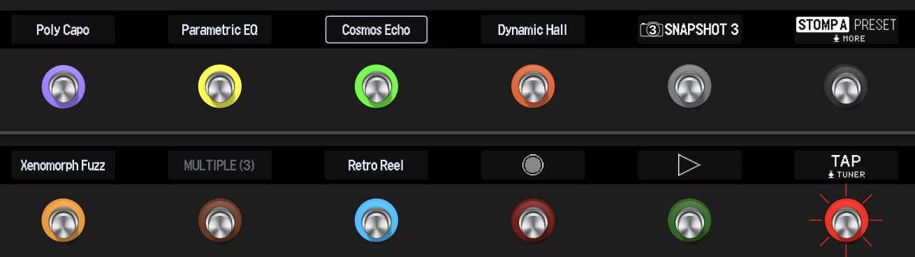

Item 14 Scribble Strips: Helix Stadium XL only feature. The twelve scribble strips show each footswitch’s current assignment. Several Footswitch Modes are available, as covered below.* Footswitch labels can also be customized for Stomp A and Stomp B switches.
*Note: Helix Stadium includes the same footswitch modes, but instead of utilizing scribble strips as offered on Stadium XL, Helix Stadium shows all footswitch labels on the main display’s Home > Play screen.

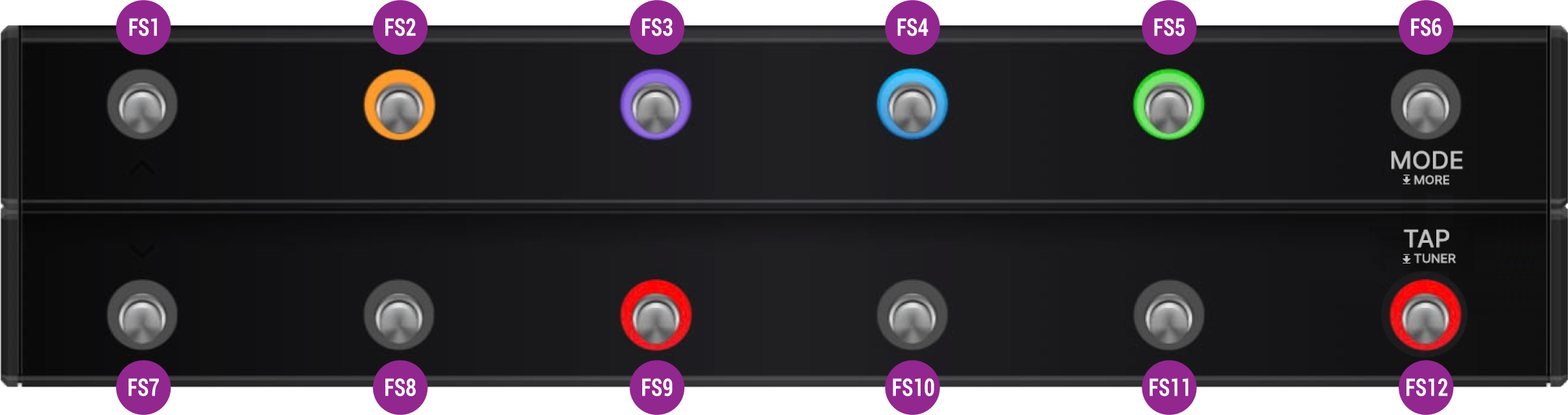

Item 15 Footswitches: The capacitive, touch-sensitive footswitches have colored LED rings Footswitch with green lit LED ring to inform you of the assigned block or item’s current state. See the following Capacitive Touch section. Six Footswitch Modes provide hands-free access to a wide variety of functions.
  • FS6 is dedicated to the Mode switch. Press FS6 to toggle between the two primary footswitch modes (by default, Stomp A and Preset, but these can be changed). Press and hold FS6 for More Mode, where you can access the other four footswitch modes as well as additional helpful functions.
  • Press the TAP/Tuner switch repeatedly to tap in a tempo for time-based effects (such as Delay and Modulation) to follow. Touch FS12 (but don’t press) to briefly display Tempo/Click settings. Press and hold FS12 to open the Tuner.
Tip: By default, the FS12 label temporarily displays the current BPM. Optionally, you can set it to always display the BPM by changing the Global Settings > Display > BPM Displays to Persistent.

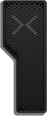

Item 16 Expression Pedal: Helix Stadium XL only Move the onboard Helix Stadium XL expression pedal Expression Pedal to control volume, pan, wah, pitch wham, or a combination of custom-assigned amp and/or effects parameters. Push the pedal forward firmly to activate the hidden Toe Switch to toggle between EXP 1 and EXP 2 (the Expression 1/2 LEDs [ Item 17 ] indicate which is active.) Note that the Toe Switch can also be custom-assigned for other functions.
  • For Helix Stadium XL, up to four additional expression pedals can be connected via the Control A/B and C/D jacks.
  • For Helix Stadium, up to two expression pedals can be connected via the Control A/B jack.
Note: On all Stadium devices, adding a Wah, Pitch Wham, or Poly Wham block automatically assigns its Position parameter to EXP 1. Adding a Volume or Pan block automatically assigns its Position to EXP 2. You can make custom EXP assignments for practically any parameters—see the Controller Assignment page.
Item 17 Expression 1/2 LEDs: Helix Stadium XL only These two colored LED bars indicate which EXP controller is currently in use with the onboard pedal; the violet (left) LED indicates EXP 1, and the teal (right) LED indicates EXP 2. Press the pedal fully forward firmly to toggle the Toe Switch between EXP 1 and EXP 2 pedal control.
Note: On Helix Stadium, you can connect and configure an external expression pedal and switch (or a Line 6 EX2 combination pedal & switch unit) to provide switchable EXP 1 and EXP 2 control with a single pedal. Please refer to the External Pedal and Switch Configuration page.

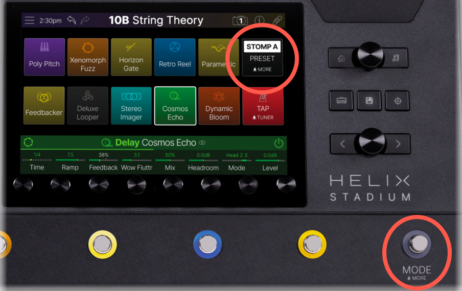

Footswitch Modes
About Footswitch Modes
Helix Stadium offers several different footswitch modes, accessible via FS6 (MODE), making it easy to access Stadium’s various functions. These include Stomp A, Stomp B, Preset, Snapshot, Combo, and Transport Modes. By default, FS6 (MODE) quickly toggles between Stomp A and Preset modes, but you can change it to the two modes you use most often. To follow, we cover the available footswitch modes and functions for both Helix Stadium device types.
Helix Stadium XL > switches FS1~FS12
Helix Stadium > switches FS1~FS12
Note: When in Stadium’s Proxy Clone creation screens, the current Footswitch Mode is suspended, and a few specific Cloning functions are offered on the footswitches. Please see the Clones section for details.
Footswitch Labels
Helix Stadium XL includes scribble strips to display each footswitch’s current function, but Helix Stadium shows these labels on the Home > Play screen. Press the Home button Home button to toggle between Home > Edit and Home > Play.
Helix Stadium Home > Play view (Stomp A footswitch mode on screen)

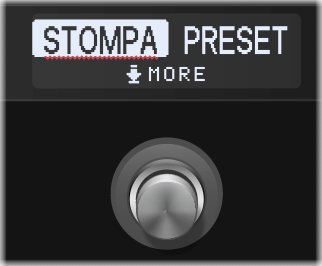

Changing the Footswitch Mode
By default, pressing FS6 (MODE) quickly toggles between Stomp A and Preset modes, but this can be changed to any two modes you like via Global Settings > Switches/Pedals > FS6 (Mode) 1 and FS6 (Mode) 2. Press and hold FS6 (MODE) to enter More Mode, where you can access the additional four footswitch modes not already on FS6 as well as engage additional functions.
Helix Stadium XL footswitch 6 mode switch
Helix Stadium XL’s FS6 (MODE) switch
Helix Stadium’s FS6 (MODE) switch

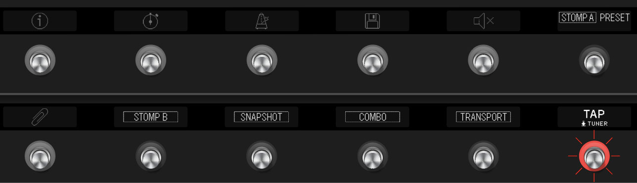

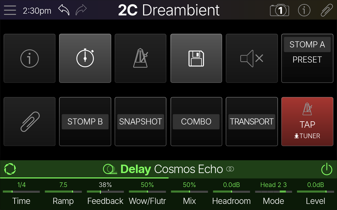

More Mode
Press and hold FS6 to access More Mode. Switches FS1 through FS5 and FS7 offer helpful shortcuts, and switches FS8 through FS11 access the additional four footswitch modes not already assigned to FS6 (MODE).
Helix Stadium XL’s More mode (scribble strips)
Helix Stadium’s More mode (Home > Play view)
Click to view More Mode
More Mode Switch
Function
FS1 (Preset Info)

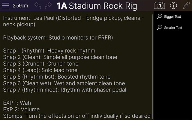

Press FS1 to open and close the Preset Info screen. All factory presets contain tips on how to best use them. Freely type in info for your own presets, like guitar/pickup/playback system used, creative controller assignments, tips/tricks, self-affirming platitudes, taco recipes, etc.
The Preset Info screen
FS2 (Stopwatch)
Press FS2 (Stopwatch) to change the main display’s clock to a stopwatch, which begins counting immediately.
  • On Helix Stadium XL Helix Stadium XL only , the stopwatch is also displayed on the FS2 scribble strip label.
  • On Helix Stadium, the stopwatch is also displayed on the Home > Play screen.
  • Press FS2 again to pause the stopwatch.
  • Press and hold FS2 to reset the stopwatch to 0:00:00.
To change the stopwatch back to a clock, tap on the main display’s stopwatch and then tap “Clock.”
FS4 (Preset Quicksave)
If the current preset has unsaved changes, the top panel’s Preset - Song Save button Save button appears bright white. Press FS4 (Quicksave) to quicksave changes to the current preset.

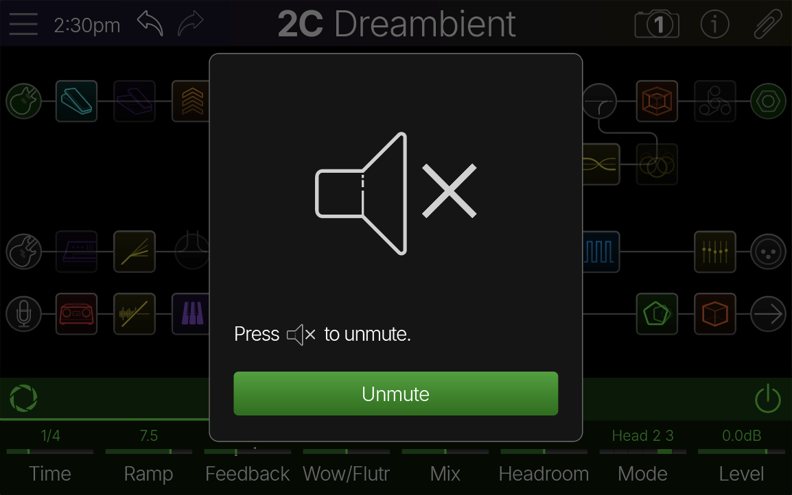

FS5 (Mute All)
There can be a lot of audio going through Helix Stadium at any given time, and you may not want to track down every signal during an emergency or set break. Instead, press FS5 (Mute All) to instantly mute all outputs. Press FS5 again (or tap the green Unmute button on the display) to unmute.
More mode > Mute All

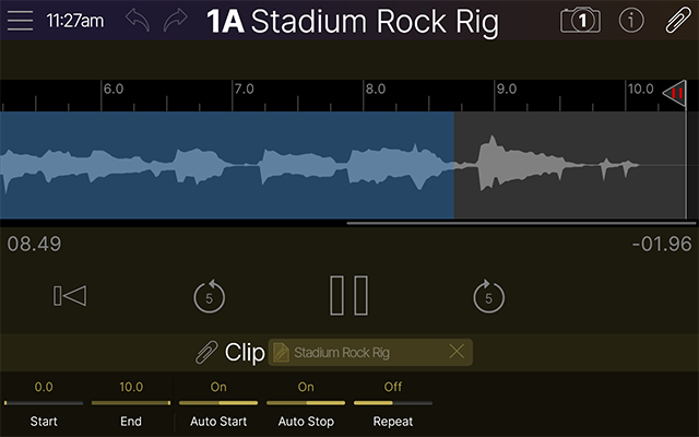

FS7 (Clip)
Press FS7 (Clip) to open the Preset Clip screen and begin clip playback; press again to close the Preset Clip screen. Please see Preset Clips for more info.
The Preset Clip screen
FS8~FS11
Press to access one of the four footswitch modes not already assigned to FS6 (MODE).
Tip: To swap out the primary footswitch modes on FS6 (MODE), press and hold the desired mode on FS8~FS11; it replaces the most recent (highlighted) mode on FS6. You can also set this from Global Settings > Switches/Pedals > FS6 (Mode) 1 and FS6 (Mode) 2.

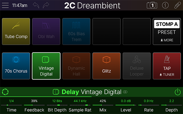

Stomp A and Stomp B Modes
Helix Stadium XL’s Stomp A footswitch mode
Helix Stadium’s Stomp A footswitch mode (Home > Play view)
Stomp A and Stomp B footswitch modes are most commonly utilized like a traditional pedalboard—that is, turning individual effects on and off. In fact, adding a new effect block automatically assigns it to the first empty Stomp A/B switch. (You can disable this behavior from Global Settings > Switches/Pedals > Assign FX to Stomps.) However, Stomp A and Stomp B are much more powerful and flexible than that, as they can, via the Command Center, combine functions from most of the other footswitch modes.
Note: Each Stomp A and Stomp B mode switch can accommodate multiple assignments (up to 16!), including any combination of block Bypasses, parameter min/max toggles, and/or Command Center commands. When a Stomp switch has more than one assignment, its label reads "MULTIPLE (X)," where X is the number of assignments (as shown on FS8 in Helix Stadium XL above). Stomp switch labels and LED ring colors can be customized as desired. See Bypass & Controller Assignments.
  • Block Bypass: Stomp A and Stomp B switches can toggle one or more blocks on (LED bright) and off (LED dim). In fact, when Global Settings > Switches/Pedals > Assign FX to Stomps is set to “Automatic,” all newly added effects blocks are automatically assigned to the next available empty Stomp A or B switch.
  • Parameter Control: Stomp A and Stomp B switches can toggle one or more Home screen parameters between any two values (min and max). For example, a Stomp could toggle an Amp block’s Gain between 2.3 and 5.6, toggle a Delay block’s Feedback parameter between 35% and 90%, or toggle a Split block’s routing from Path A to Path B. See Quick Controller Assign for more info.
  • Command Center commands: Via the Command Center menu, Stomp A and Stomp B switches can be assigned to a wide variety of additional functions and commands. These include MIDI CC messages for controlling an external pedal, Ext Amp commands for switching channels in your real amps, or even preset, snapshot, looper, transport, and other functions from different footswitch modes. See Command Center for more info.
What’s nuts is that a single stomp switch can do all of the above things at the same time. For example, Stomp A1 could turn on a delay block, turn off a reverb block, increase the Compressor block’s Output parameter, decrease the Amp block’s Treble parameter, transmit a middle C note to your synth via MIDI, and start a Quicktime® video on your laptop. We have no idea why you’d want to do this, but it’s nice to know you could. Couple this with the fact that you have 20 Stomp switches (or more if you connect external momentary switches to the rear panel Control jacks), and you can quickly see how powerful Stomp A and Stomp B footswitch modes can be.
Tip: Quickly select, create, and swap Stomp mode assignments using Stadium’s Capacitive Touch functionality!

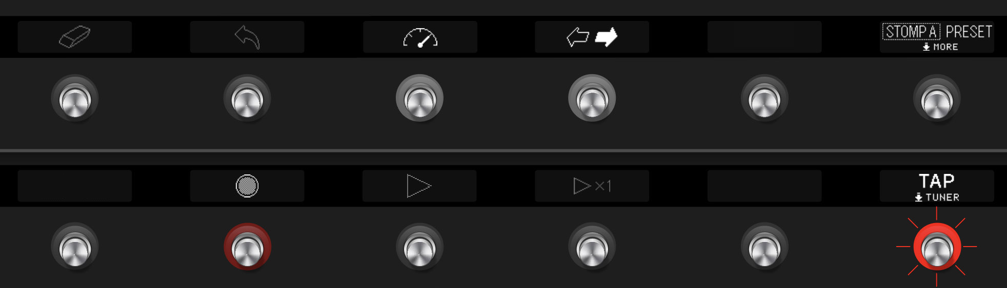

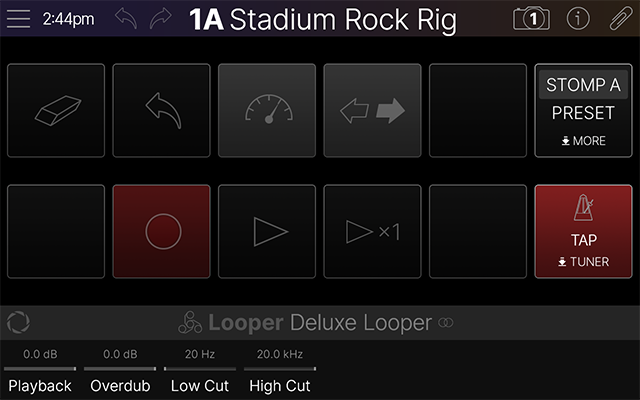

Deluxe Looper Footswitch Mode
Though not selectable via the FS6 MODE switch or More Mode, the Deluxe Looper has its own special footswitch mode. When a Deluxe Looper is added to your preset, just as when adding any other effect model, a Stomp switch assignment is automatically created. Press the Deluxe Looper stomp, and looper-specific functions appear on footswitches 1~4 and 8~10. See Deluxe Looper for more info.
Note: 1 Switch and Shuffling Looper blocks do not utilize a special Looper Footswitch mode—they perform all functions from their single Stomp footswitch.
Helix Stadium XL’s Deluxe Looper mode
Helix Stadium’s Deluxe Looper mode (Home > Play view)

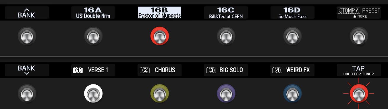

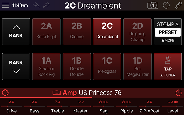

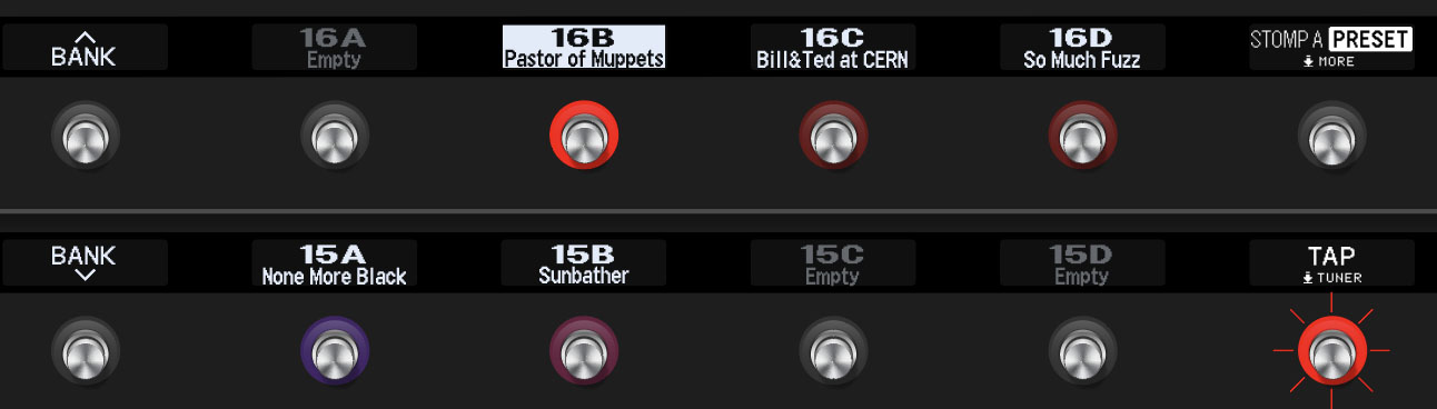

Preset Mode
Preset footswitch mode - Helix Stadium XL
Helix Stadium XL’s Preset mode
Helix Stadium’s Preset mode (Home > Play view)
As its name suggests, this mode assigns switches to the current Factory, User, or Setlist folder’s presets, organized by Bank. Press FS1 (Bank Up) to display and cue the next two banks of presets A~D, and FS7 (Bank Down) to display and cue the previous two banks. Then press the desired preset switch to load it.
Tip: Press FS1 and FS7 together and immediately release them to jump to Snapshot mode. You can also select Snapshot mode by holding FS6 (MODE) and pressing the SNAPSHOT switch.
Note: The Snapshot Footswitch mode behavior can be changed via Global Settings > Switches/Pedals > Snapshot Mode Return. When set to Manual (the default), the switches remain in Snapshot mode unless you press both FS1 and FS7 again to manually return to Preset mode. When set to Automatic, pressing a snapshot switch automatically returns to Preset Mode.
  • While in Preset, Snapshot, or Combo mode, press and hold FS1 and FS7 together to change them to Bank up/down, Preset up/down, Snapshot up/down, Song up/down, or Marker up/down switches. This can also be set from Global Settings > Switches/Pedals > Up/Down Switches.
    • When set to Song Up/Down, FS1 and FS7 cue the next/previous song in the current playlist.
    • When set to Marker Up/Down, FS1 and FS7 cue the next/previous marker in the current song.
  • If the USER PRESETS folder (or any Setlist) contains no presets, the preset switch scribbles appear dim and are named “Empty.”
  • Press the currently lit Preset switch to reload the last saved version of the preset. (Note that this will clear any edited settings.)

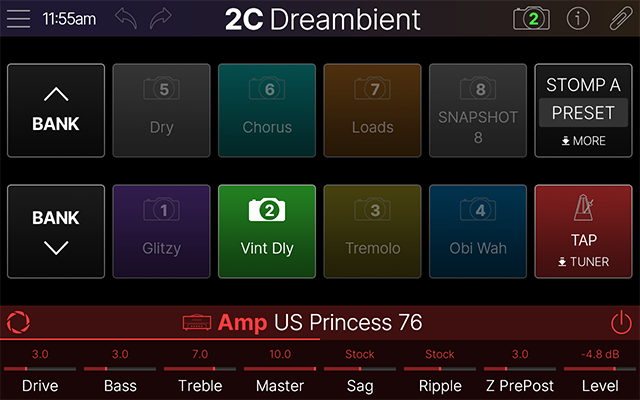

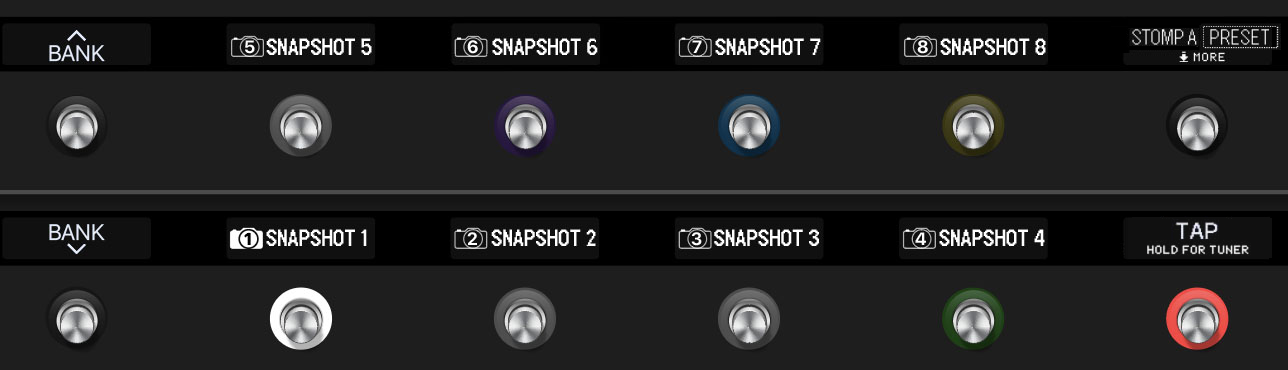

Snapshot Mode
Snapshot Mode footswitches
Helix Stadium XL’s Snapshot mode
Helix Stadium’s Snapshot mode (Home > Play view)
To enter Snapshot mode, press and hold FS6 (MODE) to enter More mode and then press the SNAPSHOT switch. Alternatively, press FS1 and FS7 together from Preset or Combo mode. Please see Snapshots for details about their many useful functions.
  • From Snapshot mode, press any switch, FS2~FS5 or FS8~FS11, to load one of the current preset’s snapshots.
Note: The behavior once a preset is loaded while in Snapshot mode can be changed via the Global Settings > Switches/Pedals > Snapshot Mode Return parameter. When set to Manual (the default), the switches remain in Preset mode, unless you press both FS1 and FS7 again to manually return to Snapshot Mode. When set to Automatic, switches FS2~FS5 and FS8~FS11 auto-return to Snapshot Mode immediately once a Snapshot footswitch is pressed.
Note: The behavior when pressing the currently active snapshot switch a second time can be changed via the Global Settings > Switches/Pedals > Snapshot Reselect parameter. When set to Reload (the default), pressing the active snapshot switch reloads it. When set to Toggle Prev, pressing the active snapshot switch toggles between it and the previously active snapshot; this can be helpful if you want to quickly jump back and forth between two snapshots from a single switch.
Tip: To quickly swap the locations of two Snapshots, touch and hold both Snapshot switches together—see Stadium’s Capacitive Touch functionality.

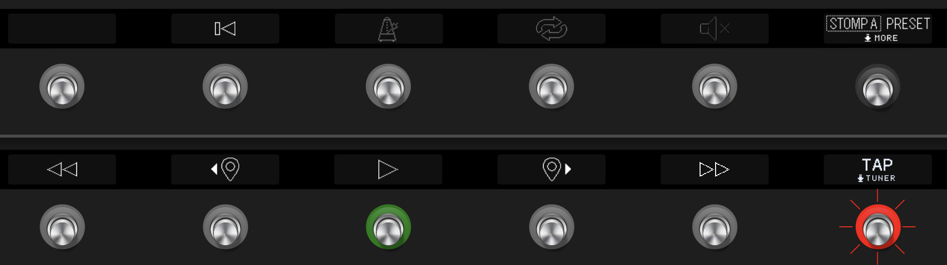

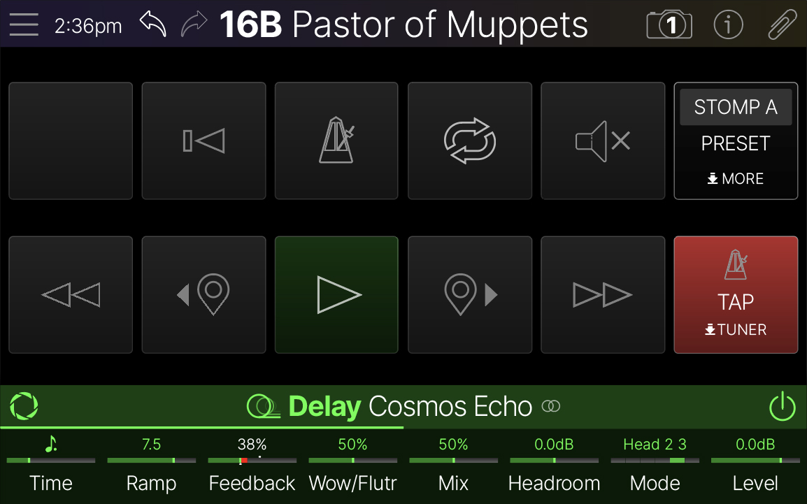

Transport Mode
Transport mode is used to cue and play songs and markers on Helix Stadium’s Showcase automation and playback engine. To enter Transport mode, press and hold FS6 (MODE) to enter More mode and then press the TRANSPORT switch. Please also see the Song View > Performing Songs page for additional information.
Helix Stadium XL’s Transport mode
Helix Stadium’s Transport mode (Home > Play view)
