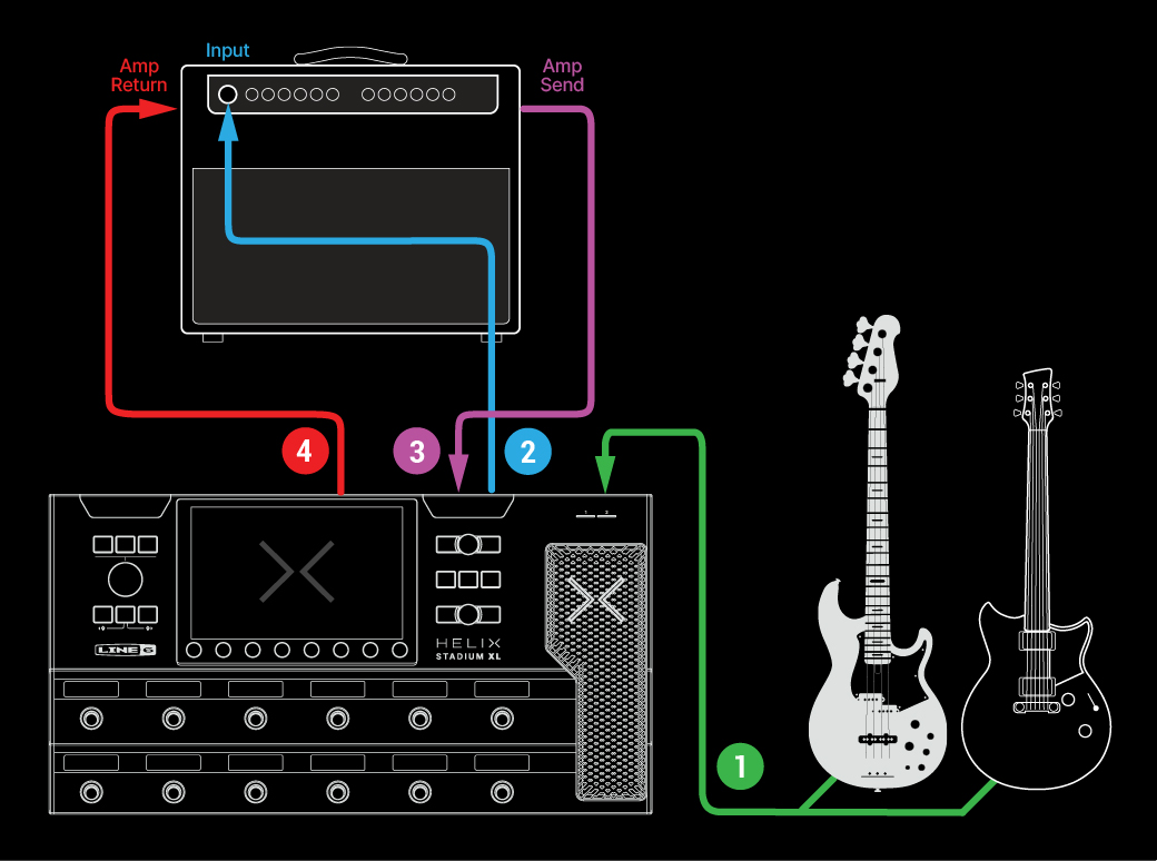

4-Cable Method Setup
“4-Cable Method” is a popular and flexible setup that allows you to route some Stadium effect blocks (most often drives, distortions, wahs, and compressors) before your external amplifier's preamp, and other effects blocks (often time-based effects like delays and reverbs) within the amplifier’s effects loop. Create a new Helix Stadium preset using the provided “4-Cable Method” Preset Template, then make your cable connections as described in the following steps.* Use shielded, 1/4” Tip-Sleeve (TS) instrument cables for all connections.
*Note: The “4-Cable Method” preset template already includes an enabled FX Loop block. You won’t hear any signal with this preset unless you make the cable connections with an external amplifier and its FX Loop as described below.
4-Cable Method setup example
  1. Instrument Input: Connect your guitar, bass, or other instrument to Helix Stadium’s Instrument input.
  2. Stadium FX Loop 1 > Send Output: Connect to the front 1/4” input of your external amplifier.
  3. Amplifier FX Loop > Send Output: Connect to the Stadium FX Loop 1 > Return input.
  4. Stadium 1/4” L/MONO Output: Connect to the amplifier’s FX Loop > Return input.

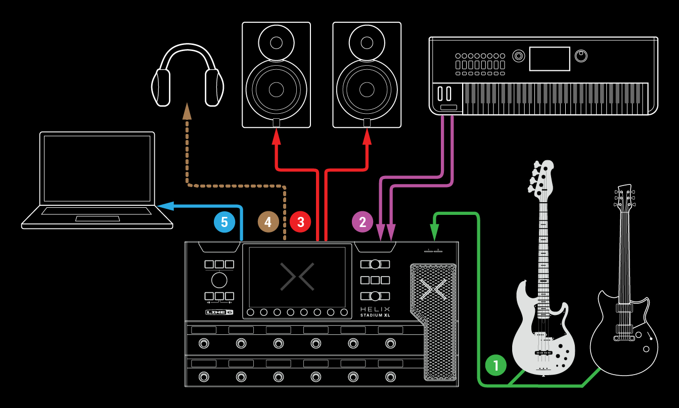

Home Studio - USB Recording Setup
Helix Stadium also functions as a high-quality, 24-bit, multi-channel USB-C® audio interface with all major macOS and Windows® DAW host applications. Use this configuration to put Stadium to work in the studio for recording, re-amping, and mixing. Please refer to the USB Audio page for additional details.
Studio setup example
  1. Instrument Input: Connect your guitar, bass, or other instrument to Helix Stadium’s Instrument input, or to XL Only Icon.png Helix Stadium XL’s Instrument 1 or Instrument 2 input.
  2. Return Input: For additional inputs, connect instruments or other audio sources, such as a synth or drum machine, to Stadium’s Return input (use two Returns for stereo input). Returns can be selected as input sources within your preset’s Input blocks.
  3. XLR Outputs: Connect from the L/MONO and RIGHT XLR balanced outputs to your left and right powered studio monitors. Press the Stadium XLR Output button XLR Out button so it’s lit and turn the Volume knob to adjust playback level.
  4. Phones Out: Optionally, connect stereo headphones for monitoring.
  5. USB-C: Connect directly to your computer’s USB-C port; it is not recommended to connect using a USB hub.
Optionally, use Stadium’s MIDI ports or USB-C MIDI to send and receive control commands and MIDI Clock—see the next section.
Tip: You can optionally use Stadium to record a dry, D.I. signal into your DAW software and apply your presets to “re-amp” your D.I. tracks. This can be accomplished simply by changing the current preset’s Input and Output block settings. Please see DI Recording and Re-Amping.

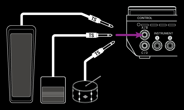

Control A/B and C/D Connections

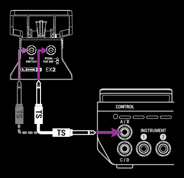

Stadium’s Control A/B (and Helix Stadium XL only Helix Stadium XL’s Control C/D) are used to connect external expression pedals, momentary footswitches, or drum triggers/pad controllers, which can be assigned to control block bypass, parameter control, and a wide variety of other functions. See External Pedals and Switches for details.
Connecting a Line 6 EX2 for pedal or switch control - Helix Stadium XL
Connecting an external controller - Helix Stadium XL
