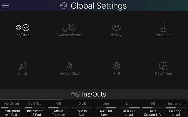

The Global Settings menu contains additional parameters that apply to all presets and songs, such as input and output levels, footswitch behavior, display brightness, etc.
  1. Tap the Menu icon Header_MenuButton.png and then Global Settings The main menu - Global Settings selector . The Global Settings screen appears (below).
  2. Tap the desired submenu icon; its parameters appear in the inspector.
Global Settings

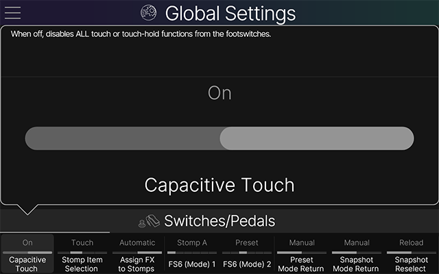

  1. To view additional pages, press Left arrow page button or Right arrow page button or swipe the parameters left or right.
  2. Not sure what a global setting does? Tap the setting to open the Parameter Panel, which provides a description:
Global Settings > Parameter Panel
Global Ins-Outs Button Global Settings > Ins/Outs
Click to show/hide Global Settings > Ins/Outs settings...
Parameter
Description
Inst [X] Pad
Sets the Instrument input level.
  • No Offset: Choose this if you want to set the Pad on/off setting per preset, from the Input > Instrument > Pad parameter.
  • Off/Inst: The input is set to Instrument level.
  • On/Line: The input is set to Line level. If your guitar or bass has active or high-output pickups, you may want to choose On/Line to avoid input clipping. Otherwise, just use what sounds best.
Mic In Phantom
When set to On, 48V phantom power is provided via the XLR Mic In jack for studio condenser microphones.
IMPORTANT! Never plug or unplug a mic or XLR cable while phantom power is On. Leave this setting Off unless you’re sure your connected mic requires phantom power. Please refer to your microphone manufacturer's documentation.
Mic In Gain
Controls the preamp gain for the XLR Mic input. Note that the Mic’s input signal can be further adjusted up or down from the Input > Mic block’s Trim parameter.
1/4" Out Level
Choose Instrument when connecting the 1/4” outputs to stompboxes or the front of guitar or bass amps. Choose Line when connecting to studio monitors or the line inputs on mixers.
XLR Out Level
Choose Mic when connecting the XLR outputs to the XLR mic inputs on mixers. Choose Line when connecting to mixers, studio monitors, or audio interfaces.
XLR Ground Lift
When On, lifts the ground pin on the XLR outputs. This may help in reducing ground loops in certain situations.
FX Loop [X] Level
Choose Instrument when using a Send/Return pair as an FX loop for external stomp boxes. Choose Line when connecting external rack processors, keyboards, drum machines, mixers, or other line level gear. Note that FX Loop levels can be further adjusted via an FX Loop block's Send and Return parameters.
(Send and Return 3 and 4 are available on Stadium XL The Stadium XL Only icon only.)
Return [X/X] Type
Determines the behavior of the Return 1 and 2 (Return 3 and 4 on Stadium XL The Stadium XL Only icon ) jacks:
  • Return 1/2 (Return 3/4 on Stadium XL The Stadium XL Only icon ): The jacks are used for Return and FX Loop blocks. In this case, the Aux In channel on the Matrix Mixer is grayed out and unavailable.
  • Aux In: The Return 1/2 (Return 3/4 on Stadium XL The Stadium XL Only icon ) jacks act as an always-on stereo Aux input (no processing) for monitoring the FOH or jamming along with mixers, media players, etc. In this case, the Aux In channel on the Matrix Mixer is active, but the equivalent FX Loop and Return blocks will be unavailable.
Re-amp Src Out USB 7
Determines which two physical inputs are sent dry (unprocessed) to your DAW software. USB Out 7 and 8 are dedicated to recording a DI signal, which can then be used with plug-ins or for Re-amping back through Helix Stadium.
Re-amp Src Out USB 8
USB Out 1/2
Determines where the USB Out 1/2 signal is sourced from:
  • Direct Out: USB Out 1/2 appears as a routable output destination from the Home > Edit screen and appears in the Output list.
  • Matrix 1/4”: USB Out 1/2 echoes the Matrix 1/4” layer. USB 1/2 is grayed out and unavailable in the Output list.
  • Matrix XLR: USB Out 1/2 echoes the Matrix XLR layer. USB 1/2 is grayed out and unavailable in the Output list.
  • Matrix Phones: USB Out 1/2 echoes the Matrix Phones layer. USB 1/2 is grayed out and unavailable in the Output list.
S/PDIF Out
Determines where the S/PDIF Out signal is sourced from:
  • Direct Out: S/PDIF appears as a routable output destination from the Home > Edit screen and appears in the Output list.
  • Matrix 1/4”: S/PDIF Out echoes the Matrix 1/4” layer.
  • Matrix XLR: S/PDIF Out echoes the Matrix XLR layer.
  • Matrix Phones: S/PDIF Out echoes the Matrix Phones layer.
S/PDIF Out Level
Sets the S/PDIF output level. For most cases, you can leave this set to 0.0dB.
S/PDIF Sample Rate
Selects the sample rate for the S/PDIF output. When connecting to another S/PDIF device, ensure both units are set to the same sample rate. Note that this setting does not affect USB audio.
Global Switches-Pedals Button Global Settings > Switches/Pedals
Click to show/hide Global Settings > Switches/Pedals settings...
Parameter
Description
Capacitive Touch
When off, disables all touch or touch-hold functions from the footswitches.
Stomp Item Selection
Determines whether touching, pressing, or both touching and pressing a Stomp mode footswitch selects the assigned focused block or jumps to the Bypass/Control Assign or Command Center page.
Assign FX to Stomps
Determines whether or not Helix Stadium automatically assigns a new effect block to the earliest empty Stomp Mode footswitch location. Amp, Preamp, Power Amp, Cab, IR, Split, and Merge blocks are never auto-assigned.
FS6 (Mode) 1
Determines which of the two footswitch modes FS6 toggles between, both of which appear on FS6 (MODE).
Shortcut: While in More Mode, press and hold the desired mode select switch to swap out the current FS6 Mode 1 or Mode 2.
FS6 (Mode) 2
Preset Mode Return
If FS6 (MODE) is set to toggle between Preset and another mode (Stomp A, Stomp B, Snapshot, Combo, or Transport), this parameter determines whether selecting a preset footswitch automatically toggles back to the other mode. This setting is locked to "Manual" if neither FS6 Mode 1 nor FS6 Mode 2 is set to "Preset."
Snapshot Mode Return
Determines whether selecting a snapshot switch stays in Snapshot mode (“Manual”) or automatically returns to the previous mode (“Automatic”).
Snapshot Reselect
Determines whether pressing the active snapshot footswitch reloads the stored state of the snapshot (Reload) or toggles between it and the previously selected snapshot (Toggle Prev).
Combo Top Row
Determines which functions appear on the top row (FS2~FS5) and bottom row (FS8~FS11) in Combo Footswitch mode. (Transport switches cannot be assigned to Combo mode.)
Combo Bottom Row
Up/Down Switches
Determines whether FS1 and FS7 are Bank, Preset, Snapshot, Song, or Marker Up/Down. Up/Down switches appear in Preset, Snapshot, and Combo Footswitch modes only, and can be manually assigned to Stomp A and Stomp B switches via Command Center > Preset/Snapshot and Song commands.
Shortcut: Press and hold FS1 and FS7 together to cycle through available Up/Down assignments.
Swap Up/Down
When On, swaps FS1 and FS7 for the Preset, Snapshot, and Combo Footswitch modes, so that Down is on the top and Up is on the bottom.
Flip EXP 1/2 Polarity
When On, the polarity of the onboard Expression Pedal behavior is reversed (for both EXP 1 and EXP 2 modes of the pedal), so heel and toe values are reversed.
EXP [X] Pedal Position
Each EXP Pedal offers its own independent Position option, which determines whether its position is recalled Per Preset (the default for each) or applied as Global. If you want a Wah or Volume Pedal to maintain its current position when switching presets, set this to Global.
Note: When set to Global, the current position persists on preset recall, even if Snapshot Control is currently active for the preset’s pedal position parameter.
Control A (Tip)
Determines whether each Control jack (A~D*) is an expression pedal input, external footswitch input, external drum trigger input, or an external amp remote switch output. (Also see Configuring External Controllers.)
Control B (Ring)
Control C (Tip)
Control D (Ring)
Flip A (Tip) Polarity
When on, reverses the polarity of an expression pedal or footswitch received at the respective jack’s tip or ring conductor.* Reversing the polarity may be necessary for compatibility with certain third-party switch or expression pedals—please see the device manufacturer's documentation.
Flip B (Ring) Polarity
Flip C (Tip) Polarity
Flip D (Ring) Polarity
Trigger [X] Sensitivity
Controls the sensitivity of a drum trigger (A~D*) connected to the respective jack’s tip or ring conductor. Grayed out and unavailable unless Control A, B, C, or D is set to Trigger In.
Trigger [X] Threshold
Determines the minimum force required for a drum trigger connected to the respective jack’s tip or ring conductor. Grayed out and unavailable unless Control A, B, C, or D* is set to Trigger In.
*Control C and D jacks are available on Stadium XL The Stadium XL Only icon only.
