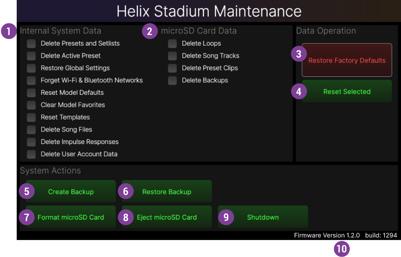

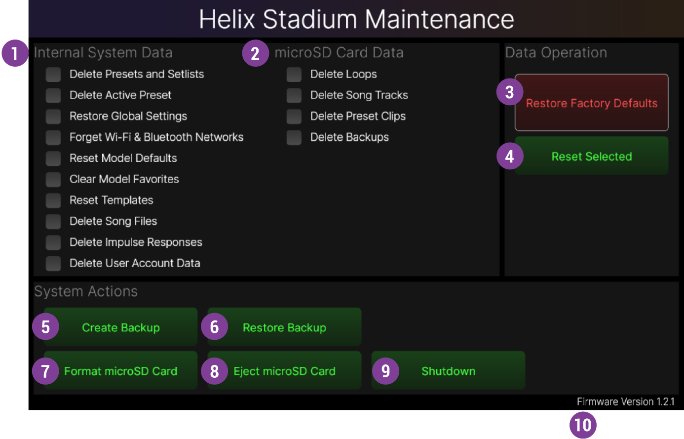

Note that it is necessary to power on your Helix Stadium device using the following procedure to enter the Maintenance screen:
With your Helix Stadium device powered Off, press and hold both the Home Button_Home.png and Song Button_Song.png buttons while powering Helix Stadium On, and continue holding the buttons for approximately 10 seconds, until you see the Helix Stadium main Display become lit.

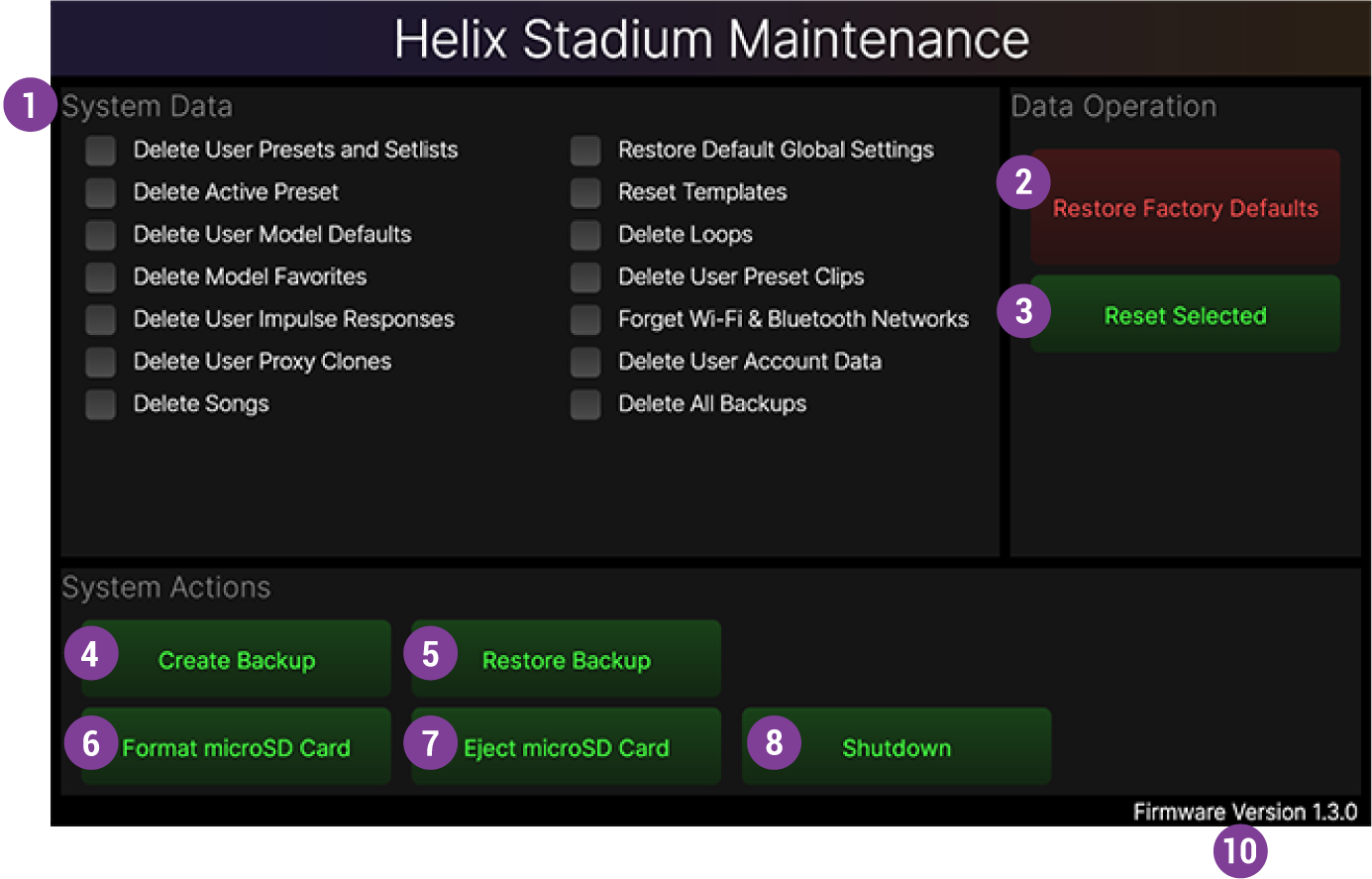

The Maintenance screen
Important! Note that creating and restoring device backups requires the use of a microSD card, which is sold separately. A microSD card must be formatted by Helix Stadium before its use. Please see the following section for Formatting a microSD Card.
01.png Internal System Data: These options clear, reset, or manage the individual files and data types that you have created. Check the box for any item(s) in this list you wish to execute, then tap RestoreSelectedButton.png .
Important! These actions will permanently delete or reset the selected data from your device. If you wish to retain your current Stadium device’s internal data, first follow the steps on this page for Creating a Backup.
Item 2 Restore Factory Defaults: This action will perform a complete Factory Reset of your Stadium device, permanently deleting all user-created data and resetting all settings to their factory defaults. Please see the following section for Performing a Factory Reset.
Important! Note that these actions will permanently delete all user-created data and reset all settings to their factory defaults. If you wish to retain a copy of your current Stadium device’s internal data and settings, first follow the steps on this page for Creating a Backup.
Item 3 Reset Selected: As instructed in step 01.png , use this button to execute the checked actions.
Item 4 Create Backup: Tap to initiate a complete backup of all your Helix Stadium’s user data to an inserted microSD card. See the following steps for Creating a Backup.
Item 5 Restore Backup: Tap to restore all your Helix Stadium’s user data from a backup stored on an inserted microSD card. Note that performing a Restore will overwrite all user data on your Stadium device. See the following section for Restoring a Backup.

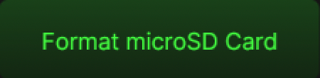

Item 6. Format microSD Card: Tap to format an inserted microSD card. Note that formatting will permanently erase all backups and data on the card. See the following section for Formatting a microSD Card.

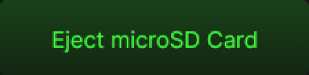

Item 7. Eject microSD Card: As instructed in some of the following sections, you may need to use this button to unmount an inserted microSD card at the end of a task before performing further actions.
Item 8. Shutdown: As instructed in the following sections, use this button before toggling the Stadium switch to power the device off (much like you need to select a “Shut Down” menu command to power off a computer).
Item 9. Firmware Version: Displays the currently installed Stadium Firmware version.

  • Tap the Eject micro sd card button. button, tap The OK button. in the “microSD card is unmounted” dialog, and then gently push the microSD card inward to physically eject it from the card slot.

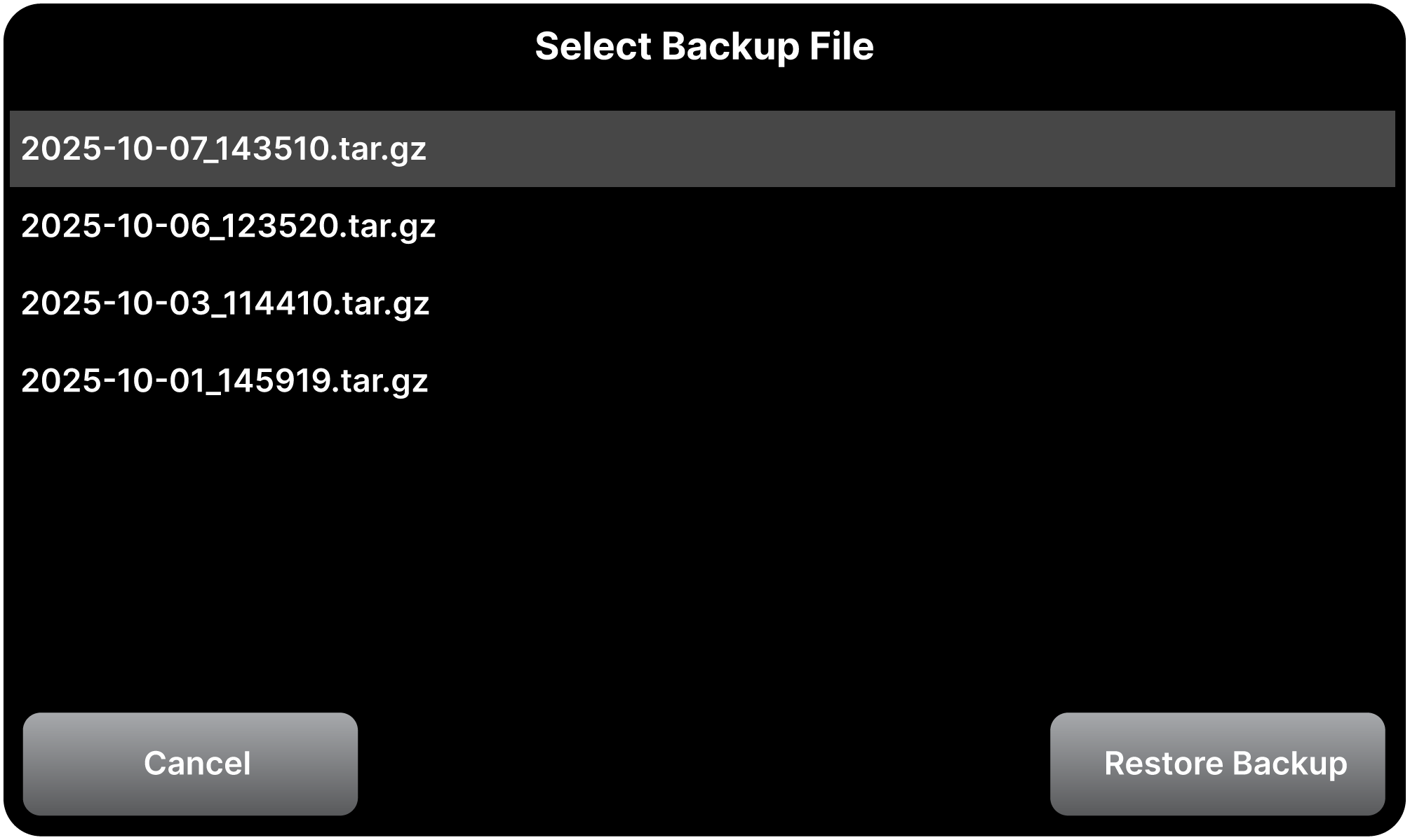

  1. Tap RestoreBackupButton.png .
  2. In the Select Backup File dialog that appears, you’ll see the list of backup files you’ve created on the current microSD card, named with the date created and sorted with the most recent backup at the top. Tap the desired backup file to select it, then tap the dialog’s Restore Backup button.
  1. When prompted, tap The OK button. to proceed with restoring the backup.
  2. A progress dialog informs you of the restore process status—do not adjust any controls or power off your Stadium device during this process!
  3. When the “Restoring from microSD card” is successful, a pop-up appears, tap The OK button. to return to the Maintenance screen.
  4. Tap the Eject microSD Card button button, tap The OK button. in the “microSD card is unmounted” dialog, and then gently push the microSD card inward to physically eject it from the card slot.
  5. Tap The shutdown button. . As instructed in the alert dialog that appears, wait for the Stadium Footswitch 1’s LED to become unlit, then switch the Stadium’s power switch to off.
  6. You can now power your Helix Stadium device back on normally. Once powered on, you should see that all items from your backup are now restored.

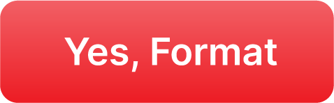

  1. With a microSD card inserted, tap the Maintenance screen’s Format microSD Card button button. Next, if you are sure it is OK to permanently delete all data on the inserted card, tap Yes Format Buttton when prompted to proceed.
  2. Wait for the status dialog to complete—do not adjust any controls or power off your Stadium device during the format process. Tap The OK button. when the dialog informs you that the format was completed successfully, and you are returned to the Maintenance screen.

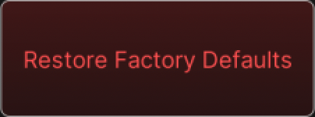

  1. Tap the Restore Factory Defaults button Restore Factory Defaults button .
  2. When prompted to reset to factory default settings, tap The OK button. .
  3. Wait for the quick reset process to complete—do not adjust any controls or power off your Stadium device during the process. Tap The OK button. when the dialog informs you that the reset is complete, and you are returned to the Maintenance screen.
