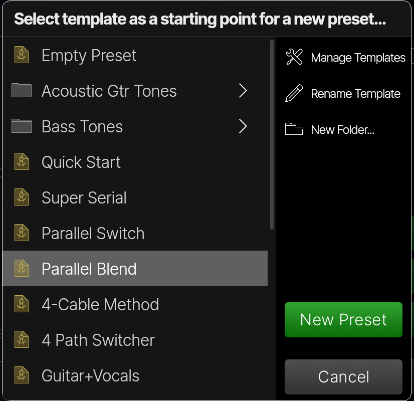

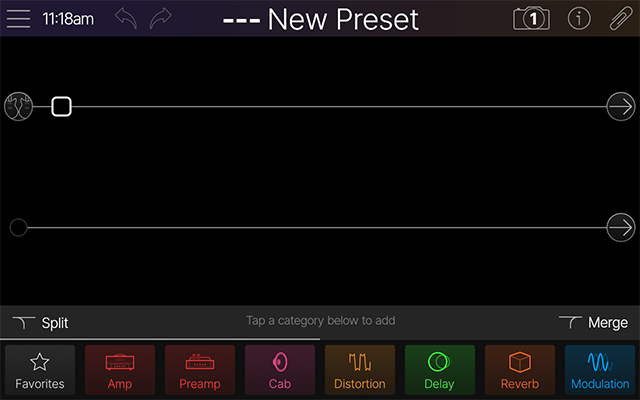

Creating a New Preset
  1. Tap Menu The main menu button in the upper left corner of the touchscreen and then tap New Preset The main menu's New Preset button . The Select Template window appears (below left).
  2. Tap the desired template from which you want to start your new preset. If you’re not sure, tap “Empty Preset.”
  3. Tap New Preset The New Preset button . A new preset is created based on the template you chose (below right).
The New Preset > Select Template window
An empty New Preset
An empty new preset
Tip: Alternatively, from the Preset List, double-tap on an “Empty” preset location to load an empty new preset.

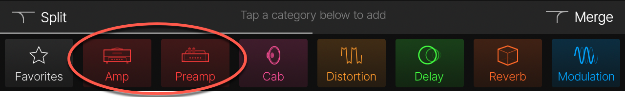

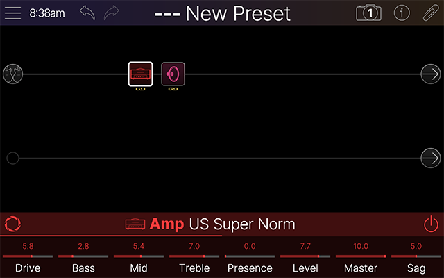

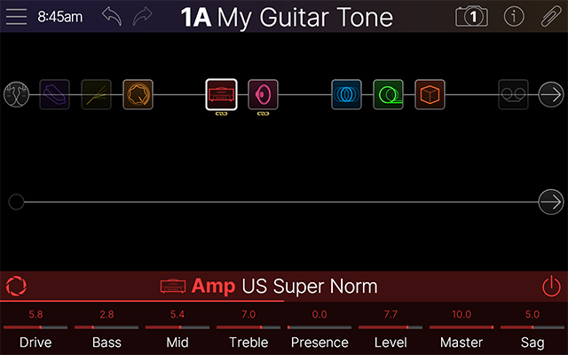

Item 01 Add an Amp and Cab
  1. From the Home screen, tap an empty location on Path 1A. Block categories appear in the inspector:
Quick block selector (None block selected on the Home > Edit screen)

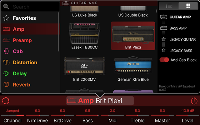

  1. Tap the Amp or Preamp button and double-tap on an Amp from the Model List. By default, the selected Amp and a matching Cab block are added—see Cabs and Cab IRs for details. You’ll see your blocks in the Home View - Edit screen.
The Model Browser showing the Amp - Guitar Amp model list
Selecting an Amp from the Model List
An amp and cab block are added to the New Preset
An Amp & matching Cab are added to the preset

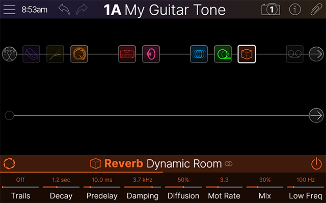

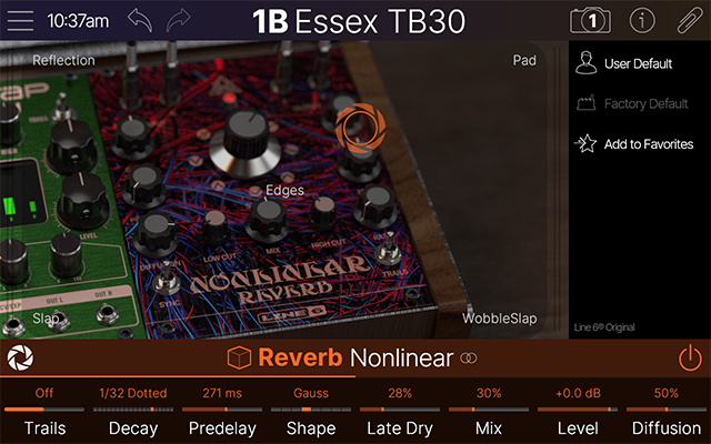

Selecting Blocks and Adjusting Parameters

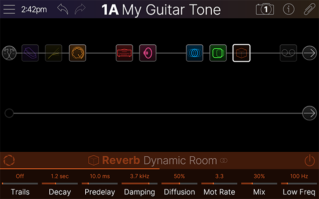

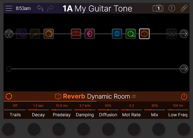

Item 01 Select a Block
From the Home > Edit screen, tap a block to select it. Alternatively, touch any assigned Stomp switch to instantly jump to its assigned item, or touch repeatedly to cycle through multiple items assigned to the switch. Selected blocks have a thicker white outline, and their parameters appear in the inspector below.
A reverb block is selected showing its parameters in the Inspector
A Reverb block is selected, and its parameters are shown in the Inspector
Note: The Inspector shows up to eight parameters at a time for the selected block. Many blocks include more than eight parameters, which are available on additional “pages” in the Inspector, as indicated by the line shown just above the parameters in the Inspector. Swipe the Inspector left/right to access additional parameter pages.
Item 2 Adjust a Block’s Parameters
There are a few ways to adjust parameters:
Use the Focus View
For any Amp, Preamp, or Effect model, tap the Focus View button FocusViewButton_Reverb.png at the top left of the Inspector to open the Focus View screen—see The Focus View section for details.
Editing a Reverb model using the Focus View

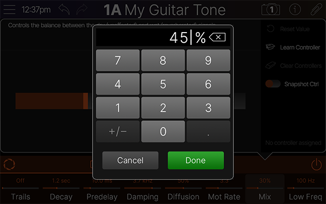

Use the Parameter Panel

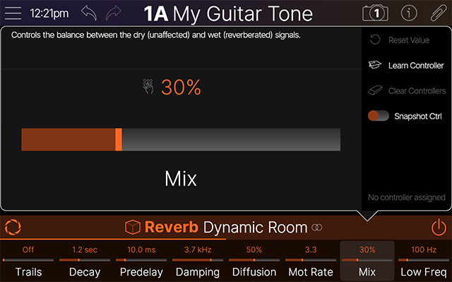

Tap once directly on a parameter in the Inspector to open the Parameter Panel. Here, you can read details about the parameter, and adjust its value by tapping and dragging the slider. Optionally, for numerical values, tap on the value in the panel, enter a precise value, and tap Done.
The Parameter Panel
The pop-up Parameter Panel (Reverb - Mix parameter selected)
Editing a numerical parameter value
Editing a numerical value
Use the Parameter Panel sidebar options for additional functions:
  • Reset Value: When this option is not dimmed, it means the parameter has been adjusted from its default value. Tap to reset it. (Or, reset a parameter by pressing its respective Knob 1~8 below the Inspector.)
  • Learn Controller: Tap “Learn” to create an assignment to an onboard or externally connected controller device, such as a footswitch, expression pedal, trigger, or MIDI. See the Learn Controller section for details.

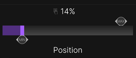

    • When the parameter includes a Controller assignment, adjustable Minimum and Maximum indicators appear on the slider (such as the “Heel” and “Toe” values when assigned to an expression pedal). Tap and drag these to adjust the Min and Max values.
Min and Max controller adjustment
  • Clear Controllers: Tap to clear all existing Controller assignments from the parameter.
  • Snapshot Control: When the switch is disabled (left position, the default setting), the parameter is excluded from Snapshot Control—meaning, its value is not stored and recalled with Snapshot changes. Toggle the switch as enabled (right position) if you want to be able to store up to eight different values to be recalled with Snapshots 1~8. You’ll see the parameter’s value appear in white and in brackets when the Snapshot Control is enabled for the parameter SnapshotEnabledValue.png . Note that you can alternatively press while turning the parameter’s respective Knob 1~8 to enable it for Snapshot Control. Also, see the Snapshots page.

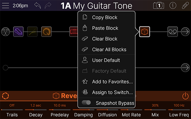

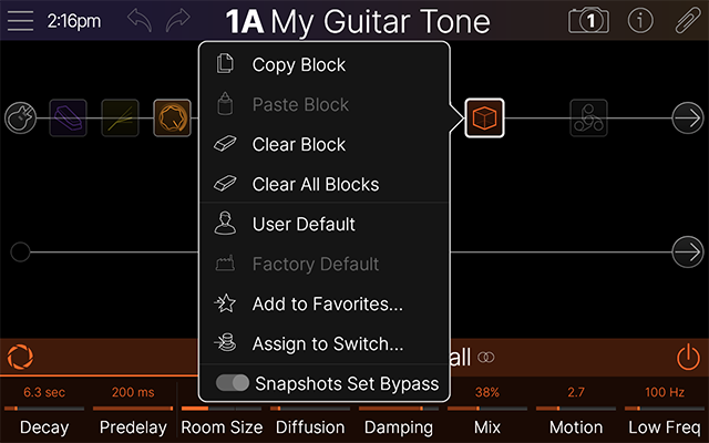

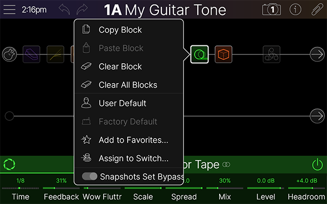

Item 3 Access a Block’s Action Panel
Tap once on the currently selected block or double-tap an unselected block to open its Action panel. The panel offers several commands and functions for the block, such as Copy, Paste, Clear, configuring User Default settings, and more, as covered in the following sections.
An effectn effectn effect block’s pop-up Action panel is displayed

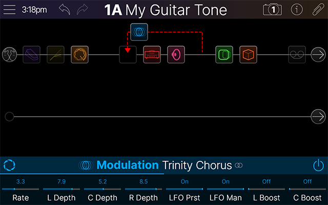

Moving Blocks
Experiment further with re-ordering blocks in the path or changing the path routing.
  • To move a block to a new position on its current path: Simply tap and drag any Amp, Cab, Effect, or Mix block left or right on the current path. Other blocks automatically move to create a new empty space for your block, allowing you to drop the block into the desired spot.
The Modulation block is shown being dragged to a new position on Path 1A
Dragging a Modulation block from post to pre position

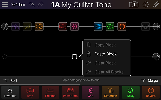

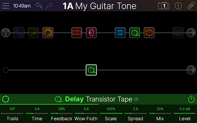

Copying and Pasting a Block
Blocks from one path can be copied and then pasted into the same path, the other path, or a path in an entirely different preset.

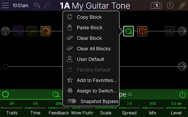

  1. Access a block’s Action Panel: Double-tap on the block (or, if the block is already selected, tap it once).
The Action panel for a Delay block is displayed
  1. Tap the Copy Block command.
  2. Select a destination: Double-tap on the desired empty block location to open the Action panel (as shown below left). The destination can be on any path within the current or a different preset. Then tap the Paste Block command. A copy of the block appears at the new location (shown below right).
    • The original block’s parameter settings, controller, and snapshot assignments are retained for the new copied block. Any existing bypass switch assignment is not retained on the pasted block.
The Action panel for an empty block location is displayed
A new instance of the Delay block is copied to Path 2A

  • Drag an individual block off screen: Tap and drag any block quickly toward the top or bottom edge of the Main Display. Once you see the red “Clear” indicator ClearBlockIndicator.png appear, release the block to clear it.
  • Use the Action panel to clear an individual block: Double-tap on a block to open the Action panel and select the Clear Block command.

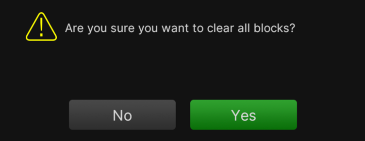

  • Use the Action panel to clear all blocks: Double-tap on any block to open the Action panel and select the Clear All Blocks command. A pop-up alert will ask you if you’re sure you want to clear all blocks.
The alert to clear all blocks
The alert to verify that you want to clear all blocks
When you tap Yes, all blocks on all paths are cleared, with the exception of existing Input and Output blocks, which remain with their current settings.
Important! Tapping the Undo button UndoButton.png at the top of the screen will restore a cleared block. However, once a block is cleared, its Bypass/Stomp/Controller Assignments are not restored via Undo.

Whenever you add a block to your tone and select a model, all the model’s parameters are loaded with a specific set of “Factory Default” values. If you find yourself constantly re-tweaking your commonly used models the same way, you can customize a model’s “User Default” settings to define its new defaults (excluding Input, Output, Split, or Merge Mixer blocks’ settings) so the model loads that way every time.
  1. Select any block and tweak it exactly how you like: Configure any of the model’s parameters and bypass state. (Existing MIDI, bypass, snapshot, and controller assignments are not saved with the User Default settings.)
  2. Tap the selected block again to open its Action panel: Select the User Default command. Your current parameter settings are now saved as the default for all future uses of the model. (Existing presets that already include the model are not affected.)
  • To return a model to its original Factory Default settings: Tap the selected block again to open its Action panel and select the Factory Default command to reset it for future uses of the model.

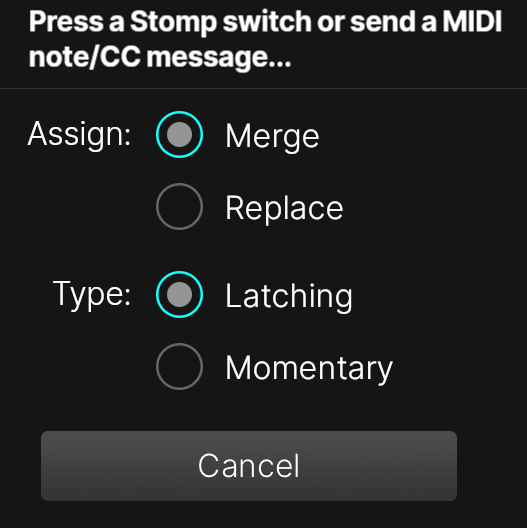

You can use the block's Action panel to quickly create, merge, or replace an existing block’s switch assignment(s). For complete details on creating assignments, please see the Bypass/Control Assignment section. To follow are steps for merging multiple assignments to one switch.
Merging Blocks' Switch Assignments
Instead of each block having its own Stomp switch assignment, you can “merge” their assignments to simultaneously toggle two or more blocks on/off.
  1. Double-tap on one of your blocks to open its Action panel and select the Assign to Switch command Assign To Switch command . The Assign to Switch dialog offers the options to do a quick Bypass assign to a Stomp switch, MIDI Note, or CC:
The Assign to Switch dialog - Merge and Latching options selected
  1. Select the Merge and Latching options, and then press the Stomp footswitch that is already assigned to another block to merge both blocks to the switch. You’ll see that the footswitch label has been changed to 'MULTIPLE (2)' to indicate that two blocks are assigned.
Tip: If you want to simultaneously toggle one block on and the other off, such as to switch between two different Distortion blocks, tap on one blocks Bypass button within the Inspector and set its bypass state is set opposite to the state of the other block.

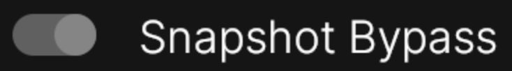

Using Snapshot Bypass
By default, the Action Panel’s Snapshot Bypass switch is enabled (in the right position Snapshot Bypass Switch - enabled ) for all effect blocks, allowing the Bypass state to be automatically recalled via snapshots. Toggle this switch to the left to disable snapshot control of the selected block’s bypass state.
