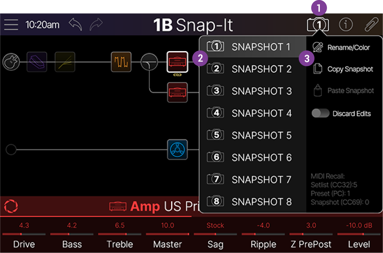

The Snapshot Panel
In the header, tap the Snapshot Snapshot camera icon button icon. The Snapshot panel appears:
The Snapshot Panel
Item 01 Snapshot Icon: Tap Snapshot camera icon button to open the Snapshot panel. The icon’s number indicates the currently loaded snapshot, and its camera outline color denotes whether Discard Edits is off (white) or on (red).
Item 2 Snapshots 1~8: Tap a snapshot in the panel to select it. Snapshots can also be selected from Snapshot Footswitch Mode.
Item 3 Sidebar: Tap an item in the sidebar:
  • Rename/Color: Customizes the selected snapshot’s name (Intro, Verse, Shred Solo, FX Off, etc.) and color. See Renaming and Coloring Snapshots.
  • Copy and Paste Snapshot: Instead of recreating all the settings of additional snapshots from scratch, copy one snapshot’s contents to a different snapshot and edit just the settings you want to change.
  • Discard Edits: Say you’re on Snapshot 2 (Verse), and you change a few things—switch a delay block on, switch a mod block off, tweak a distortion’s Drive parameter, etc. If you switch to Snapshot 3 (Chorus) and then back to Snapshot 2 for the second verse, should Helix Stadium recall those changes or return Snapshot 2 to its state when the preset was last saved? There’s no right answer; therefore, Stadium lets you choose:
    • Discard Edits OFF (default): The camera outline is white Snapshot camera icon button and any snapshot edits are remembered when jumping from snapshot to snapshot and appear as you last left them.
    • Discard Edits ON: The camera outline is red Snapshot camera button appears red when Discard Edits in enabled and any snapshot edits are discarded when jumping from snapshot to snapshot and appear as the preset was last saved. If you want to save changes made to a snapshot while Discard Edits is on, press SAVE twice before selecting another.
  • MIDI Recall: Displays the MIDI messages required to recall the current Setlist, Preset, and Snapshot. See MIDI.

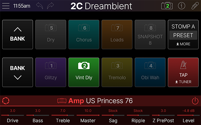

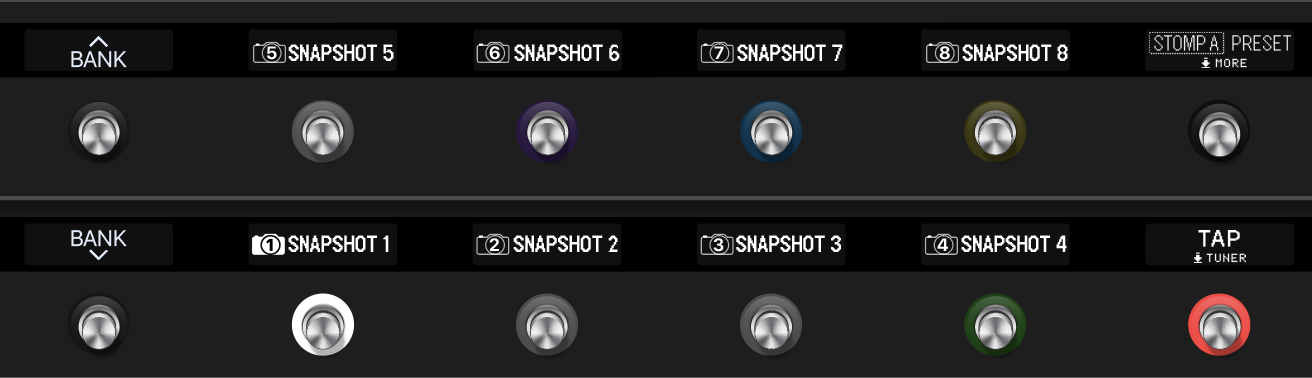

  1. From Preset or Combo Footswitch Mode, Press FS1 (Bank Up) and FS7 (Bank Down) together. Alternatively, press-hold FS6 (MODE) and then the SNAPSHOT switch. Snapshot mode appears (see below).
  2. Press one of the 8 snapshot switches to select a different snapshot. Alternatively, tap the Snapshot Snapshot camera icon button icon in the header and then tap the desired snapshot.
Helix Stadium XL’s Snapshot mode
Helix Stadium’s Snapshot mode (Home > Play view)
  • If you select a snapshot that hasn’t yet been configured, it appears the same as the snapshot you came from. As soon as you edit a new snapshot (say, by enabling or bypassing an amp or effect block), the snapshot becomes “active” and remembers any block bypass state and snapshot-assigned parameter values.
Note: If you want Snapshot footswitches to automatically jump back to the previous footswitch mode after selecting one, set Global Settings > Switches/Pedals > Snapshot Mode Return to “Automatic.”

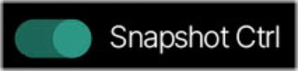

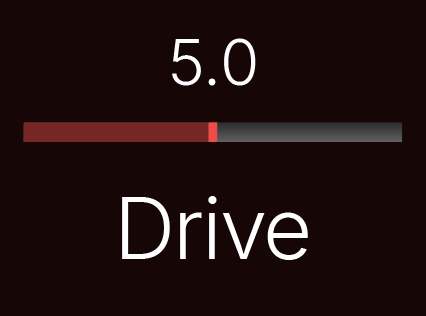

    • To adjust a Home > Edit screen’s block parameter AND have it automatically update per snapshot, press and turn the knob. Alternatively, tap the parameter to open the Parameter panel and then turn the Snapshot Ctrl toggle ON in the sidebar. The parameter’s value appears white (see below left).
    • To adjust a Command Center parameter AND have it automatically update per snapshot, press and turn the command’s parameter knob. Alternatively, tap the parameter to open the Parameter panel and then turn the Snapshot Ctrl toggle ON in the sidebar Snapshot Control enable-disable switch . The parameter’s value appears white (see below right).
Snapshot-enabled block parameter (white value text)

Note: To disable snapshot control of a parameter, tap the parameter to open the Parameter panel and tap the Snapshot Ctrl toggle OFF.

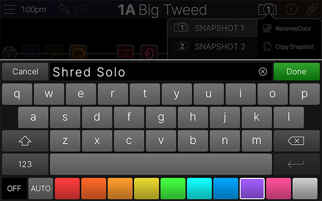

  1. From the Snapshot panel, tap Rename/Color The Rename - Color option in the sidebar.
Renaming a Snapshot
Snapshot panel > Rename/Color
  1. Type in your custom snapshot name.
  2. Optional: Tap one of the colors at the bottom of the screen to change the snapshot’s color; for example, The camera icon for a colored snapshot .

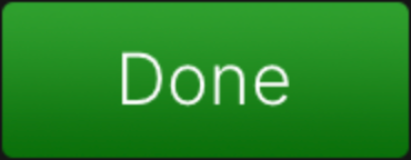

  3. When finished, tap The Done button .

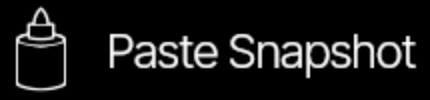

Copying/Pasting a Snapshot
Instead of creating a new snapshot from scratch, you may want to copy an existing one to another snapshot location and tweak just a few things.
  1. Select the snapshot you want to copy.
  2. From the Snapshot panel, tap Copy Snapshot CopySnapshot.png .
  3. Select the snapshot you want to overwrite and tap PasteSnapshot.png .
