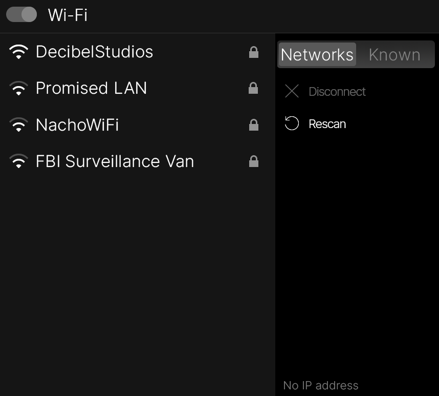

Tap the Main Menu button The Main Menu button and select Wi-Fi Wi-FiMenuButton.png to open the connection dialog.

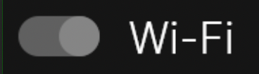

  1. If not already enabled, toggle the Wi-Fi switch Wi-Fi_Switch.png to its right position to scan for available Wi-Fi networks and select NetworksButton.png , as shown below.
Wi-Fi is enabled and has scanned and listed several available networks
  1. Tap on the Wi-Fi network you wish to join, type in your Wi-Fi password using the on-screen keyboard, and tap Join.

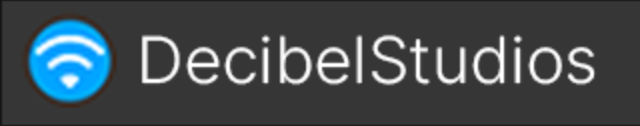

  2. You’ll be automatically connected; a blue Wi-Fi icon indicates the joined network JoinedWiFi.png .
    • The joined Wi-Fi network is remembered so that you’ll be automatically logged in and connected in the future when powering on Stadium if the network is within range.
    • When joined, the current IP address is listed at the bottom of the right sidebar for your reference. (This IP address for your Helix Stadium can be used for manually connecting with the Helix Stadium application, if necessary.)
    • To disconnect, select the current network and tap the sidebar’s Disconnect button. If desired, tap on a different Wi-Fi network in the list and repeat step 2.

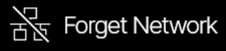

    • To disconnect and prevent a Known Wi-Fi network from being joined automatically, select the network within the Known list and tap Forget Network button . Alternatively, tap Forget All Networks button to forget all Known Wi-Fi networks.*
*Note: Once “forgotten,” a Wi-Fi network is removed from the Known button list—tap Rescan Network button to find it again, if necessary. You can rejoin the network manually by selecting it from the Networks list and repeating the above steps.

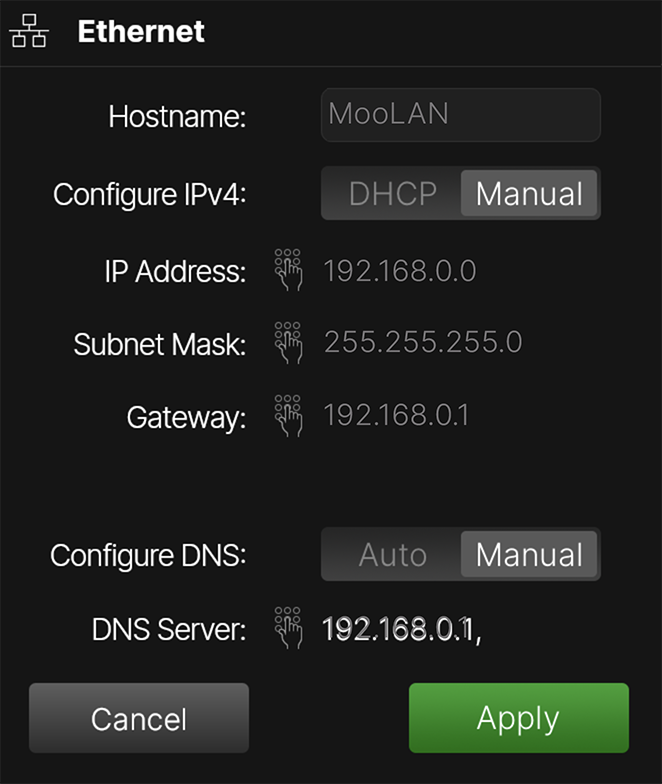

Manual Network Settings
If your network or router is configured for a “static” IP address, Subnet Mask, Gateway, and/or DNS Server, you can use the Ethernet connection and set these options manually. Note that you’ll need to obtain the necessary settings values from your router settings or from your network administrator.
  1. Tap the Main Menu button The Main Menu button and select Ethernet Ethernet Menu Button to open the configuration dialog.

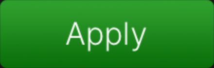

  2. In the Ethernet configuration dialog, tap the Manual Button button for the Configure IPv4 and/or Configure DNS, and tap the Edit button EditButton.png to enter the custom values. Tap Apply Button when settings are complete.
The Network Configuration dialog - Manual settings

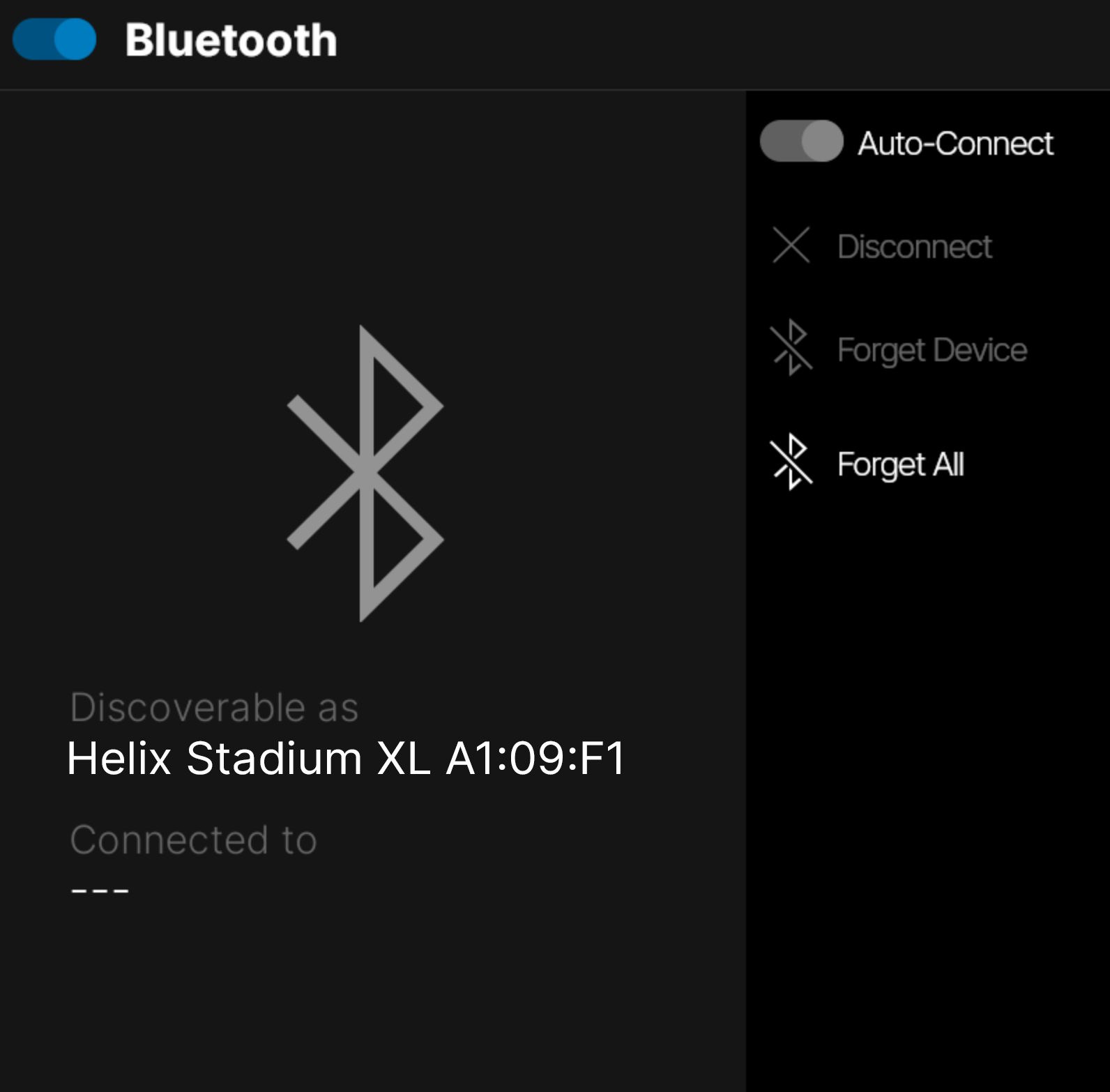

  1. Tap the Main Menu button The Main Menu button and select Bluetooth The Bluetooth Menu Button to open the Bluetooth connection dialog.
  • Set the Bluetooth switch to the right position BluetoothEnable.png to enable Bluetooth on Helix Stadium.
Enabling Bluetooth for Helix Stadium

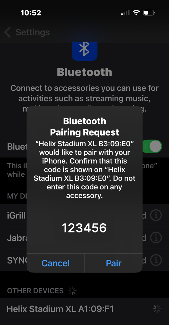

  1. Once enabled, Helix Stadium becomes discoverable as a Bluetooth receiver device by your mobile devices. Go into the Settings > Bluetooth screen on your mobile device and enable Bluetooth. Note that Stadium’s discoverability will time out in 30 seconds if you do not establish a Bluetooth connection.
  2. Your mobile device should automatically scan and find Helix Stadium, which will appear on your mobile device’s screen matching the “Discoverable as” number (XX:XX:XX) shown in Stadium’s Bluetooth connection dialog. Select Helix Stadium on your mobile device.

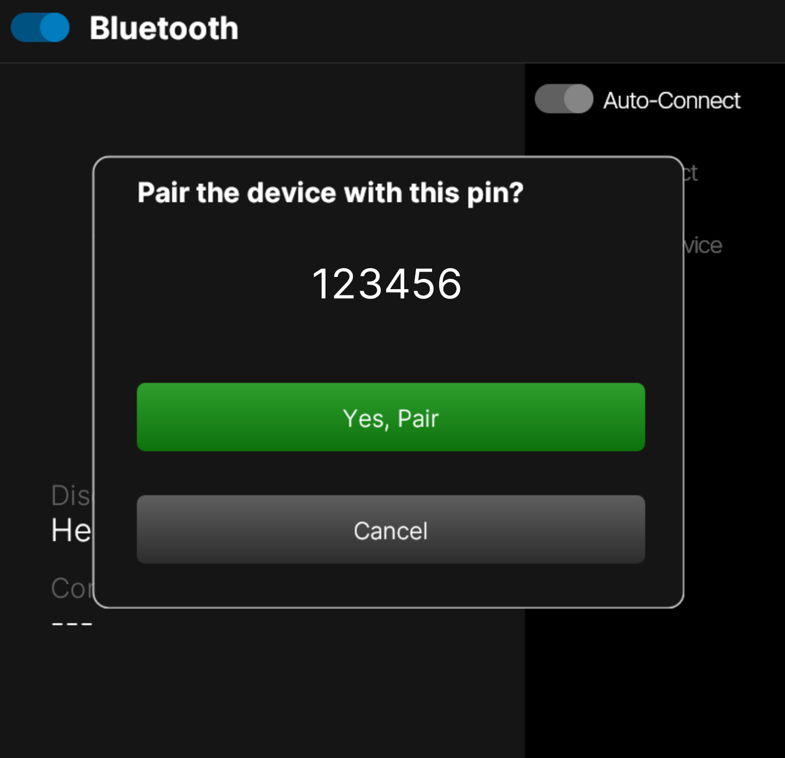

  3. Both your mobile device and Stadium will prompt you with a Pairing Request that displays a unique 6-digit PIN. Verify the 6-digit pin number matches within these prompts, select Pair on your mobile device, and tap Pairbutton.png on Stadium’s prompt to accept. For security, only allow pairing with a Bluetooth device that you recognize and only when the PIN number matches on both.*
Mobile device pairing - PIN prompt (Apple iPhone®)
Helix Stadium pairing - PIN prompt
*Note: This Bluetooth PIN number is a separate PIN from the one used for establishing network remote access from the Helix Stadium application to Helix Stadum. Please see Global Settings > Preferences > Remote Access for details.

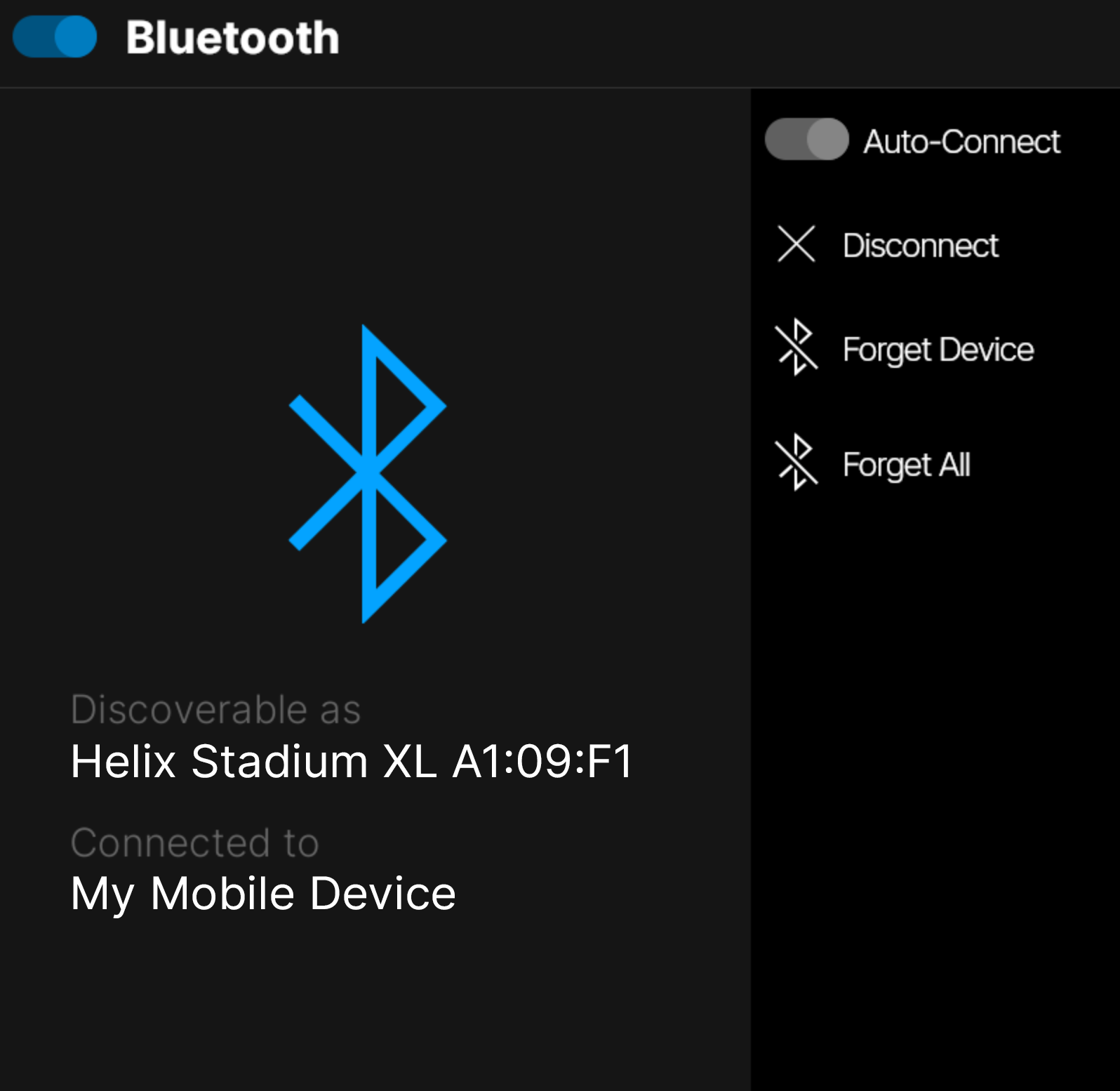

  1. Once pairing completes, you’ll see your mobile device listed in the “Connected to” field on the Stadium screen.
Bluetooth connection information
You can now start audio playback on your mobile device, and it will be received by Helix Stadium. Use the Bluetooth level fader in the Matrix Mixer to adjust the Bluetooth audio volume independently for each stereo output (1/4”, XLR, and Phones out).
Additional Bluetooth connection options are available in the window’s sidebar:

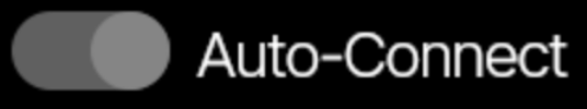

  • Auto-Connect: Enable AutoConnect.png to connect your mobile device for future use of Stadium automatically. Set the Auto-Connect switch to the right position to enable it.
  • Disconnect: Tap Disconnect.png to disconnect your device for now, but may want to connect it at another time.

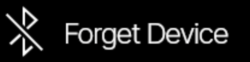

  • Forget Device: Tap ForgetDevice.png to disable the pairing between your current device and Stadium. If you use this option, you will need to repeat the preceding pairing steps to reconnect your device.

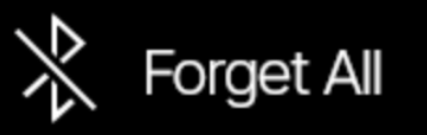

  • Forget All: Tap ForgetAll.png if you have multiple devices paired with Stadium and you wish to unpair from all.
