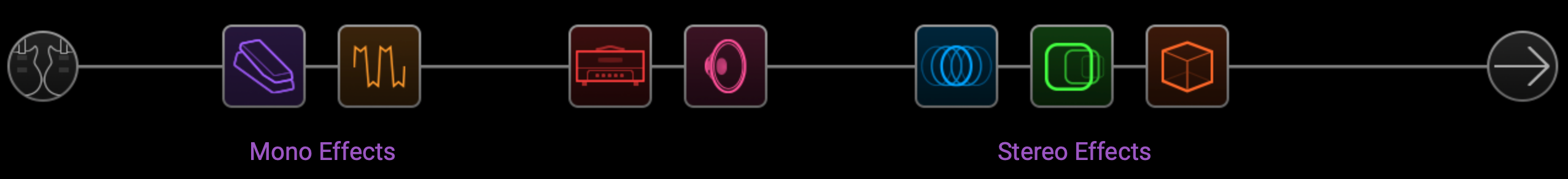

A simple tone using mono effects before the Amp and stereo effects after
  • Adding a mono effect block will collapse any preceding stereo signal on the same Path to mono. For example, adding a mono effect to the right of the Reverb in the above example would collapse the stereo Reverb block’s output to mono.

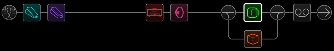

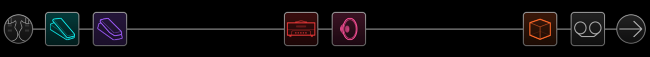

For many tones, a simple serial (one stereo path) signal flow is more than adequate. A single path accommodates up to 12 blocks. For example, a (mono) Volume pedal, Wah pedal, Amp, Cab, (and stereo) Reverb, and Looper can be added to a single Path, and many gigs or even entire tours have been successfully completed with less! Of course, there is still room (and typically enough DSP resources) for also adding Distortion, Modulation, and Delay, and additional effects on a single, serial Path.
A simple serial path tone

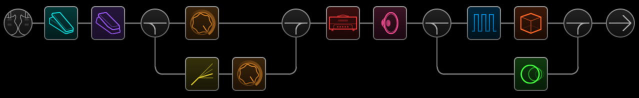

A split, parallel (two stereo Paths) signal flow can be used to create more sophisticated tones. This lets one split the signal into two stereo Paths, process them separately, and mix them back together. For this example, we’ll split our simple, serial Path tone to utilize a Reverb and Delay in parallel.
  1. Tap the existing Reverb block and drag it downward until you see a Path B (the lower Path) appear, then drop the Amp block on the new Path B to move it there. You’ll see that this automatically adds a Split and Merge block, allowing Path B to split off and rejoin Path A (the upper Path).
    • Once Split and Merge blocks are added, they can optionally be dragged left and right on Path A to be repositioned as desired.
A split, parallel Path is created, with a Reverb block moved to Path B

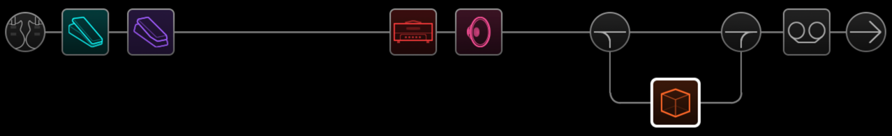

  1. Tap in Path A between the Split and Merge blocks and select a stereo Delay from the Model List to add it there. Now you have the stereo Delay and Reverb in parallel, where each processes the incoming Amp signal separately and is blended back together before being sent to the Looper and output.
A Delay is added to Path A
  1. Optionally, tap the Split block and change to a different Split type, and/or adjust its Balance for routing to each Path A and B. Likewise, tap the Merge block and adjust its Pan for how the Path A and B stereo signals are blended back together.

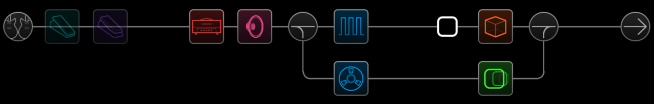

    • In this example, we’ve created one Split to use two different Distortions and a Dynamics block in parallel, then rejoined to go into an Amp and Cab, then into another Split to use Mod + Reverb and Delay blocks in parallel, rejoined to a common output.
Multiple split Paths are added

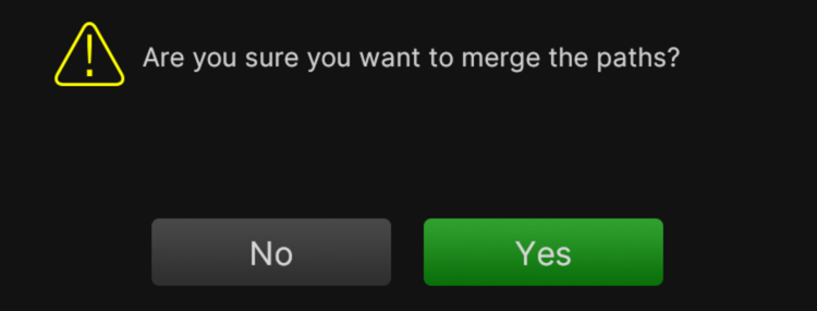

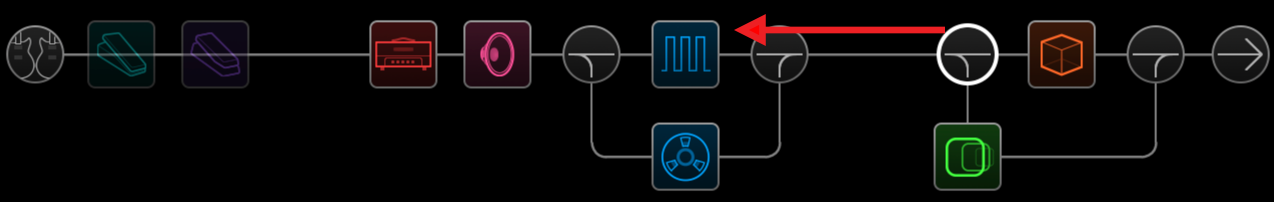

If you’ve created more than one Split, parallel path, you can optionally “merge” them into one parallel path by dragging and dropping the Split block of the latter onto a position within the earlier path. (Or, if you clear the Split block, it will merge with the preceding split path to its left.) When prompted, tap YES to confirm.
Drag the Split block of the latter parallel path to the left of the earlier Return block
Tap Yes to merge the paths
The two parallel paths are merged into one parallel path

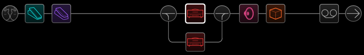

Use 2 Amp Blocks in Parallel
This allows you to use the Split and Merge parameters to blend just the right amount of each Amp. In this case, we’ve placed the Cab after the Merge block so that both amps' signals are fed to the same Cab (where you can use up to two Cab models or IRs and adjust their pan and other settings individually).
Two Amp blocks are configured in parallel and routed into a shared Cab block

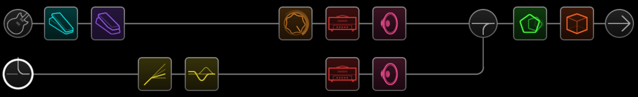

Create a 1 into 2 Routing

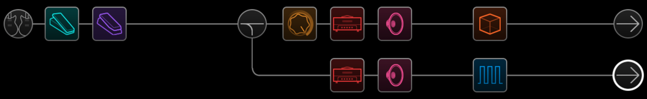

Add an Amp, Cab, and desired effects on Paths A and B, tap and drag the Merge block of an existing split Path downward to give Path B its own separate Output block. In the following example, your single source input enters a Volume and Wah, then is split into two completely separate Amp, Cab, and Effect chains, each with the ability to send to two different external outputs.
The input is routed to two separate Amp, Cab, and Effect chains with separate outputs

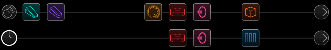

Create Two Independent Parallel Paths
Expanding on the previous configurations, you can drag both the Split and Merge blocks of an existing split Path down to Path B to create two independent parallel Paths. (Or, if you clear the existing Split and Merge blocks, they will convert to Path B Input and Output blocks, respectively.) This allows you to optionally set each Input block to a different source (Instrument, Mic, Return, etc.) and to individual Output block destinations.
The Split block is dragged down to create a separate Input block for Path B

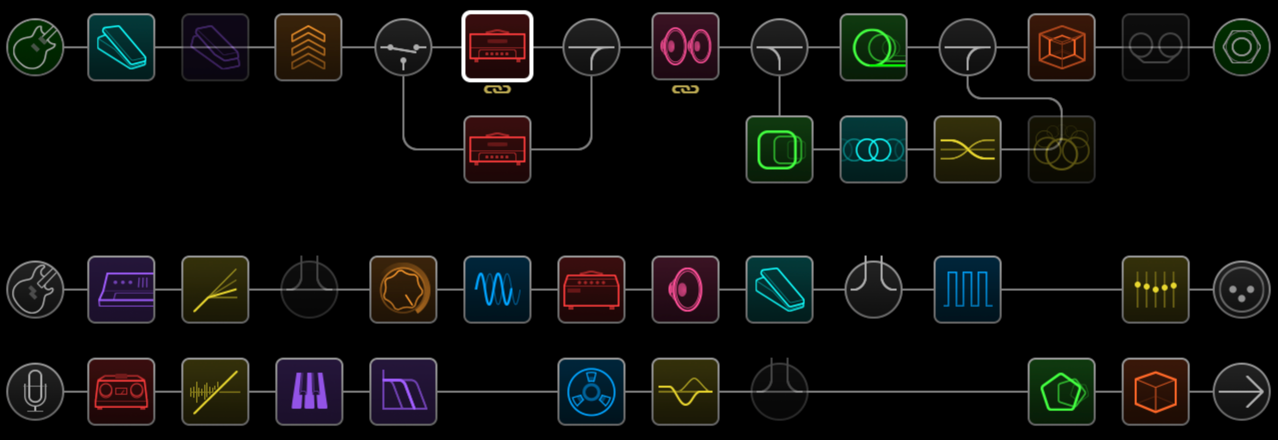

Another benefit of creating true parallel paths is that it provides up to 4 individual signal flows, each with its own input source. For example, the following configuration includes an Instrument 1 input on Path 1A for a guitar, an Instrument 2 input for a bass ( Helix Stadium XL only feature. Stadium XL only), and a Mic In Path 2A for vocals. With this setup, each input source has its own independent set of amp/preamp, effects, and output destination, which could serve as the heart of a live or recording rig all on its own.
Tip: Use the included “Gtr+Bass+Vox+Keys” template for a new preset, preconfigured with multiple input paths and blocks—see Creating A New Preset.
Three separate paths are configured, each with its own input, blocks, and output

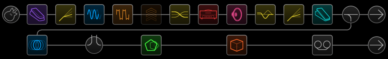

As mentioned at the start of this page, a single path offers 12 block locations. But if the 12 blocks are not enough, you can extend to path B to create a single, large “super serial” path, doubling the capacity to 24 block locations.
  1. Add a Split and Merge block to Path 1A.
  2. Tap and drag the Merge block down to Path 1B. A duplicate Output block is created.
  3. Move the Split block to the right so that it is the last processing block on Path 1A.
  4. Select the Output block on Path 1A and turn Knob 2 (Level) all the way down. That way, you’re only hearing Output 1B.
Now you can add up to 11 blocks on Path 1A (the Split block uses one block location) and up to 12 more blocks on Path 1B (DSP resources permitting).
A Super Serial Path, combining Path 1A and 1B

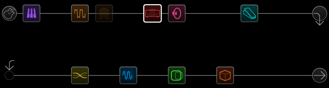

A very useful serial configuration is to add your “pre” Effects, Amp, and Cab on Path 1 and all “post” Effects on Path 2. This setup typically balances the DSP usage across the two Paths, allowing you to use many combinations of models on each before running out of available DSP.
In the following example, an Instrument input is fed into Path 1A’s Pitch Shifter, Distortion, Boost, Amp, Cab, and Volume pedal, with the Path 1 output set to Path 2A to be further processed by an EQ, Modulation, Delay, and Reverb, and to the Path 2A stereo output block.
Super Serial Path
A Serial configuration using Path 1A into 2A

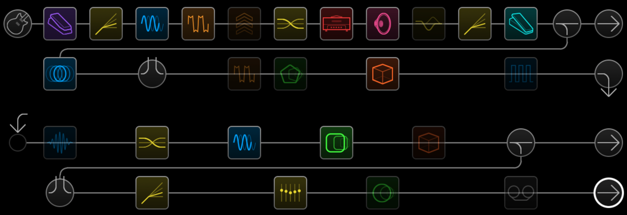

Of course, if this still isn’t enough, you could always duplicate the above Super Serial routing on both Paths 1 and 2 and route Path 1B’s output block to Path 2A for one gigantic serial tone with up to a whopping 48 block location capacity (DSP resources permitting).
Tip: Use the included “Super Serial” template for a new preset, preconfigured with combined paths and blocks—see Creating A New Preset.
A Super Serial configuration using all four paths
