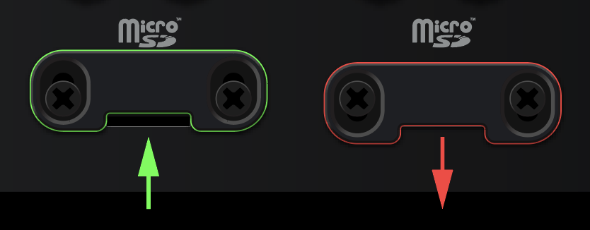

To access the microSD card slot:
  1. Using a smaller Philips head screwdriver, slightly loosen the two screws (but don’t remove them!) and slide the panel up toward the S/PDIF jacks (below left).
  2. To insert a microSD card, push the card in fully until it latches into place.
  3. To remove an inserted card, push the card in with your thumbnail and release; the card ejects a bit so you can grab and remove it from the slot. Re-tighten the screws while the panel is in either position—unlocked (up) or locked (down).
microSD card security panel unlocked (left) and locked (right)
Note: A formatted microSD card must be inserted before powering on Helix Stadium and kept inserted during use of the device for Showcase Song functionality.
