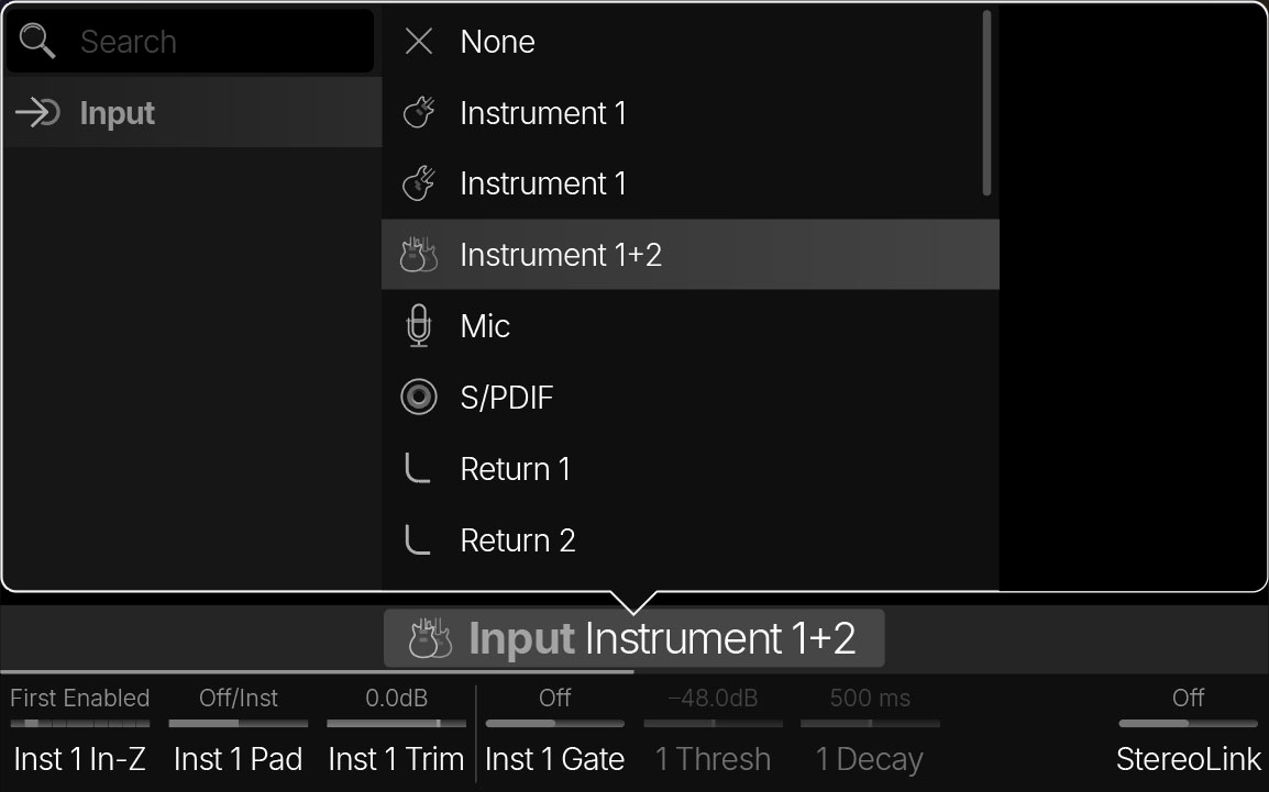

Input Blocks
By default, all presets, even “empty” New Presets, include at least one Input block (at the left of Path 1A), but each preset can have up to four Input blocks (one each for Path 1A, 1B, 2A, and 2B).
Selecting an Input
  1. From the Home > Edit screen, tap an existing Input block Block_IO_Inst1.png . The Input’s source appears in the inspector header; turn the Lower Knob to change the Output. Tap its name in the inspector header to open the Input List (below left).
  2. Alternatively, tap an empty Input block EmptyInputBock.png to select it. Available Inputs appear in the inspector (below right).
Model List > Input
Quick input selector (None input block selected on the Home > Edit screen)
Tip: Within an empty New Preset, only the main Path 1A and Path 2A are shown. You can also create Paths 1B and 2B as parallel paths, each with its own Input block. See Serial vs. Parallel Path Routing.
Input
Description
None
Disables (mutes) the input block on that path.
Helix Stadium XL Only feature. Instrument 1, Instrument 2, Instrument 1+2
Helix Stadium XL Helix Stadium XL Only feature. has separate Instrument 1 and Instrument 2 inputs. Helix Stadium has a single Instrument input. Connect your guitar, bass, electric violin, electric nose flute, etc.
Instrument 1+2 receives the signal from both jacks simultaneously. Note that Instrument 1+2 offers independent parameters, which allow you to connect either two separate instruments or to enable StereoLink for connecting one stereo instrument.
Mic
Receives the signal from the XLR Mic In jack. Overall mic gain is adjusted from Global Settings > Ins/Outs > Mic In Gain.
Note: 48V phantom power may be required for some studio microphones and can be enabled from Global Settings > Ins/Outs > Mic In Phantom.
S/PDIF
Receives the signal from the stereo S/PDIF digital input, where you can connect the S/PDIF output from external gear to route its digital signal into Helix Stadium. Set the Global Settings > Ins/Outs > S/PDIF Sample Rate to match that of your source’s S/PDIF sample rate.
NOTE: Only one digital Input can be used in a preset at the same time.
Return 1, Return 2, Return 1-2
Helix Stadium XL Only feature. Return 3, Return 4, Return 3/4
Returns 1 and 2 (and with Stadium XL Helix Stadium XL Only feature. , Return 3 and 4) can act as additional mono input blocks. Returns 1/2 (and with Stadium XL Helix Stadium XL Only feature. , Return 3/4) can act as additional stereo input blocks for processing keyboards, drum machines, or even other multieffects. If a Return or FX Loop processing block exists in the preset, the utilized Return input will be grayed out and unavailable. See FX Loop, Send, and Return Blocks below.
Note: Returns 1/2 (Helix Stadium) or Returns 3/4 (Helix Stadium XL Helix Stadium XL Only feature. ) can be repurposed (via Global Settings > Ins/Outs > Return 1/2 [3/4] Type) as an always-on Aux In for monitoring a Front Of House feed, media player, or stage mixer.
USB 3/4, USB 5/6, USB 7/8
USB inputs 3/4, 5/6, and 7/8 can all be used for stereo USB audio inputs for your connected computer’s DAW software. See USB Audio.
Helix Stadium also receives input from USB 1/2, but it’s dedicated to monitoring stereo USB audio from your computer, with the USB 1/2 input unprocessed by any of the current preset’s processing blocks. As such, USB 1/2 is not available as a selectable Input block source.

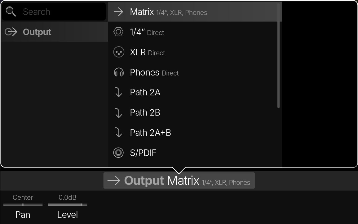

Output Blocks
Each preset can have up to four Output blocks (one each for Path 1A, 1B, 2A, and 2B).
By default, Output blocks are set to Matrix (1/4”, XLR, Phones), which means paths are routed to Helix Stadium’s Matrix Mixer, where they can be mixed differently for the 1/4”, XLR, and Phones outputs. Alternatively, they can be routed directly to a single stereo output (including 1/4”, XLR, or Phones), bypassing the Matrix Mixer.
Selecting an Output
  1. From the Home screen, tap an Output block. The Output appears in the inspector. Turn the Lower Knob to change the Output.
  2. Alternatively, tap its name in the inspector header to open the Output List (see below).
Model List > Output
Tip: With an empty New Preset, only the main Path 1A and Path 2A are shown. You can also create Paths 1B and 2B as parallel paths, each with its own Output block. See Serial vs. Parallel Path Routing.
Output
Description
The path is sent to the Matrix Mixer, where it can be mixed independently for the 1/4”, XLR, and Phones outputs. Even if you don’t use the Matrix Mixer, this is still the best option, as it lets you hear the path through all three main outputs simultaneously.
The Output blocks of all Factory Presets (and most Preset Templates) are set to Matrix (1/4”, XLR, Phones) by default.
1/4" Direct
The path is routed directly to the 1/4” outputs, bypassing the Matrix Mixer entirely.
XLR Direct
The path is routed directly to the XLR outputs, bypassing the Matrix Mixer entirely.
Phones Direct
The path is routed directly to the Phones output, bypassing the Matrix Mixer entirely.
Path 2A, 2B, or 2A+B
These Outputs only appear for Path 1A and Path 1B Output blocks and are used to route Path 1 into Path 2. This type of “serial” routing provides an extended signal path where more blocks can be added. See Serial vs. Parallel Path Routing.
S/PDIF
If Global Settings > Ins/Outs > S/DPIF Out is set to “Direct Out,” the Output is routed directly to the S/PDIF digital output. However, the S/PDIF Out can also be set to reflect the Matrix Mixer’s 1/4”, XLR, or Phones output.
This output’s level and sample rate can be set using Global Settings > Ins/Outs > S/PDIF Out Level and S/PDIF Sample Rate.
Note: Set your receiving device and Helix Stadium to the same S/PDIF sample rate. Your receiving device should also be set to follow Helix Stadium as the “master” S/PDIF device.
Send 1/2
Helix Stadium XL Only feature. Send 3/4
The path is routed directly to Send 1/2 (and/or on Helix Stadium XL Helix Stadium XL Only feature. , Send 3/4) in stereo. Sends can act as additional device outputs, added anywhere in your preset’s signal path. See FX Loop, Send, and Return Blocks for details.
USB 1/2, USB 3/4, USB 5/6
The path is routed directly out USB 1/2, 3/4, or 5/6 in stereo, for routing signals to your computer or mobile devices.
USB Outs 7 and 8 are dedicated for DI recording output, and are not available as an Output block. See USB Audio.

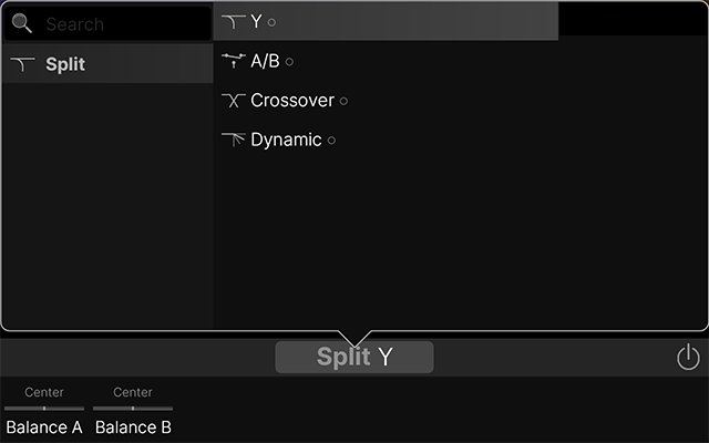

Split and Merge Blocks
Split and Merge blocks can be added to create parallel or dual paths, which can be very useful for isolating specific effects, creating alternate switchable routings, and more. See Serial vs. Parallel Path Routing.
All paths are stereo. When a Split block is added, it splits the signal into Path A and Path B in parallel. When a Merge > Mixer block is added, it mixes Path B back into Path A.
Note: The overall output level of the signal is increased slightly for each parallel path added. Adjust the Level parameter in the Merge > Mixer block for the desired output level.
Block_SplitY.png Adding a Split Block
  1. Tap an empty area on Path 1A or Path 2A.
  2. Tap Split on the left side of the inspector header. A Split > Y block is added, and a Path B is created with its own Output block. Alternatively, drag an existing Amp, Cab, or Effect block down slightly, and it’ll be added to a new parallel path B connecting to Path A with Split > Y and Merge blocks.
  3. To change the type of Split, turn the Lower Knob or tap the inspector header to open the Split List (see below):
The Split block menu list
Model List > Split
  • Adding a Split to the left of an existing Merge block on path A automatically joins the existing parallel path.
  • Multiple Split and Merge > Mixer blocks can be added to Path A for several parallel paths, one after the other. For example, say you want the signal to split into parallel Amp blocks, merge into a dual Cab block, and later, split into parallel Delay and Reverb blocks, and then merge again before the Output. There’s a lot of flexibility here.
  • To create a Path B Input block, drag the Split down to Path B—or—clear the Split by swiping it off the screen.
Block_SplitY.png Split > Y
Adding a Split block adds a Split > Y by default. With a Split > Y block, the stereo input signal is sent to stereo Paths A (upper) and B (lower) evenly, but the Balance A and Balance B parameters can be used to separate the incoming signal into separate left (to Path A) and right (to Path B) channels.
Parameter
Description
Balance A
Adjusts the stereo balance (pan) of the signal sent to Path A (upper) and Path B (lower). To split the signal into separate left and right channels, set Balance A to Left 100 and Balance B to Right 100.

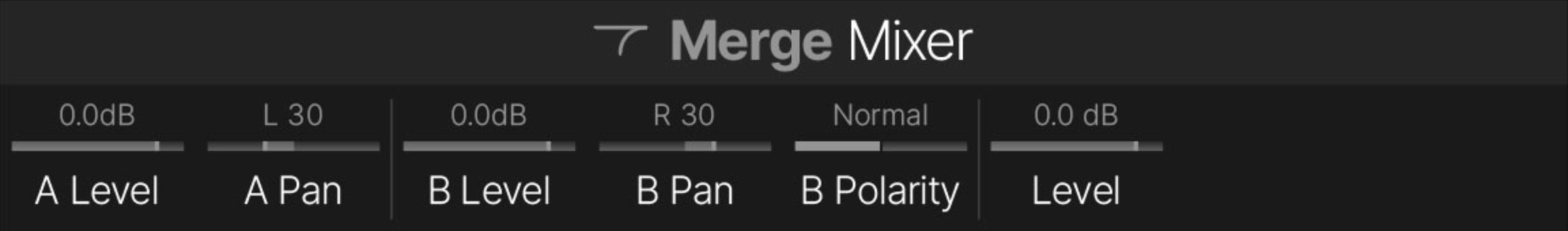

Block_Merge.png Merge > Mixer
Parameter
Description
A Level
Adjusts the output level of Path A (upper).
A Pan
Adjusts the left/right stereo balance of Path A (upper). When set to Left 100, only the left signal is passed through; when set to Right 100, only the right signal is passed through.
B Level
Adjusts the output level of Path B (lower).
B Pan
Adjusts the left/right stereo balance of Path B (lower). When set to Left 100, only the left signal is passed through; when set to Right 100, only the right signal is passed through.
B Polarity
Inverts the polarity of Path B. Typically, this should be set to “Normal.”
Level
Adjusts the overall output level of the Merge block.

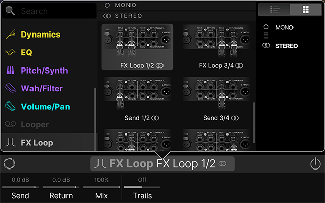

An FX Loop block combines a Send and Return (either mono or stereo) to let you patch your favorite external effects pedals (or rack gear) into your preset’s signal flow. The FX Loop block category also has separate Send and Return blocks (mono or stereo) that let you route out to—or in from—external gear in the middle of a signal path.
Note: Multiple instances of the same Send can be used more than once in a preset. However, only one instance of the same FX Loop or Return can be used in a preset.

FX Loop block Adding an FX Loop Block
  1. From the Home > Edit screen, tap an empty area on a path where you want to add an FX Loop block. Categories appear in the inspector.
  2. Press [>] (or swipe the category buttons) and tap the FX Loop category button. The Model List opens (see below).
  3. Tap the desired item to load it. Alternatively, double-tap the desired item to load it and close the Model List.
Model List > FX Loop
Note: The FX Loops' input and output level can be changed globally from Global Settings > Ins/Outs > FX Loop [X] Level. An FX Loop block’s Send and Return level can further be adjusted individually within your preset using the FX Loop’s Send and Return parameters, as shown in the following tables.
FX Loop block FX Loop > FX Loop
Parameter
Description
Send
Adjusts the level of the FX Loop’s Send output(s). 0.0 dB is unity gain.
Return
Adjusts the level of the FX Loop’s Return input(s). 0.0 dB is unity gain.
Mix
Blends the FX Loop signal vs. the dry signal passed through the FX Loop block. When set to 0%, the path bypasses the FX Loop completely. When set to 100%, the entire signal is fed through the FX Loop, and no dry-through signal is heard. (This means that if you don’t currently have your external gear connected to the Send & Return jacks, you won’t hear any output signal unless you bypass the FX Loop block!)
When connecting time-based pedals like delays or reverbs, it’s best to leave the pedal’s Mix at 100% and control the amount of the pedal’s effect from the FX Loop block’s Mix knob. This helps minimize phase issues and latency. For pedals like distortion, fuzz, or compression, it’s common to keep the FX Loop block’s Mix knob at 100%, but lowering this value can sometimes provide cool parallel effect sounds.
Trails
When Off, the return signal from any external gear is instantly muted when the FX Loop block is bypassed. When On, the return signal continues to decay naturally when the block is bypassed, or a different snapshot is selected.
Send block FX Loop > Send
Parameter
Description
Send
Adjusts the level of the Send’s output(s). 0.0 dB is unity gain.
Dry Thru
Adjusts the level of the dry (unaffected) signal passed through the Send block, independent of the Knob 1 (Send) level. Normally, this should be set to 0.0dB, but when set to -120.0 dB, the Send block can act as an A/B switch, toggling between sending signal to the external device (block enabled) and sending signal through to the next block (block bypassed).
Return block FX Loop > Return
Parameter
Description
Return
Adjusts the level of the Return’s input(s). 0.0 dB is unity gain.
Mix
Adjusts the balance between the Return signal and the dry signal passed through the Return block. When set to 0%, the path bypasses the Return completely. When set to 100%, the entire signal is fed from the Return, and no dry signal is heard.
