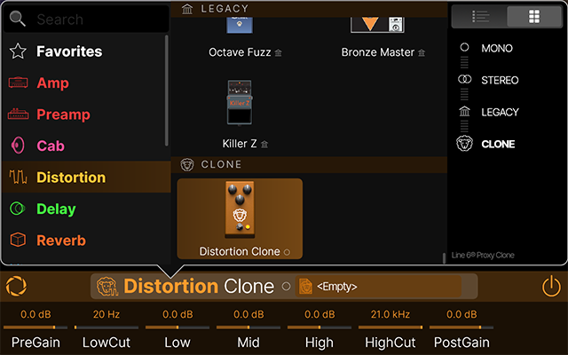

Boosts, Overdrives, Distortions, Fuzzes, and other forms of dirt. Using the Stadium Proxy feature (firmware v1.3 and later), you can create Clones of your own distortion pedals. Once one or more Distortion Clones are created, they are available within the Distortion category of the Model List, as shown below. Please see the following Clones page for additional details.
Selecting a Distortion Clone
Once you’ve created one or more Distortion Clones, tap the Distortion category button in the Inspector Button_Distortion.png to open its Model List, and select the CLONE subcategory within the sidebar to the block to your preset (shown below). Then tap on the “Empty” Clone file box at the top of the Inspector to open the Distortion - Clone file browser, where you can audition and load a Clone file. Please see the Selecting & Managing Clones page for additional details.
The Model List > Distortion > Clone subcategory is selected
