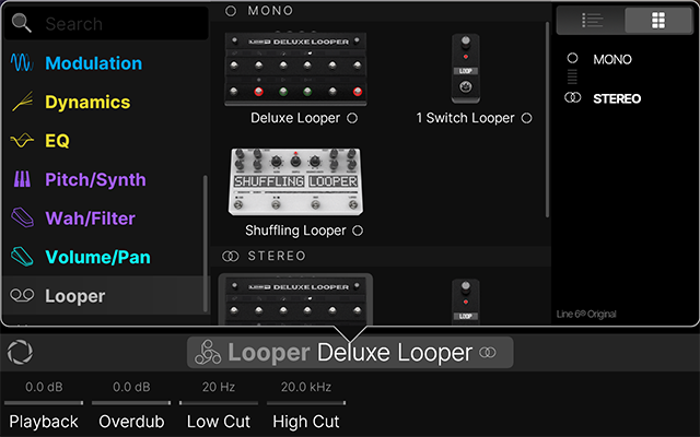

Adding a Looper Block
  1. From the Home > Edit screen, tap an empty area on a path where you want to add the Looper block. Categories appear in the inspector.
  2. Press [>] (or swipe the category buttons) and tap the Looper category button. The Model List opens (see below).
  3. Tap the desired item to load it. Alternatively, double-tap the desired item to load it and close the Model List.
Model List > Looper
Note that Looper types are available as Mono or Stereo, selectable in the right sidebar. If stereo loop playback is not required, or if you’ll be placing mono blocks after the Looper in your signal flow, it is best to choose a mono Looper. Once the Looper block is added, a Stomp mode footswitch assignment is created to access the Looper (also see Footswitch Modes).
Please take a look at the section below for details on each Looper model type.

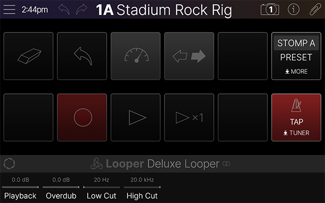

Deluxe Looper Footswitch Mode
  1. From Stomp A or Stomp B footswitch mode, press the Deluxe Looper switch. Deluxe Looper Footswitch mode appears (see below).
If no loop has yet been recorded (or the loop has been cleared), the device’s switch LED rings appear dark and its footswitch labels are dimmed. The Speed and Reverse switches can be "pre-engaged" prior to recording your loop if desired.
Helix Stadium XL’s Deluxe Looper footswitch mode*
*Note: On Helix Stadium XL Helix Stadium XL only , the Looper footswitch labels appear on the scribble strips when the Deluxe Looper block is enabled. On Helix Stadium, Deluxe Looper footswitch labels appear on Home > Play view (see below).
Helix Stadium Play View > Deluxe Looper footswitch mode
Click to display the list of Deluxe Looper footswitch functions...
Function
Description
FS1 (Clear)
Press to instantly clear the loop from memory, whether it’s currently recording, playing, or stopped.
FS2 (Undo/Redo)
Press to undo the most recent overdub pass. Once the switch is released, the function changes to Redo.
Press again to restore the last cleared overdub pass. The function changes to Undo again.
FS3 (Speed)
Press to toggle between Full Speed and Half Speed.
If Half Speed is engaged before or during loop recording, pressing FS3 again will double the speed. The speed also affects the pitch of the loop playback. Playing a Half Speed-recorded loop at Full Speed raises its pitch one octave, while playing a Full Speed-recorded loop at Half Speed lowers it one octave.
FS4 (Reverse)
Press to toggle loop playback between forward and reverse.
FS8 (Record/Overdub)
If a loop is not playing, press FS8 to record a new loop. The switch’s LED turns bright red.
If a loop is playing, press FS8 again to overdub. The switch’s LED turns bright orange. Overdubbing records your input signal as a new part, without removing the existing loop. If you remain actively overdubbing, a new, additional Overdub layer is recorded every time the loop playback cycles.
FS9 (Play/Stop)
Press to start loop playback. Press again to stop playback.
FS10 (Play x1)
Press to start loop playback. Playback continues until the end of the loop and automatically stops.
Tip: Press FS10 rapidly and repeatedly for a “stuttering” playback effect!
