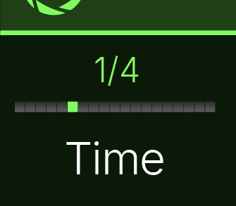

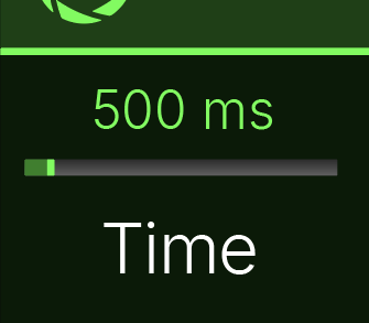

  1. Press the TAP/TUNER switch repeatedly to set the system tempo in BPM (Beats Per Minute). While tapping, the tempo appears in FS12’s scribble strip (Stadium XL The Stadium XL Only icon only) or Home > Play view. Certain Delay and Modulation parameters, such as Time and Speed, can be represented with fixed numeric values (ms or Hz) or note values (1/4 note, dotted 1/8 note, etc.). When set to note values, the parameter follows Tap Tempo, Song Tempo, or incoming MIDI clock.
  2. Press a Time, Speed, or Rate parameter knob to toggle between ms or Hz (below left) and note values (below right).
Time set to ms
Time set to note value

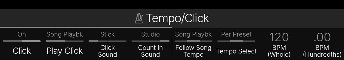

Touch (but don’t press) FS12 (TAP/Tuner). The Tempo/Click panel briefly appears:
Tempo/Click panel

Parameter
Description
Click
Turns the click (metronome) on and off.
Play Click
Determines when the click (metronome) is heard.
  • Song Playbk: The click (when on) is only heard during song playback.
  • Always: The click (when on) is always heard.
Click Sound
Selects the type of Click sound.
Count In Sound*
Selects the type of sound used for the Count In, which is heard before the start of a song and/or marker.
*Note: The Count In function is not currently functional—it is to be implemented in an upcoming firmware update.
Follow Song Tempo
Determines if and when time-based blocks (like Delays and Mods) follow the current song’s tempo.
  • Never: Time-based blocks completely ignore song tempo.
  • Song Playbk: Time-based blocks only follow the current song tempo while the song is playing.
  • Always: Time-based blocks always follow the current song tempo, even when the song is not playing.

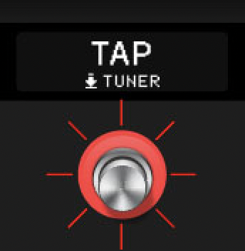

When Tempo is using the Tap Tempo, FS12 TAP TEMPO LED flashes red:
Tap Tempo

Tempo Select
Determines whether the system tempo is stored and recalled with each snapshot, recalled with each preset, or applied globally across all presets and snapshots.
BPM [Whole]
Sets the system tempo. Turning Knob 7 (BPM [Whole]) resets Knob 8 (BPM [Hundredths]) to .00.
BPM [Hundredths]
Receive MIDI Clock
Determines whether Stadium responds to the incoming MIDI Clock received at its MIDI IN port, via USB, or whichever it senses first (“Auto”). If you want Stadium to completely ignore MIDI clock, set this to “Off.”
The TAP switch LED flashes blue when synced to incoming MIDI Clock.
Send MIDI Clock
Determines from which outputs (if any) Helix Stadium transmits MIDI Clock.

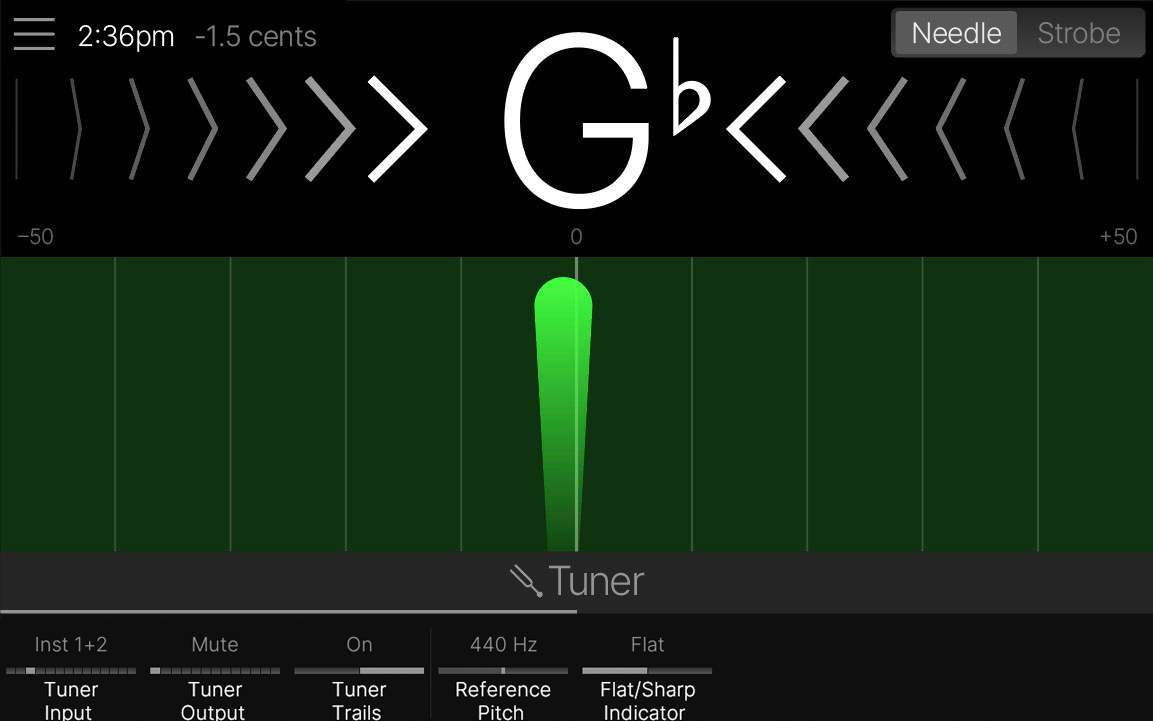

    • The Tuner Needle Button Needle: A vertical needle moves left (flat) or right (sharp) to indicate the pitch of your instrument. The needle, flat/sharp arrow indicators, and background change colors to show how far the string is from the target pitch. The display offers a range of ±50 cents. When the needle centers and the background lights green, your string is in tune.

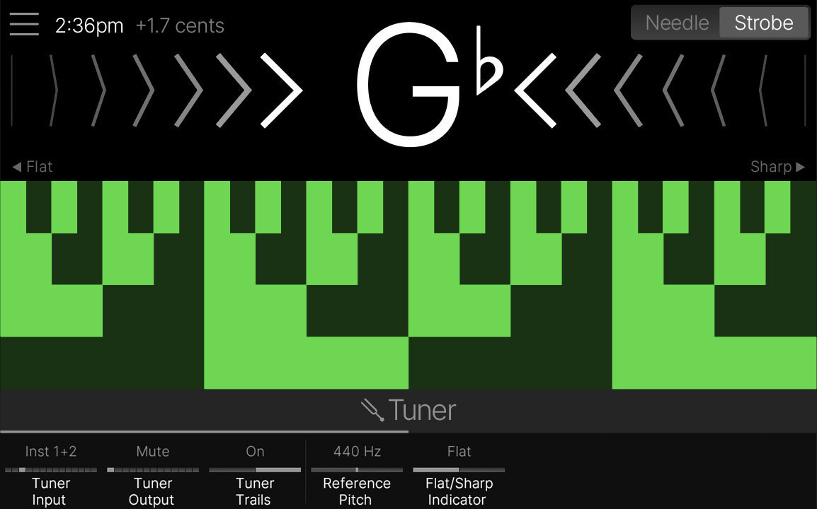

    • The Tuner Strobe Button Strobe: A checkered background moves left (flat) or right (sharp) to indicate the pitch of your source instrument. The strobe background changes colors to indicate how far the string is from the target pitch. When the strobe background stops moving, your string is in tune.
    • The Cents indicator at the top left of the screen provides a real-time, numerical measurement of your string's pitch relative to the target pitch.
Tuner > Needle mode
Tuner > Strobe mode
