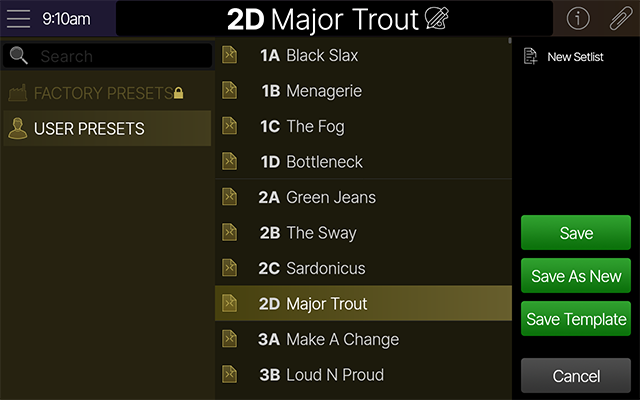

Saving an existing preset to the User Presets folder
Item 01 The Preset Save Screen - Saving an existing preset

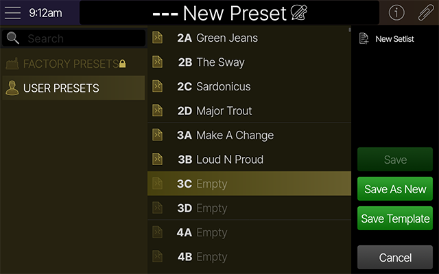

Saving a new preset to an empty User Presets folder location
Item 2 The Preset Save Screen - Saving a new preset to an empty location

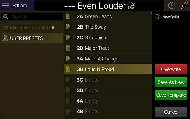

Item 3 The Preset Save window - Saving a new preset to a different, occupied User Preset location

  1. Press the Save button The hardware Save button . The Preset Save screen appears (see below).
Save Preset screen
  1. To rename the preset, tap the large preset name in the header Preset-Rename.png . A keyboard appears. Enter the name and tap The Done button .
  2. Choose a setlist and preset location in which to save your preset:
    • If the preset has already been saved, choosing the same location displays The Save button in the sidebar.
    • If the preset has not yet been saved, or an empty location is selected, Save is grayed out. In this case, you must choose The Save As New button instead.
    • If the location already contains a different preset, the Save button changes to The Save - Overwrite button .
  3. Tap one of the colored boxes in the sidebar:
    • To simply save any changes made to the current preset, tap The Save button . This is the same as pressing the Save button The hardware Save button twice (or pressing FS4 [Quick Save] from More footswitch mode).
    • To overwrite an existing preset, select the preset to be overwritten and tap The Save - Overwrite button . A dialog box appears, warning you that the destination preset will be permanently deleted (along with any of its aliases in other setlists). If you’re okay with this, tap Yes, Overwrite.
    • To save your preset as a new, unique preset, tap The Save As New button . A keyboard appears. Enter the name and tap The Done button .
    • To save your preset as a template, tap SaveTemplateButton.png . See Saving a Template below.

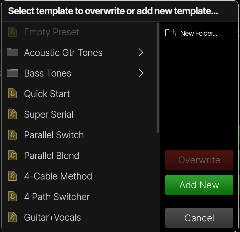

  2. In the sidebar, tap Save Template SaveTemplateButton.png . The Save Template window appears (see below).
  1. To add a template folder, tap NewFolderButton.png in the sidebar. A keyboard appears. Enter the name and tap The Done button .
  2. Tap one of the colored boxes in the sidebar:
    • To save as a new template, tap The Add New button . A keyboard appears. Enter the name and tap The Done button .
    • To replace an existing template, select the template you wish to replace and tap The Save - Overwrite button . A dialog box appears, warning you that the destination template will be permanently deleted. If you’re okay with this, tap Yes, Overwrite.
