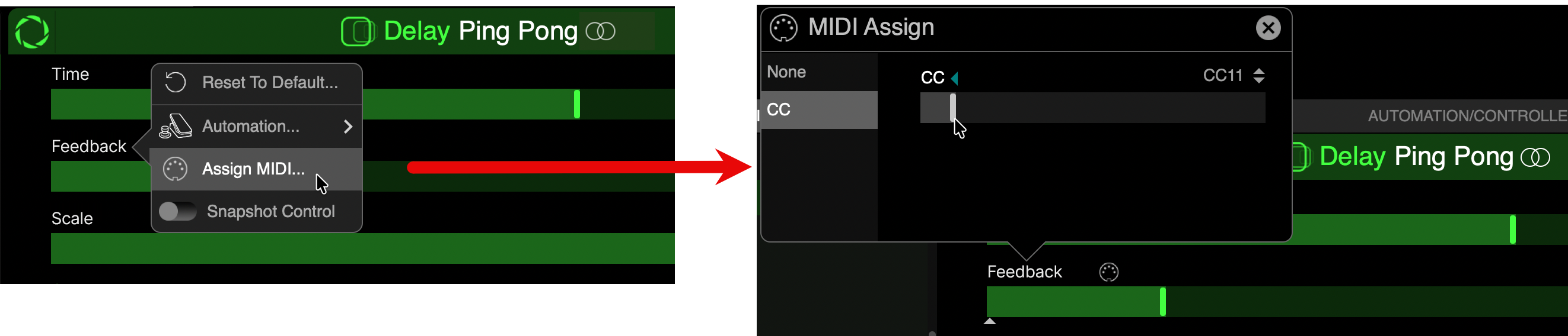

  1. To create a MIDI assignment for a block’s parameter: Select the block in the Signal Flow to display its parameters in the Edit Panel, right-click on the desired parameter knob, slider, or switch, then choose the desired CC number, as shown below.
Creating a MIDI assignment for a Delay’s Feedback parameter
