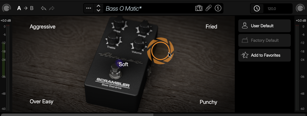

The Focus View - Distortion model selected
