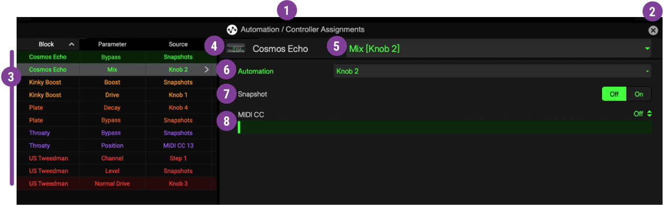

The Automation/Controller Panel
  1. Automation/Controller Panel Title: This title is displayed when the panel is enabled via the toolbar button Automation button.png .
  2. Panel Close: Click to close the Automation/Controller Panel, returning to the Edit Panel display.
  3. Assignment List: The left pane displays all existing parameter automation, MIDI, and snapshot control assignments for the current preset, listing the parent Block, the assigned Parameter, and the controller Source (Knob, Switch, Step, Snapshot, or MIDI CC types). When you select an assignment in this list, its editable settings appear in the Inspector pane to the right.
  4. Inspector Pane: Displays the settings for the currently selected block or the currently selected assignment in the list at the left.
  5. Selected Block Indicator: Displays the icon and name of the currently selected block (or the parent block of the currently selected assignment in the list at the left).
  6. Target Parameter Menu: Select the desired parameter for creating an assignment or for editing the parameter’s existing assignment settings.
  7. Automation Source Controller Menu: Select the source controller for the selected parameter’s assignment. Depending on the parameter type selected, the option in this menu will include Knob, Switch, or Step-type controllers. Please see the following Automation Assignment section for details.
  8. Snapshot Control On/Off: Select On to enable Snapshot Control for the selected parameter.
  9. MIDI CC Assignment: Choose the desired CC number to create a MIDI control assignment for the selected parameter. Set to Off for no MIDI control.* See the MIDI Control page for details.

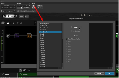

In Pro Tools, it is also necessary to open the plugin window header’s Plugin Automation Enable dialog and manually “Add” each plugin parameter you want to appear in the track’s parameter automation menu, as shown below.
“Adding” the assigned Delay Mix parameter to enable it for automation in Pro Tools

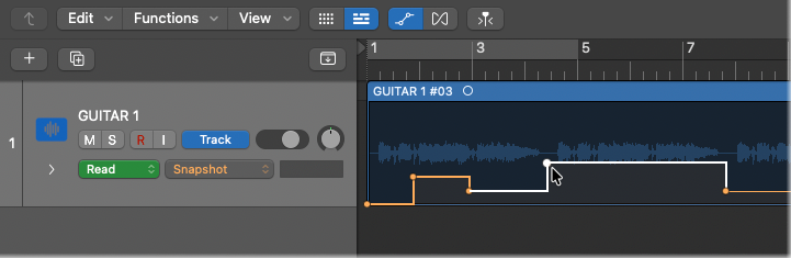

Automating Snapshot Changes
Snapshots allow you to store a number of settings, such as block bypass, parameter values, tempo values, and more, and then recall all snapshot-assigned settings simply by loading the respective snapshot via the plugin’s Snapshot menu. Helix Stadium Native also lets you automate snapshot loading in real-time. Use the following steps to manually configure a snapshot automation assignment.
  1. Access your host DAW app track’s automation parameter menu and select the Helix Stadium Native - Snapshot option. (Unlike block parameters, the Snapshot parameter does not require assignment to a Knob/Switch/Step Source controller.)
Choosing the Snapshot parameter for automation (Logic Pro)
  1. A “Snapshot” automation envelope line is added on the track (your host app may require you to toggle an option to display it). Adding edit points and adjusting this envelope allows you to choose the Snapshot index number you wish to load.
A Snapshot automation envelope is being edited (Logic Pro)
