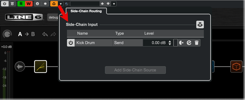

Sidechain routing needs to be configured in your DAW host first. In some DAWs, a Sidechain menu in the plugin window header lets you select another audio track (as in Cubase or Logic Pro, shown below).
Cubase Sidechain Select menu
Cubase: Click the “Activate/Deactivate Side-chaining” button to enable it, then click the “Set Up Side-chain Routing” menu button at its right and select the project’s Sidechain source track or bus.
